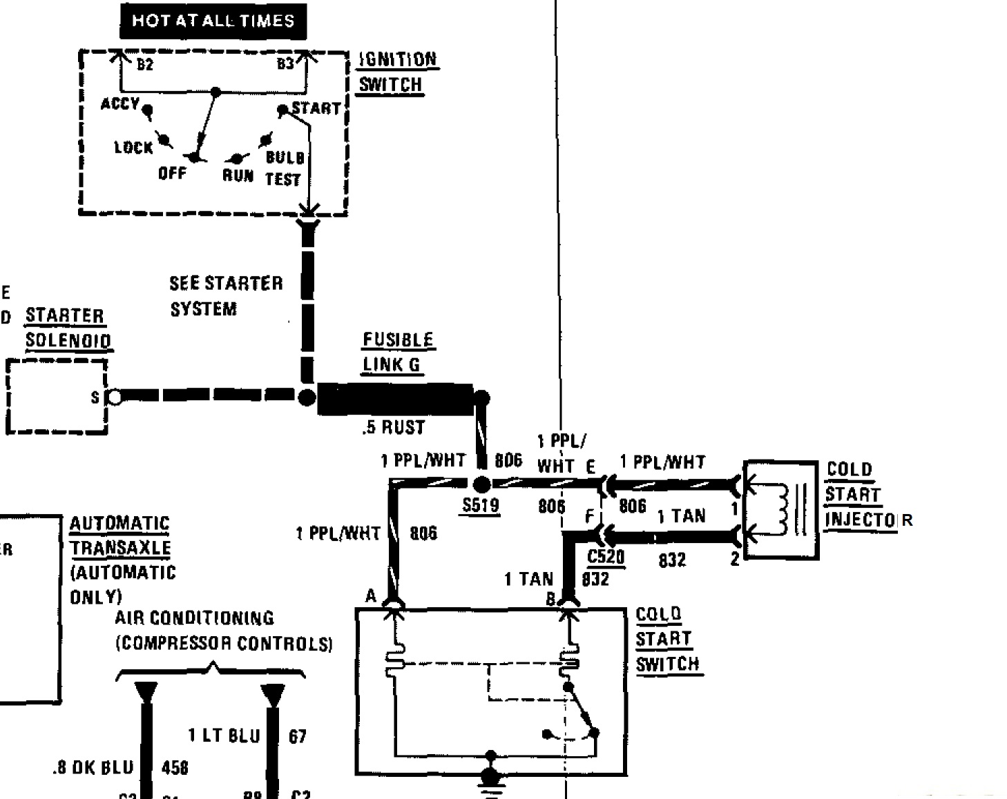

I have replaced the cold start sensor on my 2.8l. Got it from O'Reilly's, made in Taiwan. No wiring docks. If i miss wire it , did i blow it up. Positive / Ground.
How do i check the polarity and if it's still good.

Cold Start Sensor?
See Below:
