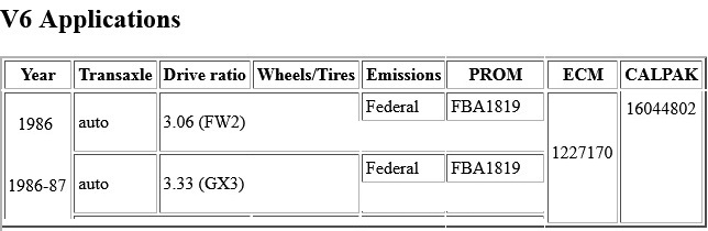

I also need what I think is the ECU or ECM.
The computer isn't a problem; however, the PROM {Programmable Read Only Memory} chip MUST be correct for the vehicle {see the chart in the link}
https://gafieroclub.org/ECMgood/fieroprom.html#V6
the whole ECM is just gone. need a new one

so I looked at the sheet. how do I find the PROM number I need. there is a bunch of them that don't seem to connect to anything
I think it might be FBA1819. but I'm not to sure. I went 86-Auto-Federal and got that number.
[This message has been edited by Carlin (edited 10-17-2025).]

Originally posted by Carlin:
so i looked at the sheet. how do i find the PROM number i need. there is a bunch of them that dont seem to connect to anything
They all connect in horizontal rows, you start from the left, and pick what you have based on the options, then move right in that column to the next set of options, v6 or l4, then is it 84,5,6,7, or 88, then is it an automatic, 4 speed or 5 speed, then what size tires if applicable, then was it sold in California, or everywhere else in the US/Canada. Once you go through that, you'll have 2 numbers, the ECM number (which is the same for 86-8, hence it being less important), and the prom number (the actual chip inside the ECM that has parameters that must match the engine and transmission that you have)
I think i have the prom but how do i find a ecm with that prom. Ive been looking on ebay but everybody only labels the ecm number and not the prom number that is in it.

Some eBay sellers won't say the PROM {you need to ask}
Some sell the computer without the PROM {you need to buy the PROM separate}
Some will show the computer for "Engine/Transaxle"
Some show "Computer 1227170 AKYN" which AKYN is the PROM
GM sells remanufactured computers separate from the PROM
Easy-To-Read Version
btw I have been asking. nobody seems to know what the prom is. I've been telling them its the chip inside. Is there a way to find it without taking it apart since I know a lot of sellers don't want to just start taking things a apart and risk breaking them.

Another Idea:
Remanufactured GM Computer 1227170
https://www.gmpartsgiant.co...m-reman-1227170.html
