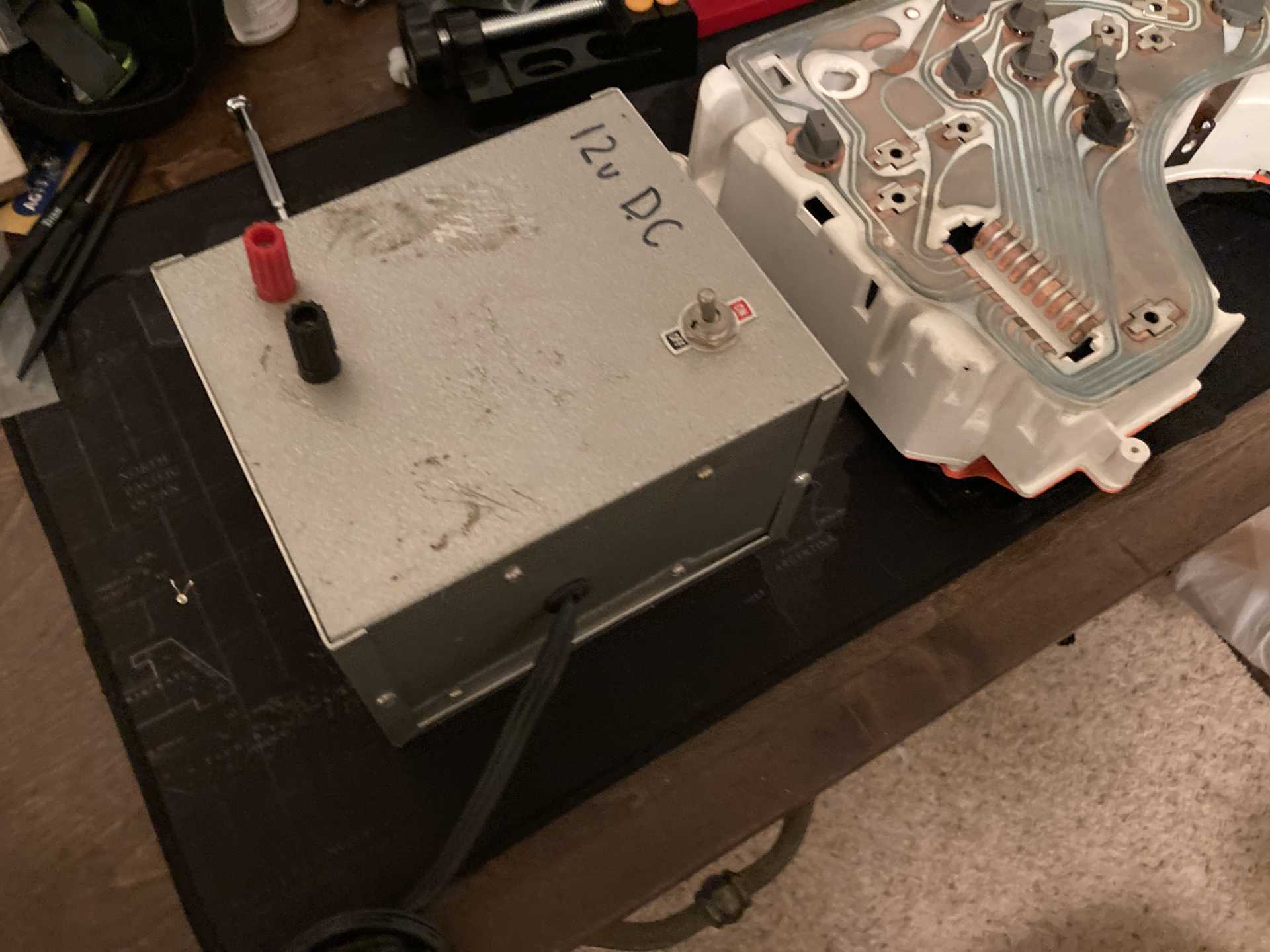

Of course, they only get installed in one direction, so you have to test that before putting everything together, otherwise half the bulbs probably won't work. I have a spare set of gauges with a good printed sheet in the back, and I used this little 12v DC power box that I built with my uncle when I was a little kid. I think it's only 1 amp, but converts 120 AC to 12v DC, and has banana clips on the top so I can attach all kinds of leads to them. It's perfect:

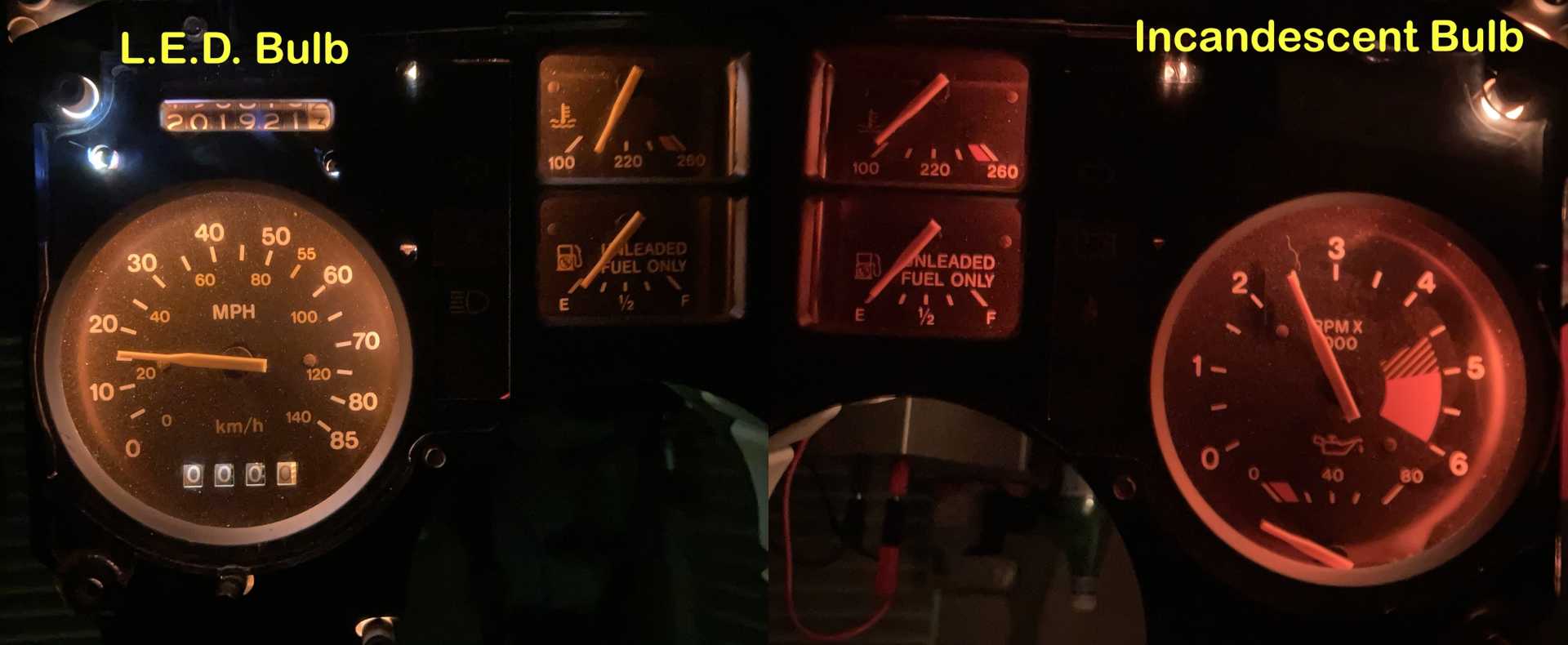

Anyway, he's the comparison... left side is LEDs, right side are original incandescent bulbs:
Now, first thing you'll notice is that the LEDs on the left look more orange, and the ones on the right look more red. This is certainly how it comes out looking in the pictures, but looking at them in the room, the cluster is still very red, they're just so bright that it looks orange on camera. They do sell these in red as well.
The only thing I don't know, is if these are dimmable. I don't really know how to try that since I don't have a spare dimmer... but I'll try to find one and test it out. Otherwise, I really like how bright the bulbs are. One more thing to add... some LED bulbs get really hot, sometimes even more hot than incandescent bulbs, which is weird because it's not supposed to be that way. These bulbs... almost no temperature change. I had one hooked up with gator clips for about 15 minutes, and then grabbed it with my fingers... it felt, MAYBE... MAYBE 5 degrees warmer than ambient room temperature (which is 73 degrees)... so these are awesome.

I read some of the comments, a few people said they could dim them no problem, but a couple of people said you could maybe get a little more than 50% dim, and then they just turn off. So that's something to consider... but I think I'd be OK with that. if I need it dimmer than 50%, then I don't really need the gauge lights on...
