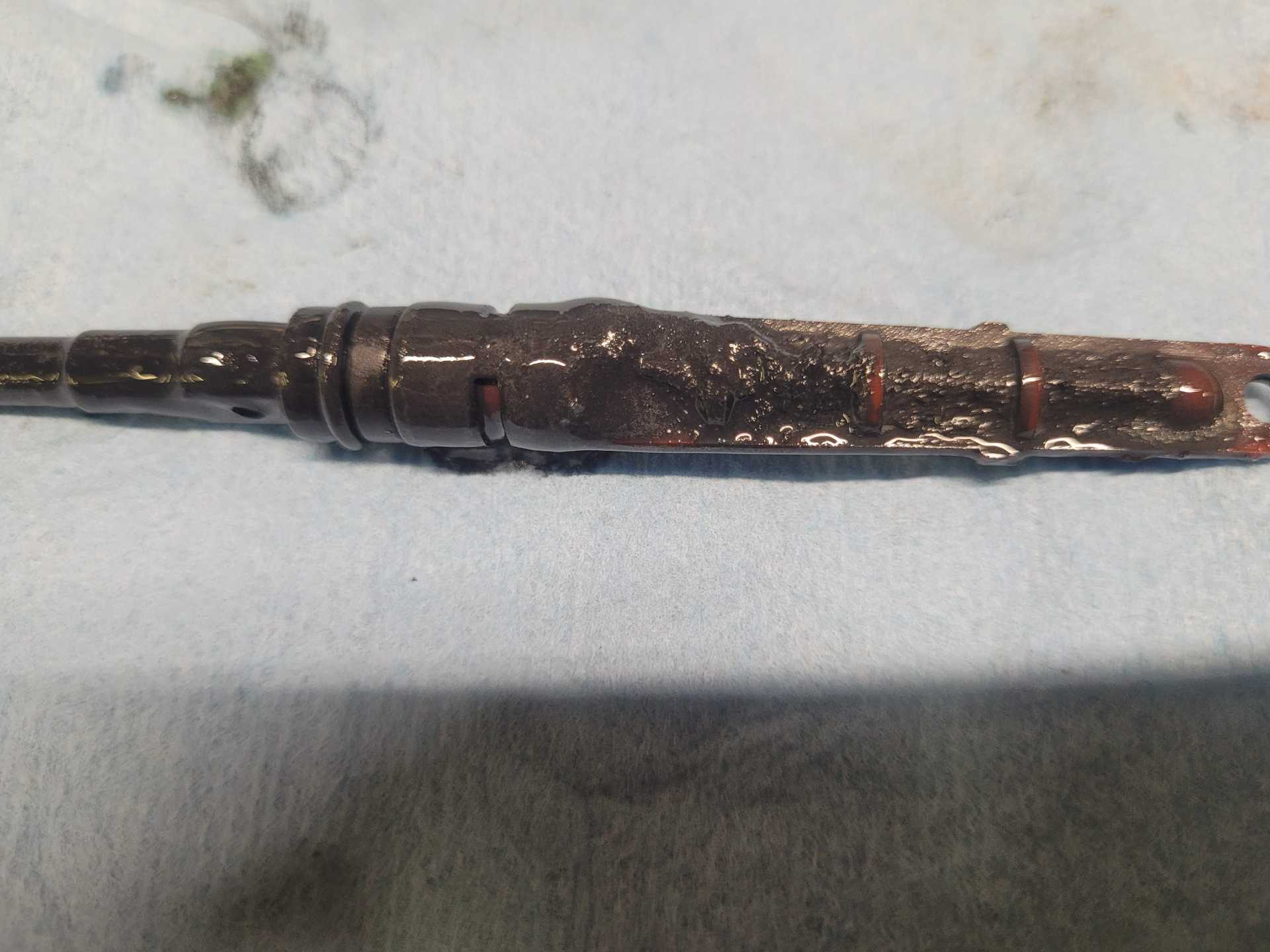

Well Stingray92, you nailed it. I must not have gotten everything flushed out of the condenser coil. As you can see in the picture, it's definitely plugged! I put a new standard orifice in it and replaced the accumulator again. I tested pressure with nitrogen at 120psi for 20 minutes and now I'm pulling a vacuum on it again, and per Brian's advice, I'm going to let the vacuum pump run for far longer than an hour this time. Thank you so much for all the help and I'll let ya'll know how this turns out. Hopefully all the gunk got flushed through and trapped at the orifice and it won't plug this new orifice this time.

Yeah flushing the system with components installed can be difficult. Something I've done is use a white cloth/sock to catch anything after I do the 1st flush.
It might be overkill but contamination is what will kill the system. I also had the luxury of having all the pipes and components out of my car for flushing before I did a final flush.
