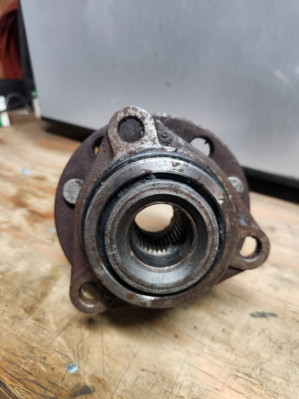

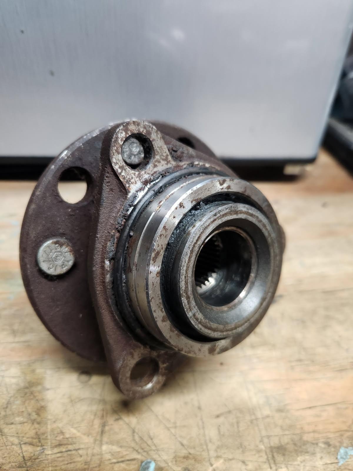

Here's a couple photos of a 2000 ish hub pulled from mine.
As you can see no rear seal.

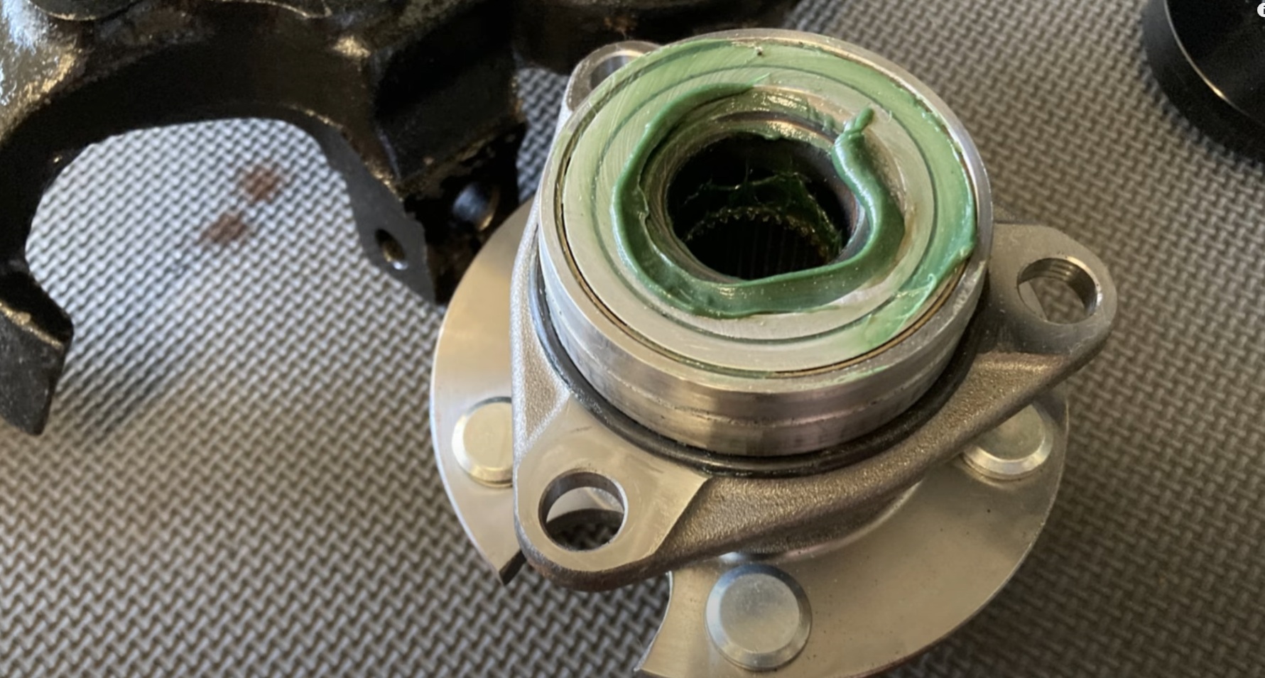

A newer style example.

Report this Post09-17-2025 01:06 PM Click Here to See the Profile for 82-T/A [At Work]Send a Private Message to 82-T/A [At Work]Edit/Delete MessageReply w/QuoteDirect Link to This Post
Yeah, the one my daughter installed... it didn't come with any of the seals because like your new one, it's a sealed bearing unit too. We still bought the seal and such, even though it wasn't required... I figured keeping water out would still prolong the life of it. I had her cover it in bearing grease so that when installed, it would help coat the inside... just to be on the safe side.
