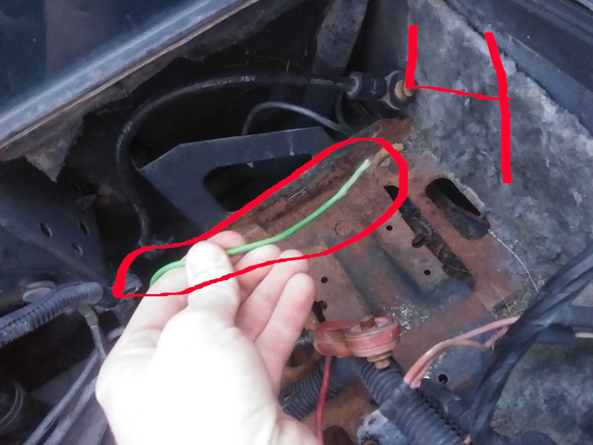

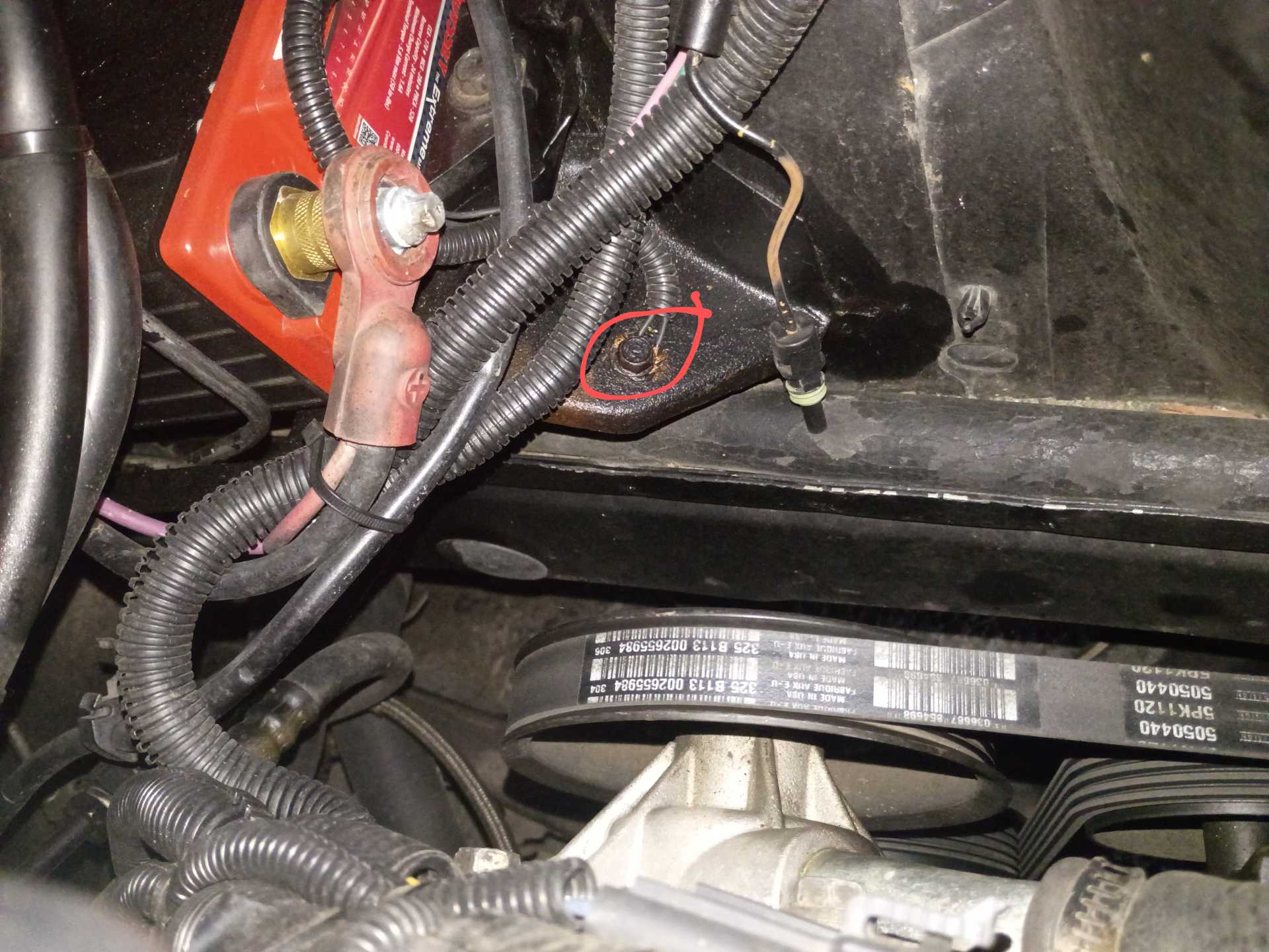

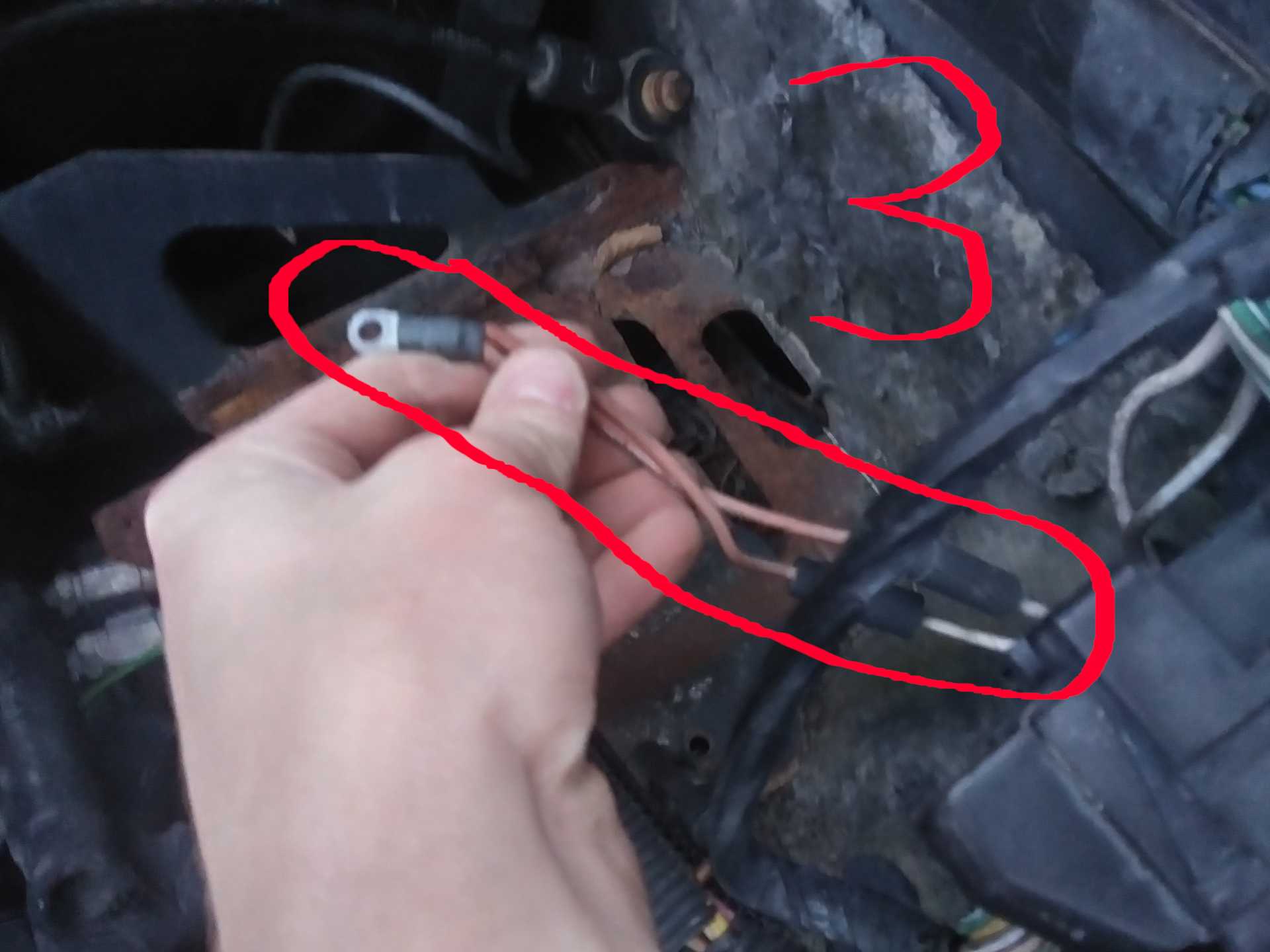

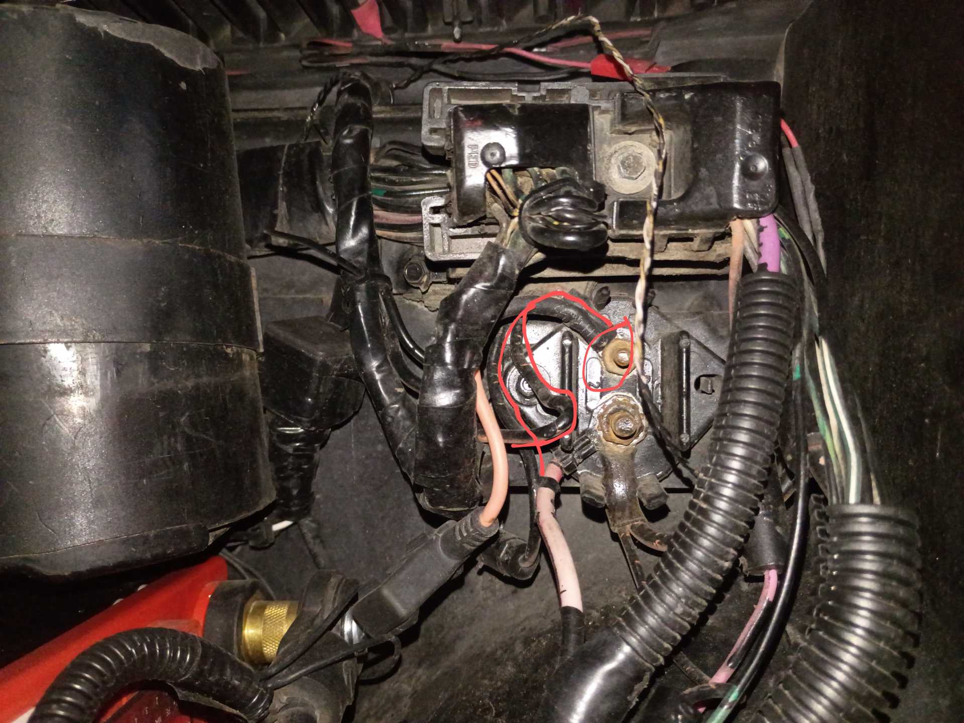

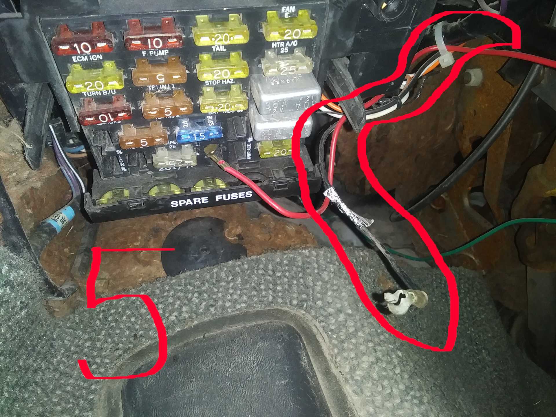

Hello, so I got my positive/negative battery cables cooked up, along with my ground strap. There is still no power though. I know why but need help. I have 5 photos. Each photo is a wire I found that isn't hooked up. 1-4 are in the engine bay. 5 is under the steering Colum. I have a number on each photo so you can help me with the wiring. I need to know what the wire is for and where it connects to. Any help is appreciated. Btw please have a photo showing where the wire goes because it makes it a lot easier for me to understand.
go down for photo 1. it wouldn't load on this post.

here's photo 1. for some reason it wouldn't load in on the first post
1985 Fiero GT
Posts: 1152
From: New Brunswick, Canada
Registered: May 2023
Report this Post09-05-2025 09:02 AM Click Here to See the Profile for 1985 Fiero GTSend a Private Message to 1985 Fiero GTEdit/Delete MessageReply w/QuoteDirect Link to This Post
#1, circled, self tapping bolt into the sheet metal below the battery. My battery is not stock so it won't look the same, the location and be adjacent to the water pump pulley as pictured

Report this Post09-05-2025 09:06 AM Click Here to See the Profile for 1985 Fiero GTSend a Private Message to 1985 Fiero GTEdit/Delete MessageReply w/QuoteDirect Link to This Post
1985 Fiero GT
1152 posts
Member since May 2023
#2, circled and traced, goes to the "power distribution block"on the bottom stud, along with the cable coming from the alternator. It's on the far passenger side "wall"in the engine compartment, just ahead of the wheel well.

Report this Post09-05-2025 09:09 AM Click Here to See the Profile for 1985 Fiero GTSend a Private Message to 1985 Fiero GTEdit/Delete MessageReply w/QuoteDirect Link to This Post
1985 Fiero GT
1152 posts
#3 I think goes to the top stud of the power distribution block, as outlined and circled

Report this Post09-05-2025 09:11 AM Click Here to See the Profile for 1985 Fiero GTSend a Private Message to 1985 Fiero GTEdit/Delete MessageReply w/QuoteDirect Link to This Post
1985 Fiero GT
1152 posts
4 might be a ground, I don't know though, 5 i have no idea.

Report this Post09-05-2025 09:37 AM Click Here to See the Profile for CarlinSend a Private Message to CarlinEdit/Delete MessageReply w/QuoteDirect Link to This Post
I think 4 is something to do with the key switch. The same green wire is found under the steering Colum in the cab. somebody was messing with it before me cuz a bunch of wires aren't covered under the steering column. Infact you can see the green wire in the 5 photo on the right. if that helps
