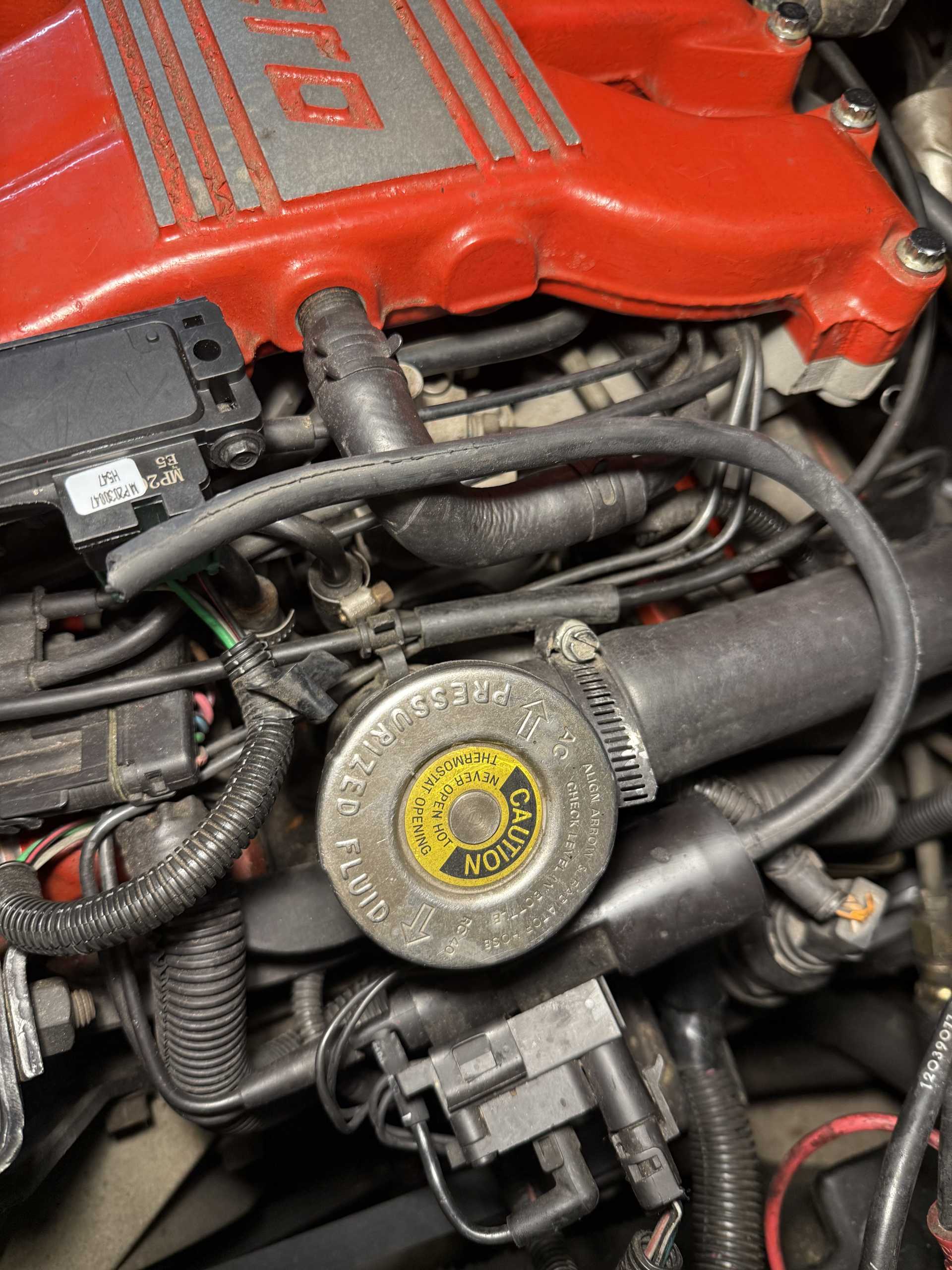

Hello all,
Pictured is a broken vacuum line. It emanates from just above the EGR solenoid. I am not able to locate its connection point. Can anyone tell me or show me a photograph where this vacuum line connects to?
tThank you for your help.

That’s the egr solenoid inlet hose. It goes straight back to the firewall where you will see a hard metal tube / small pipe. This metal tube runs along the firewall and reconnects back to the air cleaner housing.
Kit

Thanks, Kit.
I’ll take another look. When I checked before, I couldn’t find anything at the firewall. but I’ll give it a second look. Thanks again.
I borrowed this image from another thread (after re-orienting it). This is looking up from below. The small tube is immediately below the larger one.

I found the line on the firewall. Thanks for your help guys.
