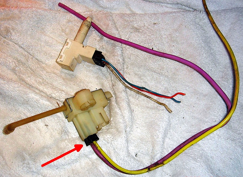

I'm not sure why you're referring to more than one switch. The only switch you're interested in (that Dennis originally brought up) is the switch mounted on your clutch pedal assembly. When that switch is engaged (or jumpered), power should get to the starter solenoid when the key is turned to Start.
I've indicated here the connection that needs to be unplugged and then jumpered for testing purposes. Is this what you've done?

Report this Post09-02-2025 06:38 PM Click Here to See the Profile for GabeBjerkSend a Private Message to GabeBjerkEdit/Delete MessageReply w/QuoteDirect Link to This Post
So turns out im not too bright. Instead of jumping the yellow and purple wires i jumped the other clutch pedal sensor that had yellow and brown wires. Just jumped the correct one and it turned over when hot wired.
