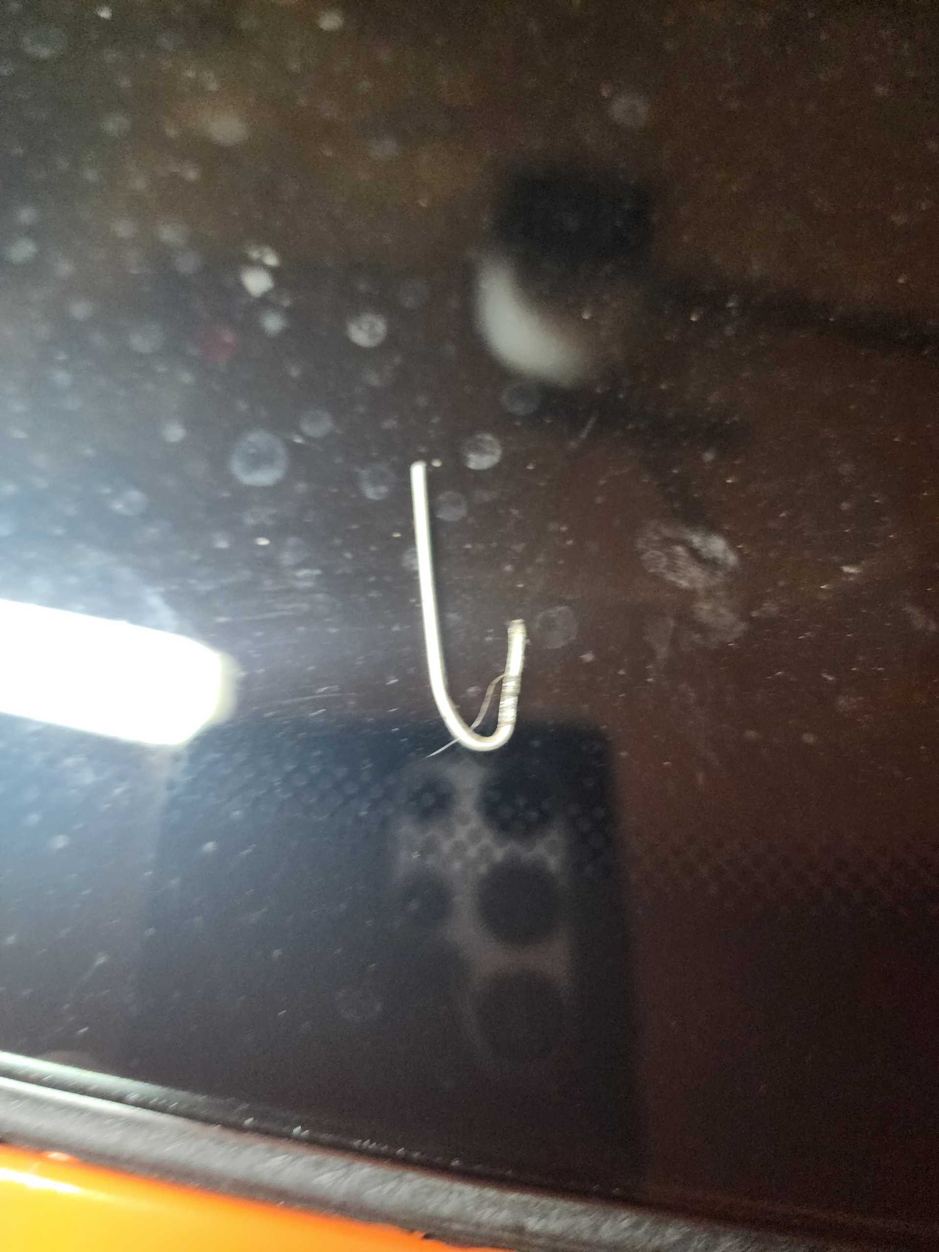

Got the car in the garage, thanks for the tip Patrick. Well the verdict is the banjo came off the post and found what was being used for the pin on the floor. Going to pick up a proper pin in the morning and reattach the banjo. Hopefully that is all it is.

Report this Post08-29-2025 11:48 PM Click Here to See the Profile for PatrickSend a Private Message to PatrickEdit/Delete MessageReply w/QuoteDirect Link to This Post
It's (almost) always the simplest things!
While you're under the dash, check to make sure the clutch master isn't leaking. If it is, you'll notice evidence of fluid in the carpet padding around the area where the banjo comes through the floor.
After it's all together, measure how far the slave is moving when the clutch pedal is put to the floor.
