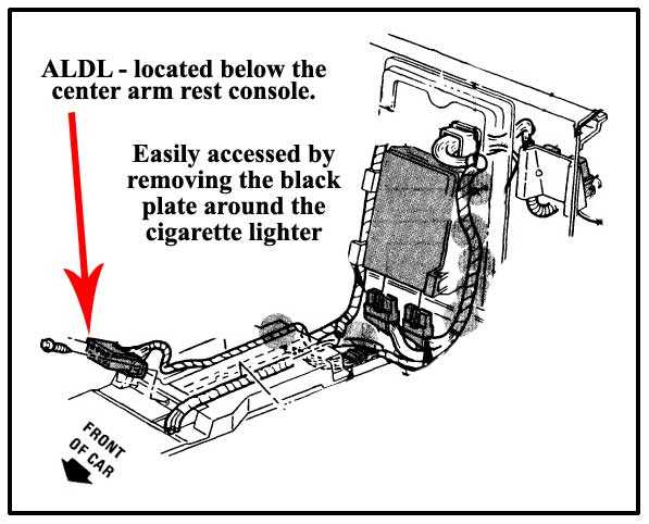

where is the OB socket at, n ot under where liter is under, is it ob1 orob2?

The OBD1 socket is located under the center console cigarette lighter panel, 2 torx screws and it comes off, and it's right under there.

Actual, the name is ALDL Connector...
The Fiero Store Tech Tip ALDL Connector Page
https://www.fierostore.com/.../Default.aspx?Id=347

You probably won't get much info by just trying to read the codes on the ALDL connector. Those codes mostly indicate when a sensor is bad. . You really need live data to see exactly whats going on. The Fiero Store sells a nice scan tool that will give you this information.
