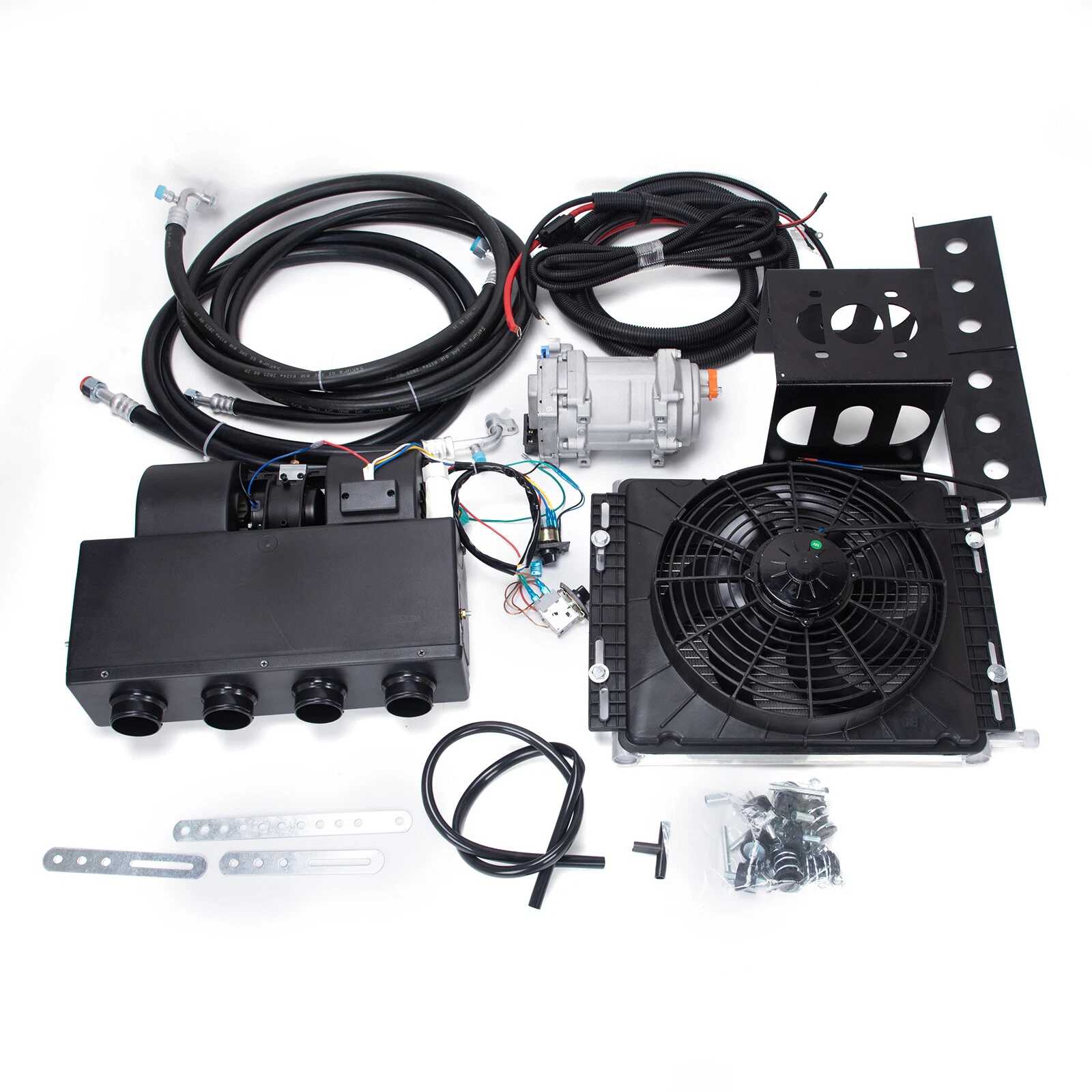

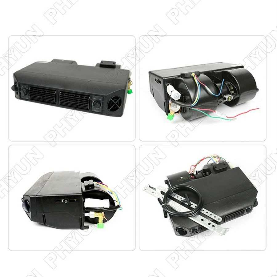

Those 12V A/C vehicle A/C systems are all over eBay for about $425 complete.
I don't know much about A/C. What do those ones have that this $100 unit doesn't have? Seems like an amazing price if it actually works!
This item is just a conventional (not electric) aftermarket A/C evaporator. To get this working you would need to add a half dozen extra parts that includes a compressor., mounting brackets, accumulator, pulleys, hoses, condenser, fan etc.
Ah, I understand. Okay, how about This kit for $395 then? Still a great price for adding A/C... if it works!
That is an electric A/C kit for a car. The EV industry already uses these type of auto A/C units and they work. It would seem that they could be used on a Fiero with a larger alternator. The average rating of these is aound18,000 BTU's and that should be enough to keep a 2 seat vehicle pretty cold.
