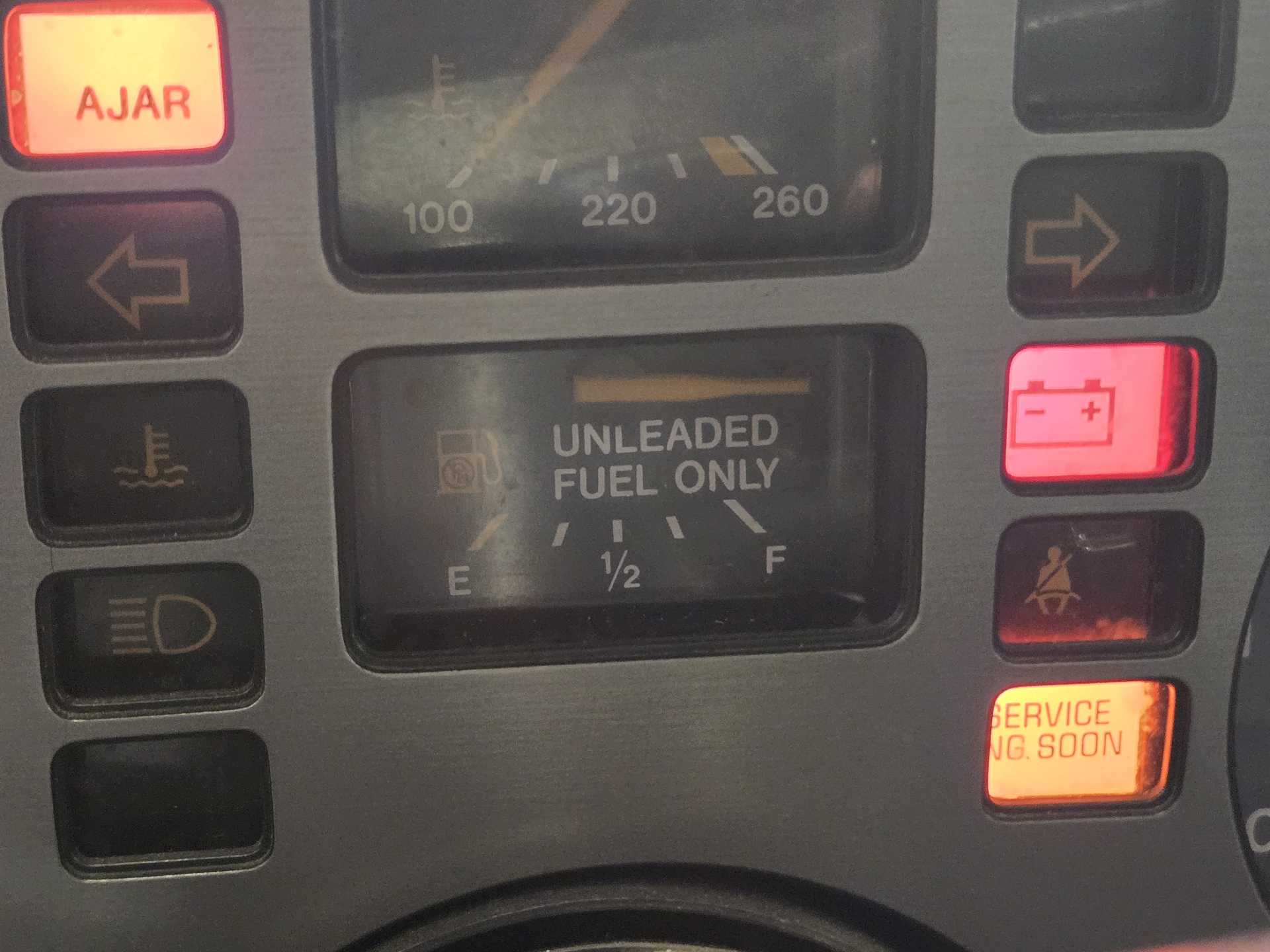

Hey all, so my fuel gauge is currently very screwed up, it sits here:

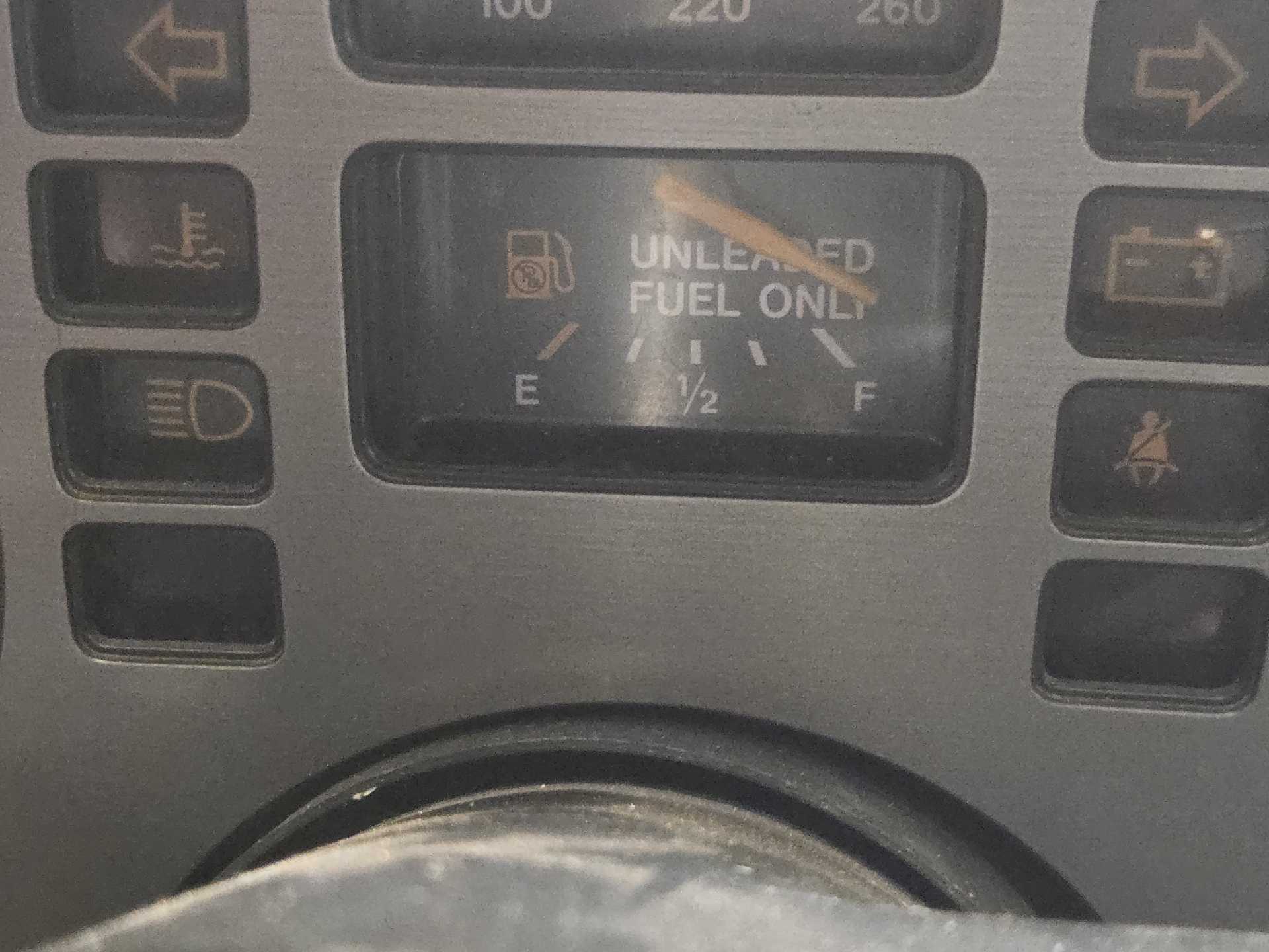

And I measured the resistance between the pink/purple wire and the black on and got 1.365k Ohms (yes I read it correctly, and will happily remeasure and take a picture this time if anyone would like). So then I tried jumpering a couple wires (can't remember the post ATM, if I find it again I'll link it below) that is supposed to make the gauge fall to empty and instead it jumped to here:
So now I'm really stumped, should I just bite the bullet and order a new sender and replace it or is there anything I can test/try first?
P.S. the fuel gauge was working fine till the last time I filled up the tank and that's when it decided to read way over and get stuck, maybe the issue is with the fuel gauge itself and not in the tank?

try using resistors directly on the gauge wires to simulate a empty tank and if that doesnt work then the gauge might be bad

then it looks like a 90 ohm resistor +/-10 percent should be perfect for seeing if the gauge is correct. if it isnt theres ways to correct it

that would mean its completely empty plus some. so yeah its probably broken which on a gm product isnt unusual
edit:brain dumb. thats hilariously out of spec. you sure you haven't hooked the fuel sending wires to a cup of salt water? joking
