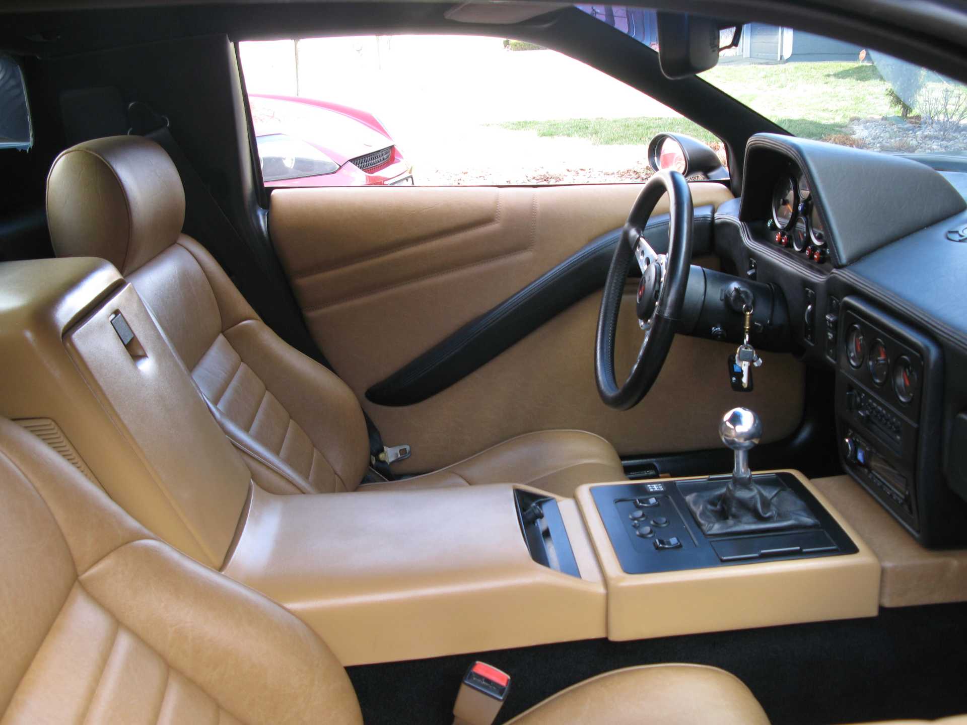

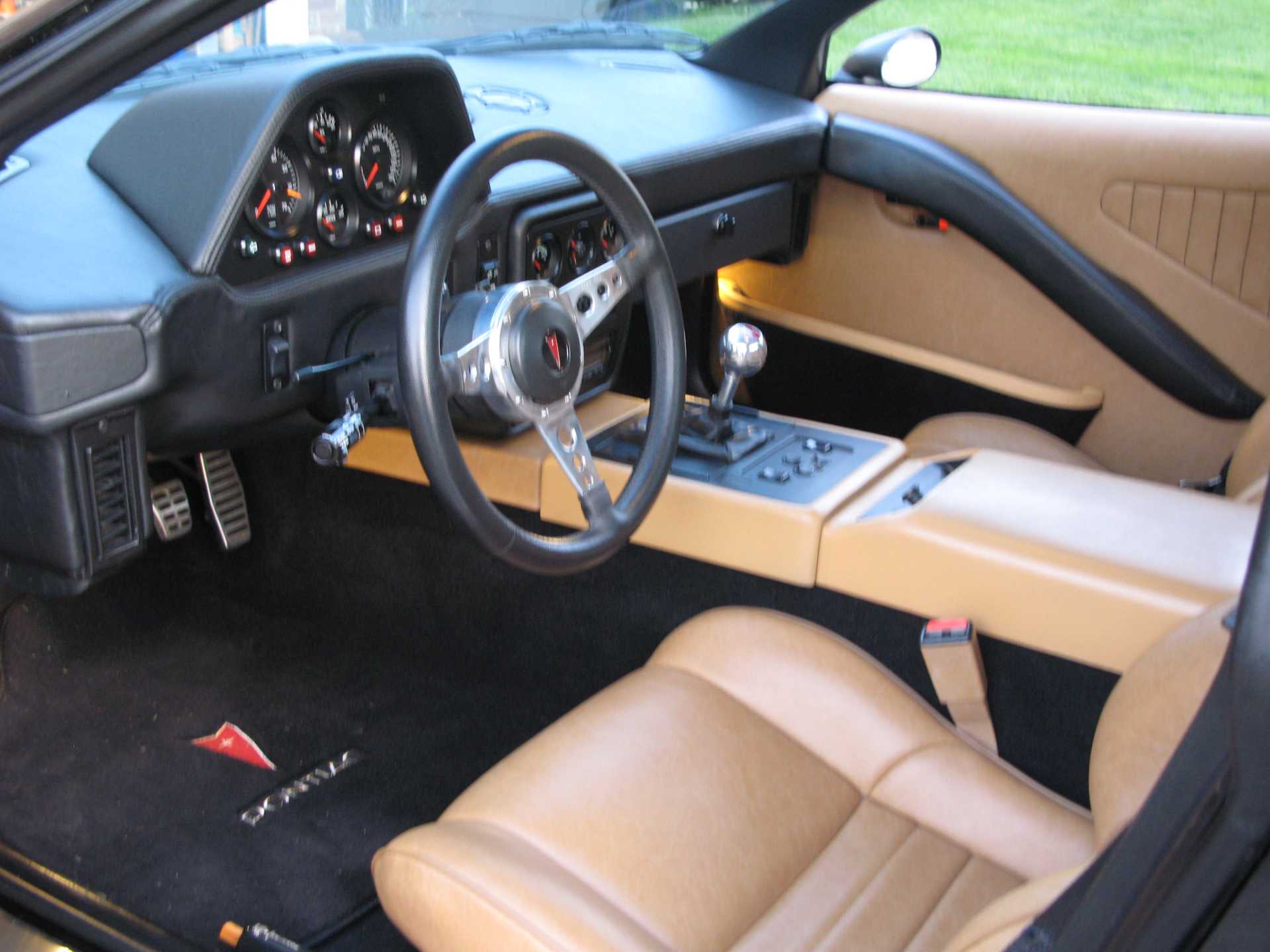

Here's how mine turned out, I spent quite a bit of time getting it ready for upholstery.
Sent you a PM.
