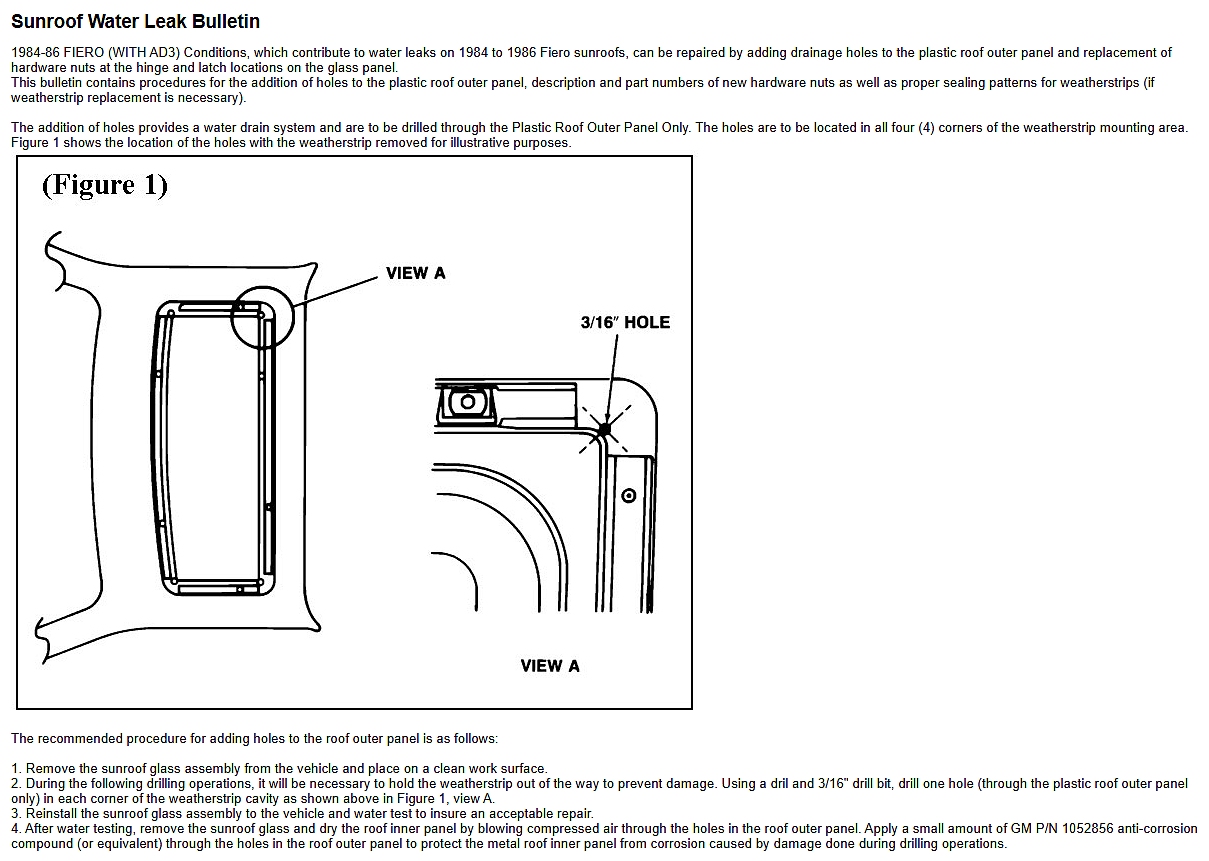

The sunroof shouldn't leak water into the cab even if it's open. (I drive in the pouring rain with my sunroof always flipped open.) Have you checked to make sure the drain holes in the corners are free of debris?
And if your Fiero doesn't have the drain holes...

I definitely don't have drain holes, is it necessary to drill them, or is there a way I can stop the leaking without putting extra holes in my car?

Patrick... I noticed your image says "for 1984-1986 Fieros" ... was there a change from 86-87 so that 87 and 88 Fieros don't have a similar issue?
I don't know off-hand if those years mentioned are necessarily correct, but yes, there was a change where eventually the drain holes were made in the plastic roof panels at the factory.
Why would you not wish to properly fix the problem? This is how the later year Fieros with sunroofs all came from the factory. I did this simple modification to my '84... works great. My '88 Formula came with the drain holes, so nothing needed to be done.
I've had four Fieros with sunroofs. None of them have leaked water into the cab... and I live in a rainforest!
