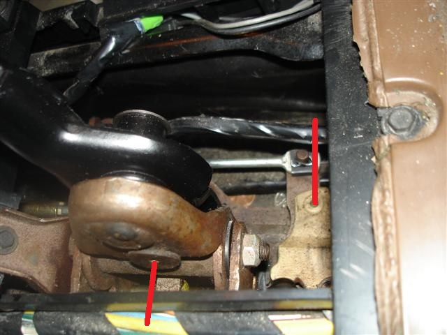

I'm attempting to adjust my getrag shift cable, but I'm not seeing were to pin the shifter while in third gear. Does anyone have a picture showing the location on the shifter. Thanks

Report this Post06-16-2025 10:45 AM Click Here to See the Profile for fierosoundClick Here to visit fierosound's HomePageSend a Private Message to fierosoundEdit/Delete MessageReply w/QuoteDirect Link to This Post

Thanks Fierosound!!!

What is the diameter of the alignment pins?

Haynes manual says 5/32 inch (No. 22) drill bits can be used as alignment pins.
