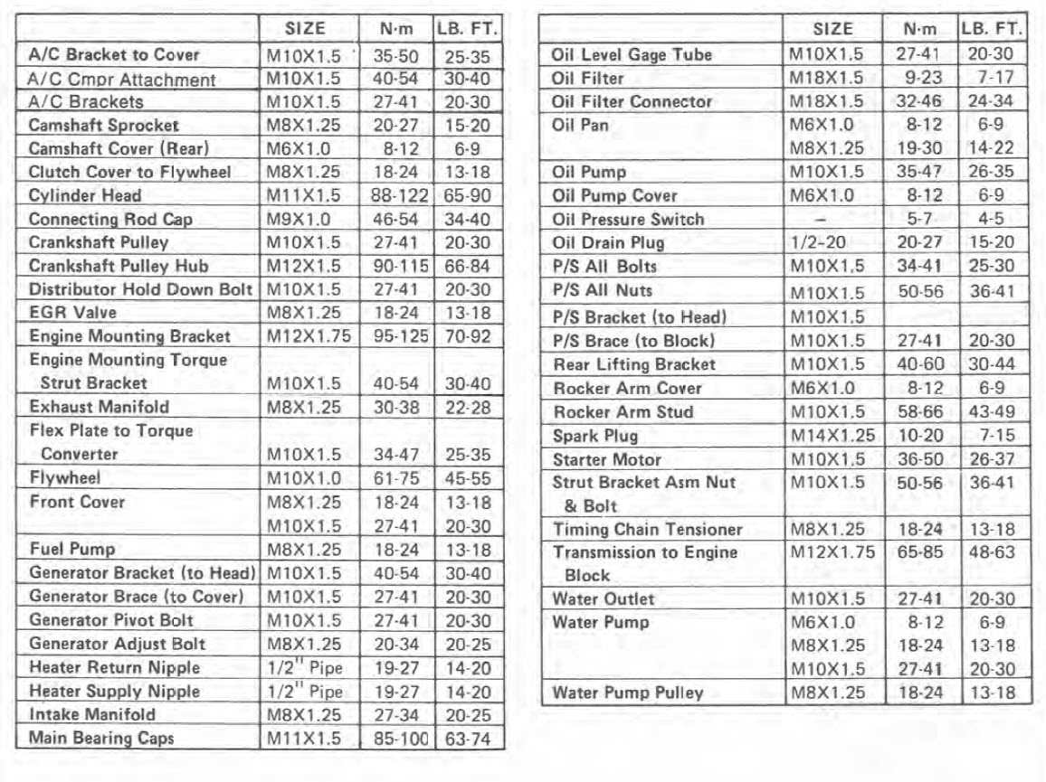

Hi can someone tell me the torque specs for the crankshaft housing
1986 Fiero 2.8l v6

I have no idea what you're asking for (main bearing caps?) but here is a torque list for engine components:

Sorry I wasn’t sure what to call them but yeah I meant the main bearing caps
