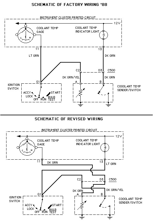

Hello, I'm doing several projects to my car and while I have the dash apart and center console apart, I decided to work on the temp gauge fix. I swapped the wire from 11 and 13, which were light and dark green, and nothing happens when I turn the car to run or on besides the speedometer. No lights turn on, tach does nothing. I disconnected and reconnected the plugs. Does anyone have any suggestions?

at the sensor on the engine ground one wire at a time with the key on. the gauge should pin to full scale with the gauge wire and the idiot light should come on with the other wire grounded. If this is not the case then you have some other issue.

Report this Post06-03-2025 01:18 PM Click Here to See the Profile for olejoedadSend a Private Message to olejoedadEdit/Delete MessageReply w/QuoteDirect Link to This Post
This is by far the easiest way to fix the wiring issue......change the wiring at the dashboard and leave the rest of the car alone!
Somebody was asleep in the Electrical Design Department at Pontiac when they missed this boo-boo!

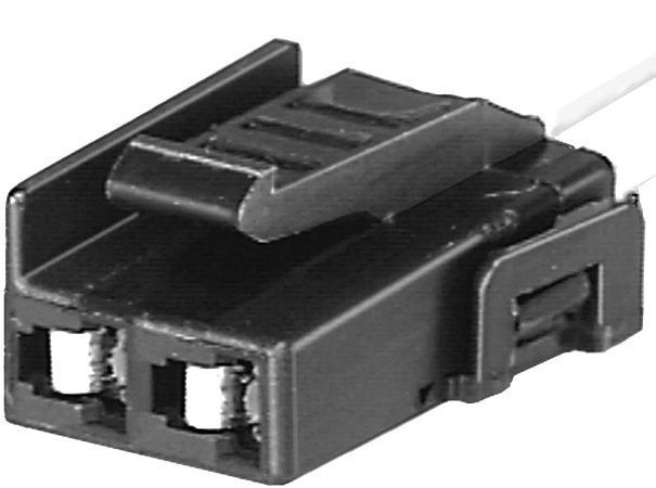

Report this Post06-03-2025 04:54 PM Click Here to See the Profile for Vintage-NutSend a Private Message to Vintage-NutEdit/Delete MessageReply w/QuoteDirect Link to This Post
ACDelco / GM PT110 Connector w/ 2-Wire Pigtail for the coolant sensor/switch
{I paid $17 back in 2023}
