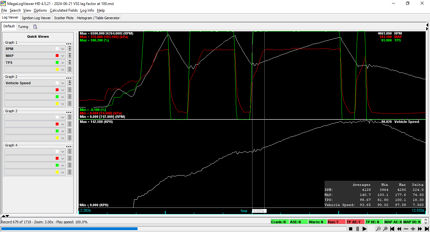

I don't have much driving time in turbo cars; the most turbo experience is with my Fiero.
Here is an example of a WOT 2->3 shift in my Fiero. Going from 100 kPa to 180 kPa MAP takes ~0.5 seconds after the shift.
Accelerating in straight lines with high traction the lag is fine, but in corners I do not have much confidence in the car. It is hard to modulate the throttle pedal and have the engine react now, linearly. Maybe more seat time would help things (my car spends too much time down for service).
Anyway, the lag reduces confidence, yet increases scariness and excitement at the same time. Whether this is a plus or a minus, I am not sure!
