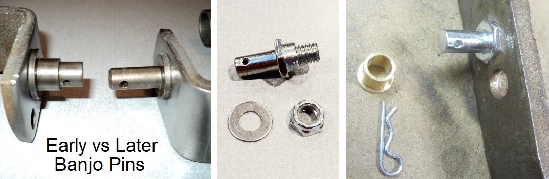

No, this is what I was thinking of:
Clutch pedal pin

No. From the link I posted look at the pictures. The "pin" has a threaded stud that goes through the clutch pedal with a nut to secure it, on the other end, the bushing slides over, the banjo slides over and they are secured by a cotter pin.

Early vs Later Banjo Pins
1985 Fiero GT
Posts: 1025
From: New Brunswick, Canada
Registered: May 2023
Report this Post05-22-2025 09:24 AM Click Here to See the Profile for 1985 Fiero GTSend a Private Message to 1985 Fiero GTEdit/Delete MessageReply w/QuoteDirect Link to This Post
Yes, if cam-a-lot has the early style, then get the pin with the brass bushing, if the late style, just get the pin.

The cotter pin goes through the end of the pin that the banjo slides over, see the pictures vintage nut posted about the Rodney pins, that is how it should look like, banjo slides on pin, cotter pin goes through hole in end of the pin the banjo is on now.
