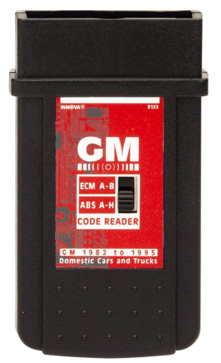

Hello all,
I purchased small ODB1 plug in reader 'INNOVA 3123 GM OBD1 Code Reader ‘ hoping that would trigger the check engine light on the fiero’s dash. Unfortunately , this was not the case. I don’t think Check Engine Light is wired into the VETT ECM.
Is there a way to wire a light to the factor VETT ECM?

Report this Post05-22-2025 09:03 PM Click Here to See the Profile for str8maxnSend a Private Message to str8maxnEdit/Delete MessageReply w/QuoteDirect Link to This Post
The INNOVA 3123 GM OBD1 Code Reader doesn't have a screen nor light on it that blinks out the codes. I was hoping it did.
I think all this does is act as a jumper.
Posts: 38478
Total ratings: 465
Report this Post05-22-2025 09:12 PM Click Here to See the Profile for PatrickSend a Private Message to PatrickEdit/Delete MessageReply w/QuoteDirect Link to This Post
Oh, it's just a code "reader". (Despite what you had posted, I was mistakenly thinking scan tool.) Why would you bother to buy a glorified paper clip?
[This message has been edited by Patrick (edited 05-22-2025).]

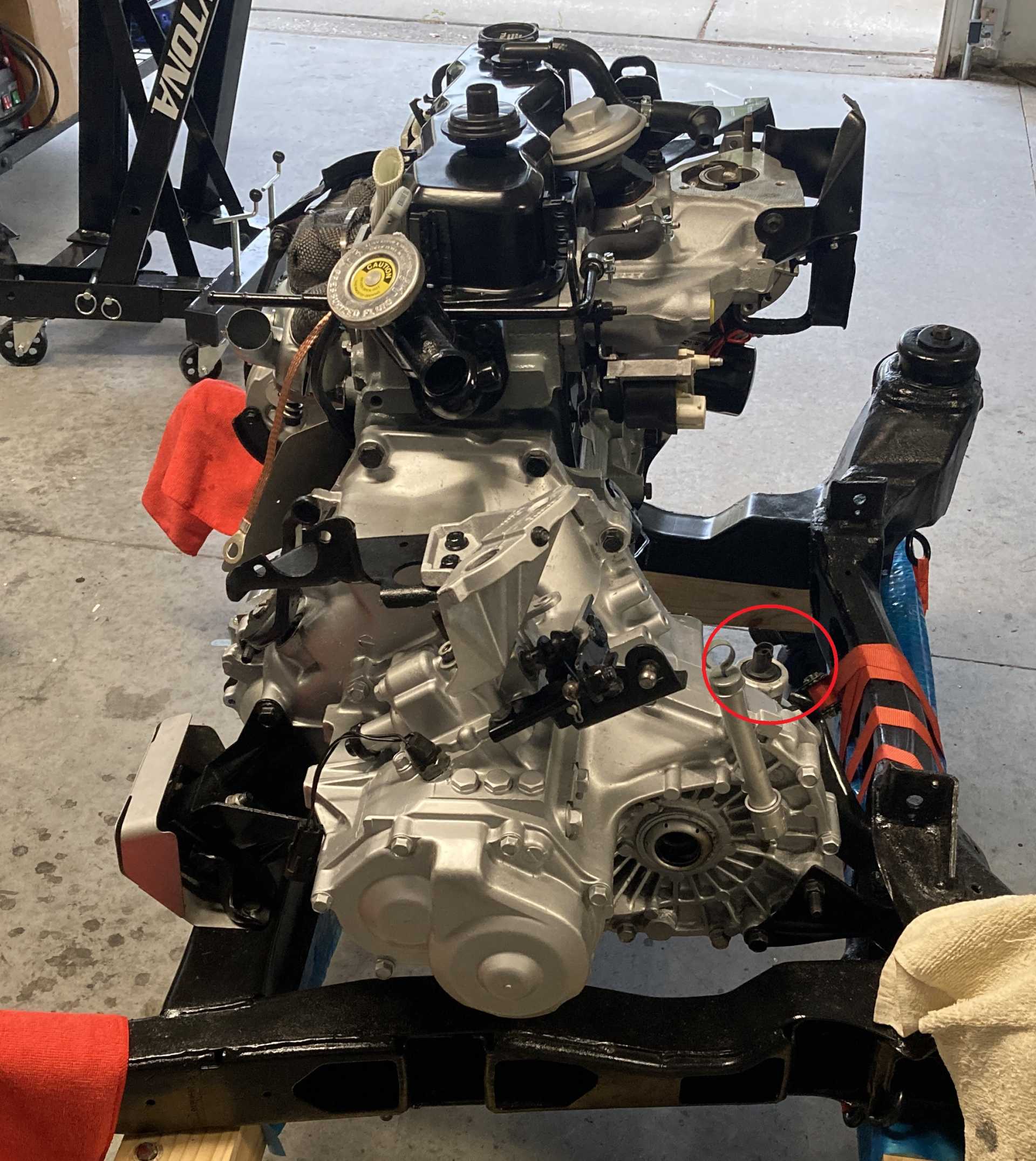

I have a manual trans 4 speed in it . Where would the VSS most likely be located on a 4 speed?
Posts: 25076
From: Florida USA
Total ratings: 201
Report this Post05-23-2025 11:19 AM Click Here to See the Profile for 82-T/A [At Work]Send a Private Message to 82-T/A [At Work]Edit/Delete MessageReply w/QuoteDirect Link to This Post
Code 24 means the VSS is disconnected, or failed. THis is definitely important for making sure that it's operating properly at the correct speeds and loads. I can't tell you where the VSS "connector" would be located since it's an LT1 from a Corvette... but if you have a manual transmission, it should be the ONLY thing that plugs into it, other than the reverse connector.
The standard Fiero Muncie 4-Speed?
It would be this sensor:
Keep in mind, this is a 5-Speed Isuzu, and an Iron Duke... but the VSS (circled) is a two-pronged connector that's located in basically the same place on the 4-Speed... it essentially tells the ECM what the speed of the car is, based on a combination of factors and measuring it at the transmission. Does your speedometer work?
EDIT: Also... that other connector in the middle that's hanging off to the left, that's your "reverse switch" to turn on the reverse lights. You should have one of those too... though that has nothing to do with the ECM and merely connects into the relay that controls the reverse lights. But with your 4 speed, those are the only two things you should see.
Also... if you remove the sensor... be very careful that the gear does not fall off into the car. I've never seen this happen personally, but I've heard that it does, and then you have to fish it out of there, or hope the transmission gears grind it up and it goes away... haha. But they are basically unobtainium.
