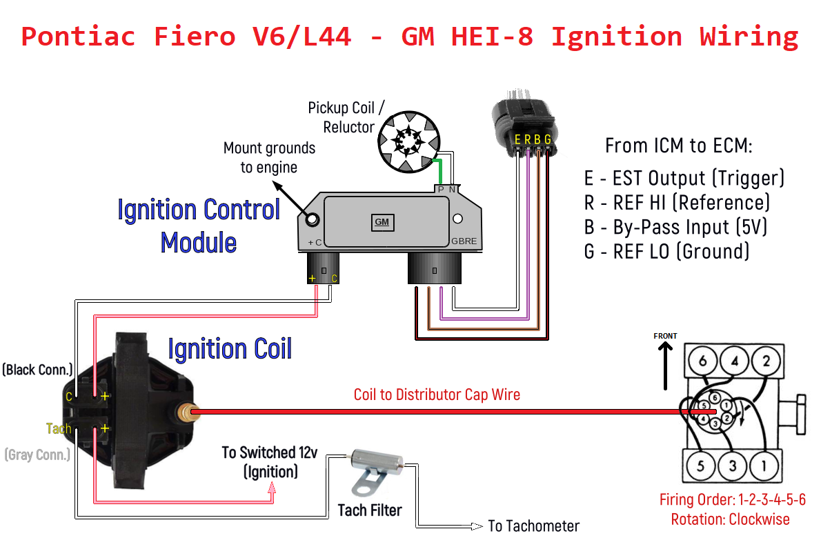

Posts: 25076
From: Florida USA
Total ratings: 201
Report this Post05-19-2025 06:34 AM Click Here to See the Profile for 82-T/A [At Work]Send a Private Message to 82-T/A [At Work]Edit/Delete MessageReply w/QuoteDirect Link to This Post
Like Brian A mentioned above, there are a few different devices that allow you to control a shift light. Most of them require some kind of timing box, like an MSD 6EFI (which would be a really nice and simple upgrade on a V6 anyway). You would get multiple spark discharge throughout the RPM which improves drivability, engine performance (mostly at mid to upper rpms) and improved fuel economy.
In any case, you can take the 6EFI's square wave (digital) tach output, and use it to directly control the shift light with a programmable shift light controller. That way, you can kind of use it for something more performance oriented, like... reminding you to shift so you don't blow your motor or something like that.
But to be honest... the only people who really use shift lights are drag racers and track racers... and that's because there's so much damned noise in the car, and so much vibration, that they can hardly see what the RPM is and they need a shift light to literally tell them when to shift. In a normal street car, you're going to hear your motor and feel the car at a much more controlled level... so you're going to be looking at your tach (and / or understand / feel it anyway) so you don't really need a shift light for performance driving.
But I get it... it's cool, and I'd want to use the shift light too if I had one in a car... or even the provision for one.
Here's a diagram I made for a Fiero's 6cyl stock ignition, you'll need this if you decide to wire up a 6EFI MSD box, or anything like that... this is what it looks like stock:
[This message has been edited by 82-T/A [At Work] (edited 05-19-2025).]
