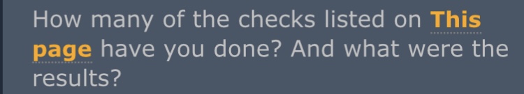

How many of the checks listed on This page have you done? And what were the results?
