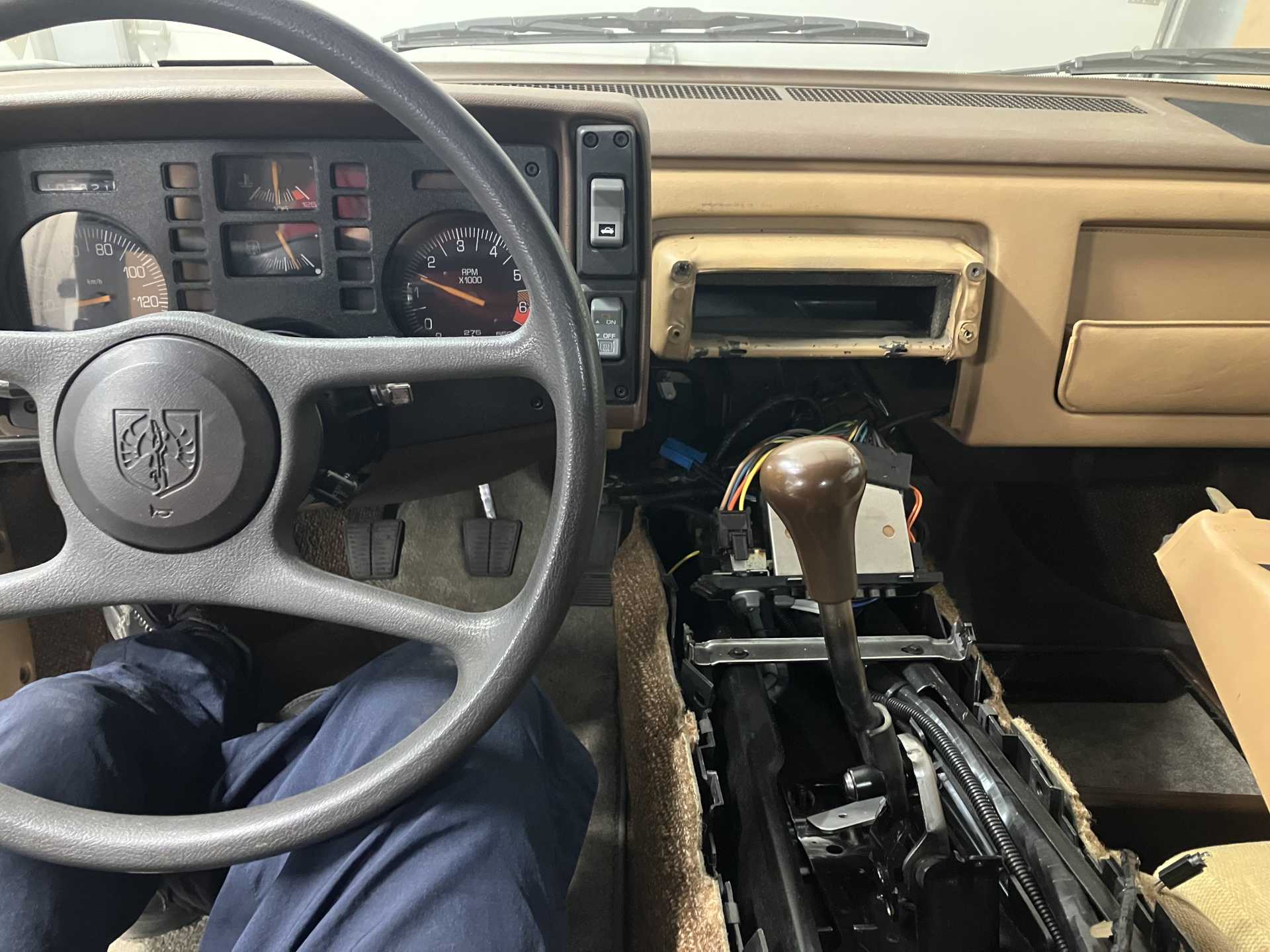

It is just me, or is the knob really close to the steering wheel when the shift knob is all the way to the left in Reverse? I'm talking about with a longer 85/86 shift lever, not the shorter 84 shift lever.
Does the knob get in the way of working the steering wheel? Maybe this isn't much of an issue because Reverse is rarely used.
I'm thinking of using the Muncie's shifter for my F23 install... but in this case, 1st/2nd all the way to the left will be frequently used, and I don't want the knob getting in the way of the steering.

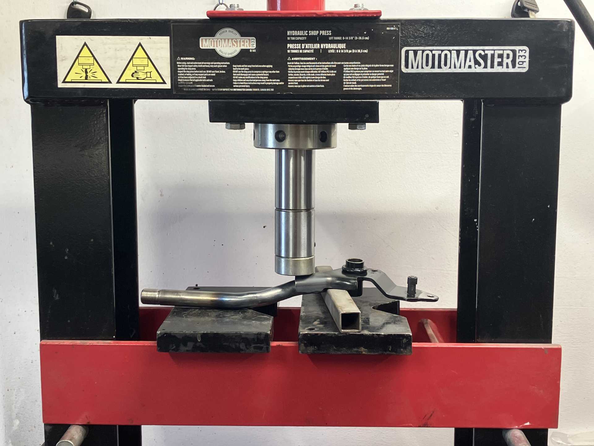

I did this exercise with just the travel limits of the cabin shifter alone.
I’m setting up the linkages to use a fair amount, but not all of the travel available from the cabin shifter.
I had a spare 5-speed Isuzu shifter assembly on had. It placed the knob 2.5" away from the steering wheel.
I decided to bend my shift lever until I had 3" of clearance between the knob and the steering wheel. Slightly more than stock; it shouldn’t create any problems.
