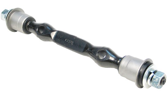

Anyone have any leads on a replacement upper control arm cross shaft for an 88? I'm in the middle of doing ball joints and noticed on the drivers side that the nuts on the end of the cross shaft were loose. Lubed them up with wd40 and gently tried to rotate them back and forth. The rear one behaved and let me tighten it up. Not so lucky on the front one, it broke the cross shaft flush with the end/outer side of the bushing. Can't seem to find any replacements. Checked Rodney's and the fierostore's web sites and they are not listed. There is a guy selling the left front arm on ebay. Probably would come with the shaft.
Anybody have any other leads or suggestions?

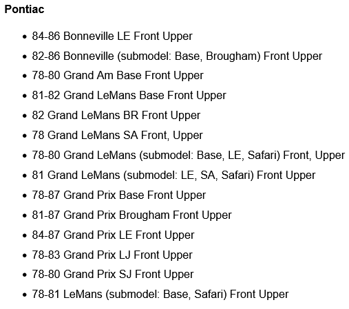

I know zero about 88's but has anyone ever tried to fit a shaft from another vehicle of that era? This one is listed for an S-10 and is $28.
https://shorturl.at/PFUIa
These are the vehicles it fits from Pontiac:
[This message has been edited by IMSA GT (edited 05-04-2025).]
