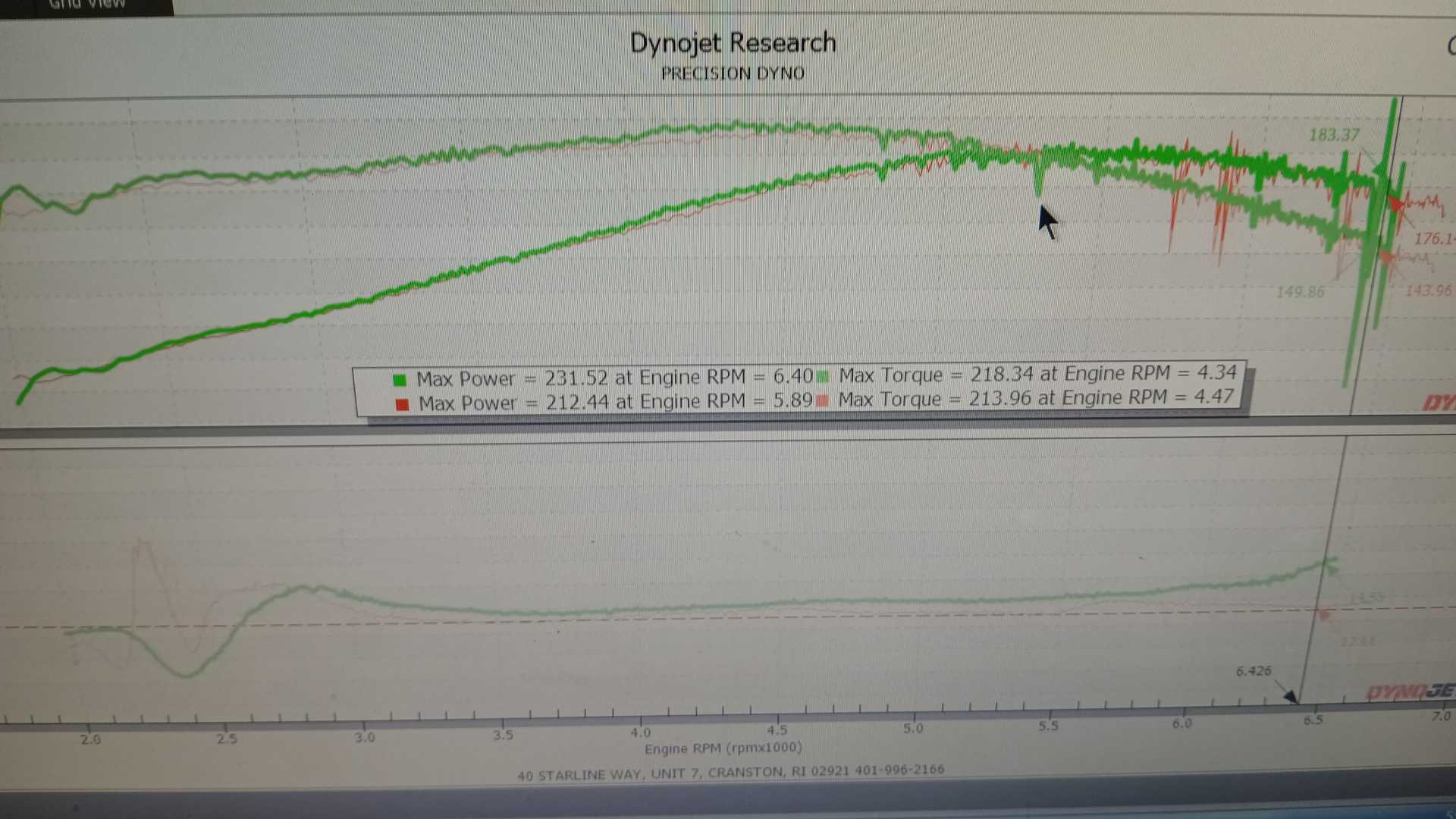

Has anyone else experienced wild MAP sensor readings that seem off at high rpm?
I've done a bunch of dynos and it seems my MAP goes from reading 100 down to the 30's which then causes my fuel to cut down drastically?
I've mitigated the problem by increasing fuel across 4800-6000rpm at low map readings but my fear is that I'm having a valve-sealing issue.
You can see on the green chart I sett the fueling higher at low reading and that smoothened out the power curve but it didn't fully get rid of the issue.
The spike at the end is because I thought the dyno operator was gonna cut off the reading so I fluttered the pedal a bit.

I had faulty MAF and MAP sensors for quite some time until I found out that my alternator was giving out 17V spikes for a few miliseconds from time to time!
When comparing the voltage output, on a rather elongated graph, you could see the MAF readings going haywire at the same time as the alternator voltage spiked.
The MAP just stopped working and needed to be replaced.

Sorry, I thought everyone was fairly familiar with my build. No MAF sensor as this is an iron-head V6 w/7730 and DIS build.
You do bring up a good point. I should check the sealed quality of my hoses and sensors...maybe by forcing smoke thru the TB to see if it leaks out anywhere...
To be safe I ordered a new MAP sensor from the Fiero Store.

And if you can, check the voltage on your logs for spikes or fluctuations.
