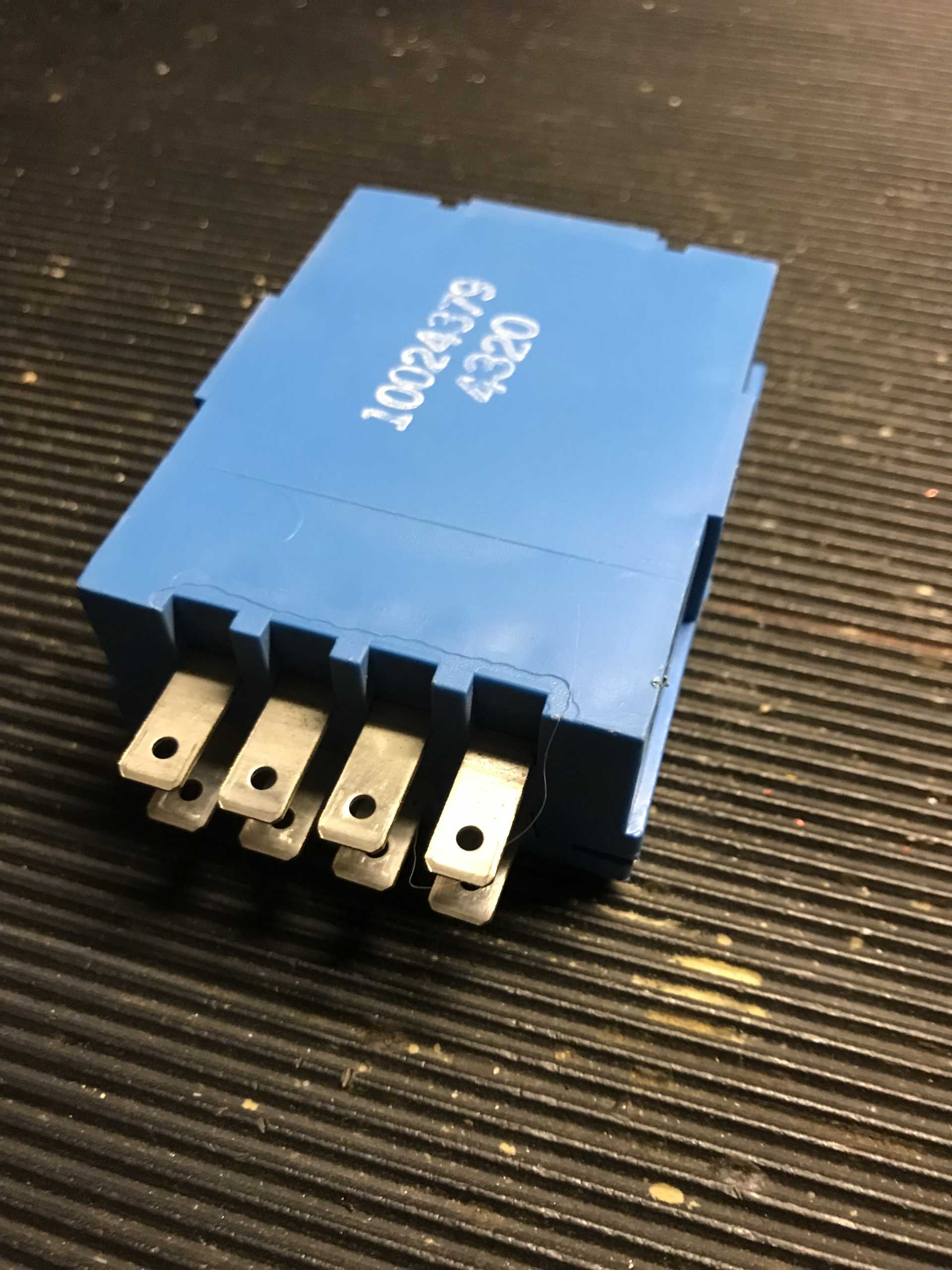

Here’s a pic of what I picked up today.
You’re saying there are early and late squared versions of the 84 blue box? Connectors? You’re referring to the flat blades that stick out the bottom of the blue box? Mine have 8. Or, maybe you’re saying only 7 of the 8 pins are used?

You’re saying there are early and late squared versions of the 84 blue box? Connectors? You’re referring to the flat blades that stuck out the bottom of the blue box? Mine have 8. Or, maybe you’re saying only 7 of the 8 pins are used?

Yes, I'm referring to the flat blades that stuck out the bottom of the blue box...
You have the older rev which was replaced with 10037040 in 1986
