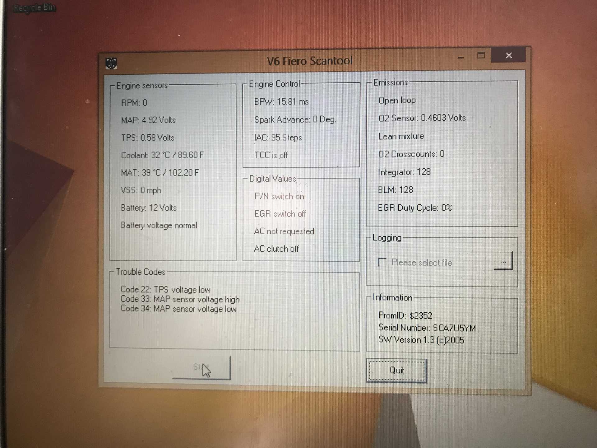

Update: I found out why the MAP Sensor reading was zero. Quite a while back I had replaced the map connector pigtail with a low quality brand that wasn’t molded correctly. The three plastic “cylinders” that house those 3 metal pins were too long in length. Because of this the metal pins were not seated into the map female pins very well, causing the zero volts issue. (I just ordered a GM factory map connector pigtail) In the meantime, I pulled the old connector housing apart and removed the pins and manually inserted them by hand into the bottom of the map female pins one by one. For now it’s working. (until I get the new GM pigtail)
See pic of what the scantool shows now with key on but engine off.
By the way, I still have those 3 stored trouble codes. (see lower left of scantool screenshot)
How do I erase them? Can I simply disconnect the battery for an hour or so and erase them that way? Kit

Report this Post05-10-2025 10:35 AM Click Here to See the Profile for Vintage-NutSend a Private Message to Vintage-NutEdit/Delete MessageReply w/QuoteDirect Link to This Post
Yes

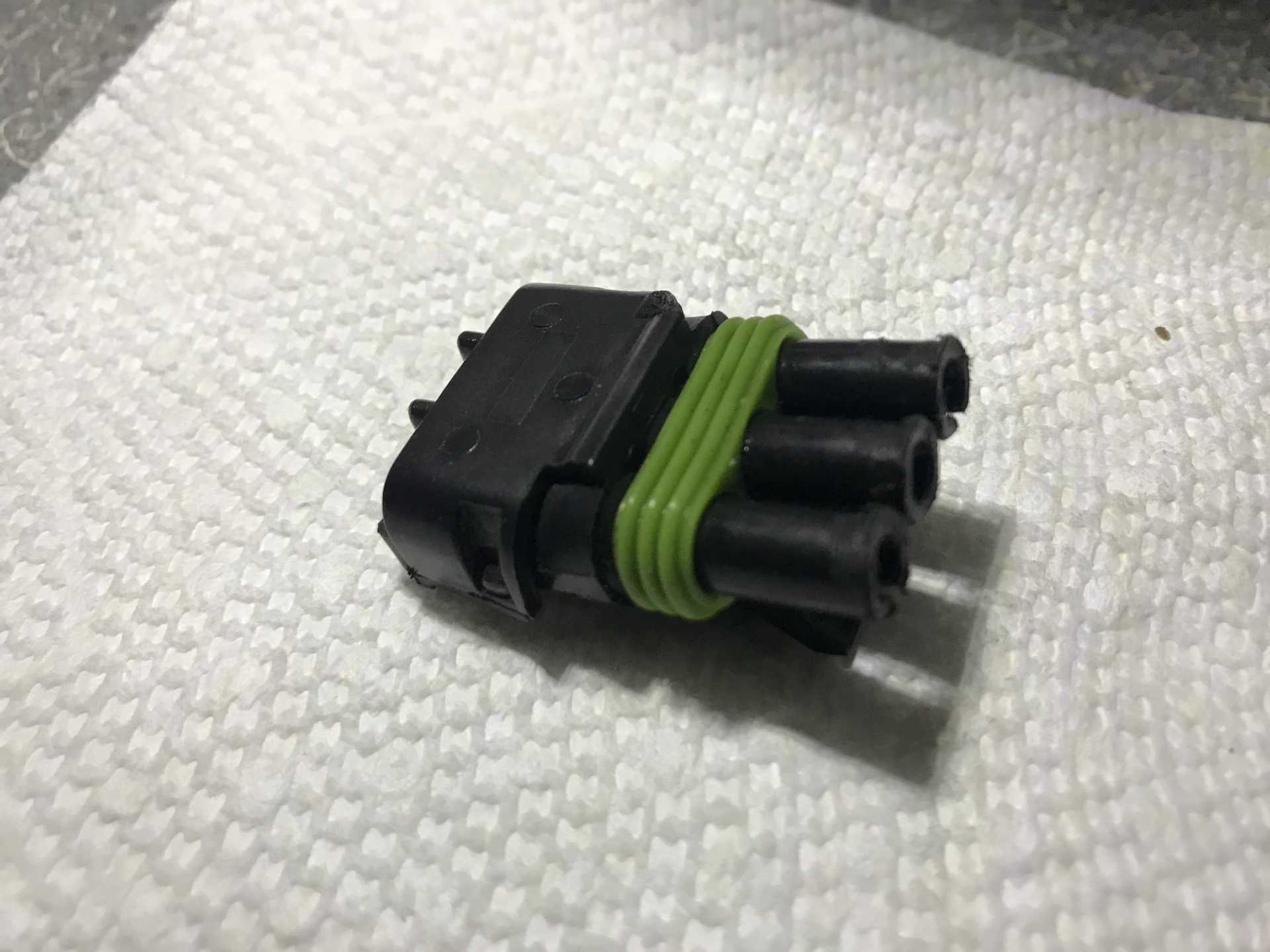

It turns out that a number of years ago I replaced the map sensor pigtail connector because the clip broke on the original one. Well, the replacement I bought was a cheap aftermarket one and believe it or not, the 3 plastic “tubes” (that house the wire pins) were molded a little too long in length, causing the pins to not fully seat into the underside of the map sensor. I tried to grind down the tubes and then re-connecting it but it was still showing zero voltage. So, at this point I took the pins/wires out of the harness and plugged them one by one directly into the map sensor female pins. It’ll work until I get the new GM map connector pigtail.
In the end, I’m not sure exactly what fixed the problem. It could have been just the map connector issue or a combination of that plus something I installed previously to finding the map sensor issue. (IAC, MAT, Coolant sensor, etc.)
Here is a pic of the actual pigtail connector I tried to grind down and make work.
This is actually excellent information, as it demonstrates how unreliable just taking an electrical reading off of a disconnected sensor can be. The connector and the harness are all as critical, and using a scanner and/or WinALDL to acquire readings when everything is connected is absolutely without doubt the superior method of checking to make sure that all sensors are functioning properly. Plus a scanner and/or WinALDL also displays the correct RPM.

See pic of my poor quality map connector housing. Kit

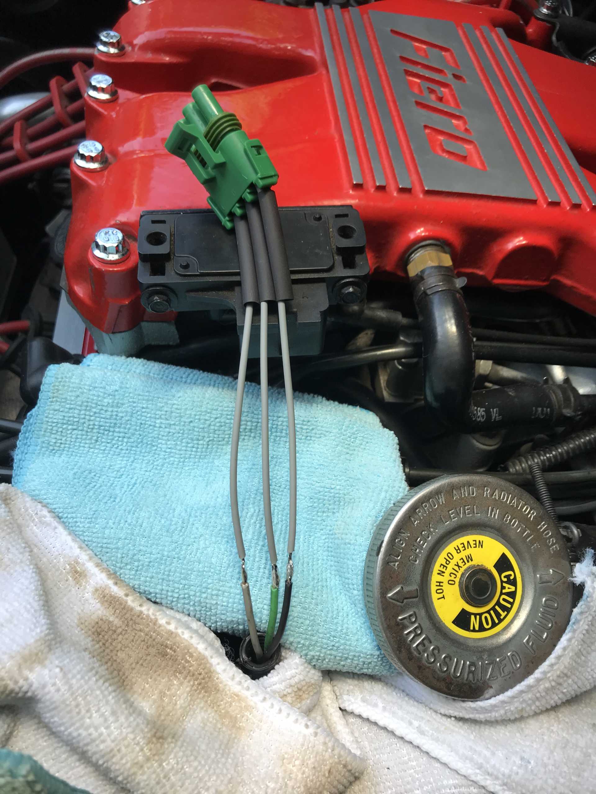

Just a follow up to in regard to fixing the root cause of my high idle. (poorly made aftermarket MAP pigtail connector)
Here is a pic for of what I did today. I installed (this time around) a factory GM pigtail connector and it worked just fine. As an FYI, I used to simply use butt connectors on connection’s like these but the last few years I decided to do the more proper thing and that is to solder the leads together and then cover them with shrink tubing. I had just soldered the connections when I took this pic. (shrink tubing was the next step.
Kit

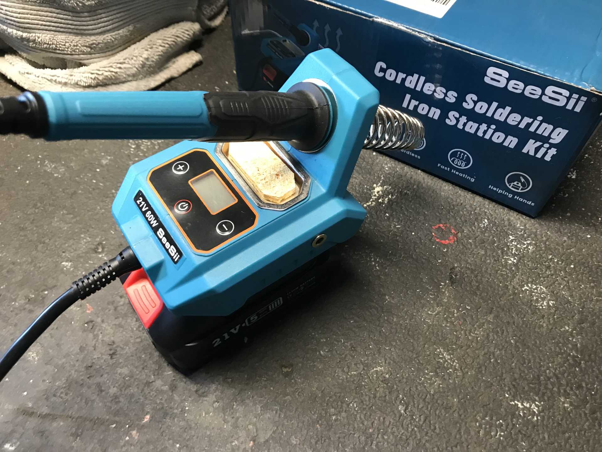

I forgot to add that soldering wires on cars (in this case in my driveway) has gotten so much easier now that I have this. 😀
Kit
