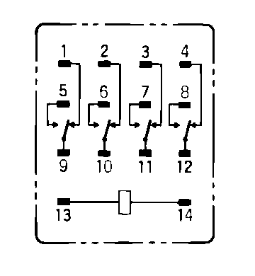

This is as close as I could find to the video. Same relay, just 12 volts only and 3amp instead of 5. Whatever route you go, you'll need to make sure it is "through hole" mount like the one I linked.
https://www.digikey.com/en/...y/MY4-02-DC12/283171
Here's the pinout
