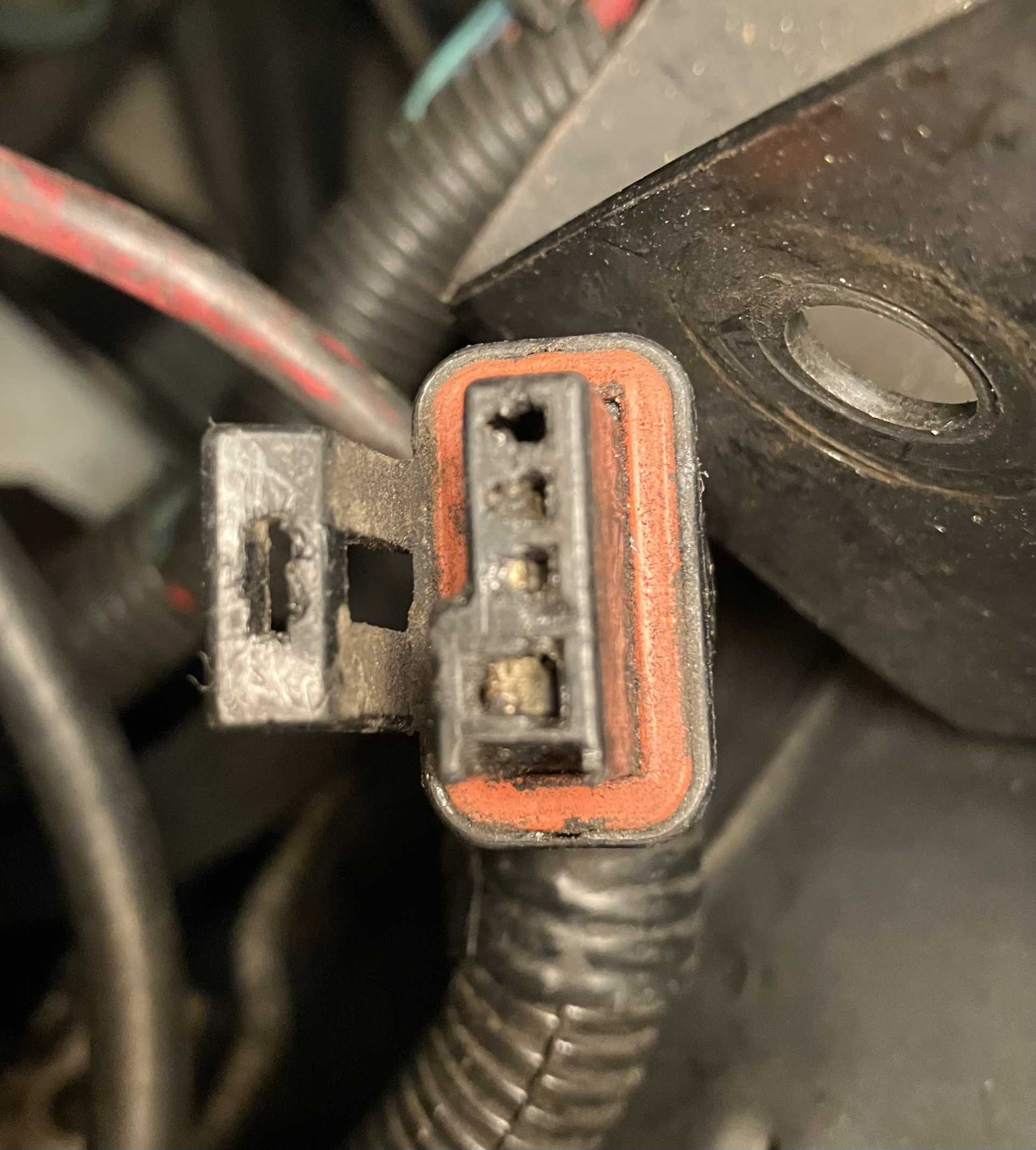

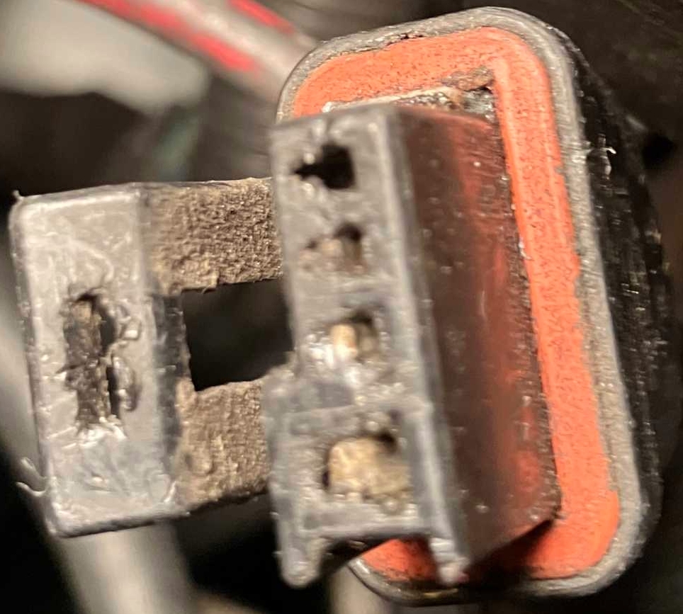

Thank you all for the replies. so after reading the responses, the new battery or the new alternator which I just recently purchased and installed is not good. I’ll go ahead and go to an AutoZone or O’Reilly and I’ll run test with the battery and get a second opinion as the volt test is being done.
Note: The alternator I have on my vehicle has the four tab connector. Could any of those four outputs be the problem? Thanks.

Report this Post03-21-2025 11:52 AM Click Here to See the Profile for Dennis LaGruaSend a Private Message to Dennis LaGruaEdit/Delete MessageReply w/QuoteDirect Link to This Post
Easy way to check. Buy a cheap voltohm meter. They are quite inexpensive on ebay. Use this meter to measure the voltage across the battery terminals. On a cold start you should read about 14.3 volts +/- 0.5v or in that area. if you don't read that .you will need to check out the charging circuit. If the car is not started the battery voltage on a good battery should be about 12.7 Volts.

Report this Post03-21-2025 02:00 PM Click Here to See the Profile for Vintage-NutSend a Private Message to Vintage-NutEdit/Delete MessageReply w/QuoteDirect Link to This Post
Did you buy a brand-new alternator OR Remanufactured?
The alternator has one big red cable to the battery stud/nut and a plug with three wires
Perhaps the regulator in the alternator has a defect OR the car circuits which as I already listed to test.
BEFORE going an auto store to test the alternator, charge the battery so it is fully charged....

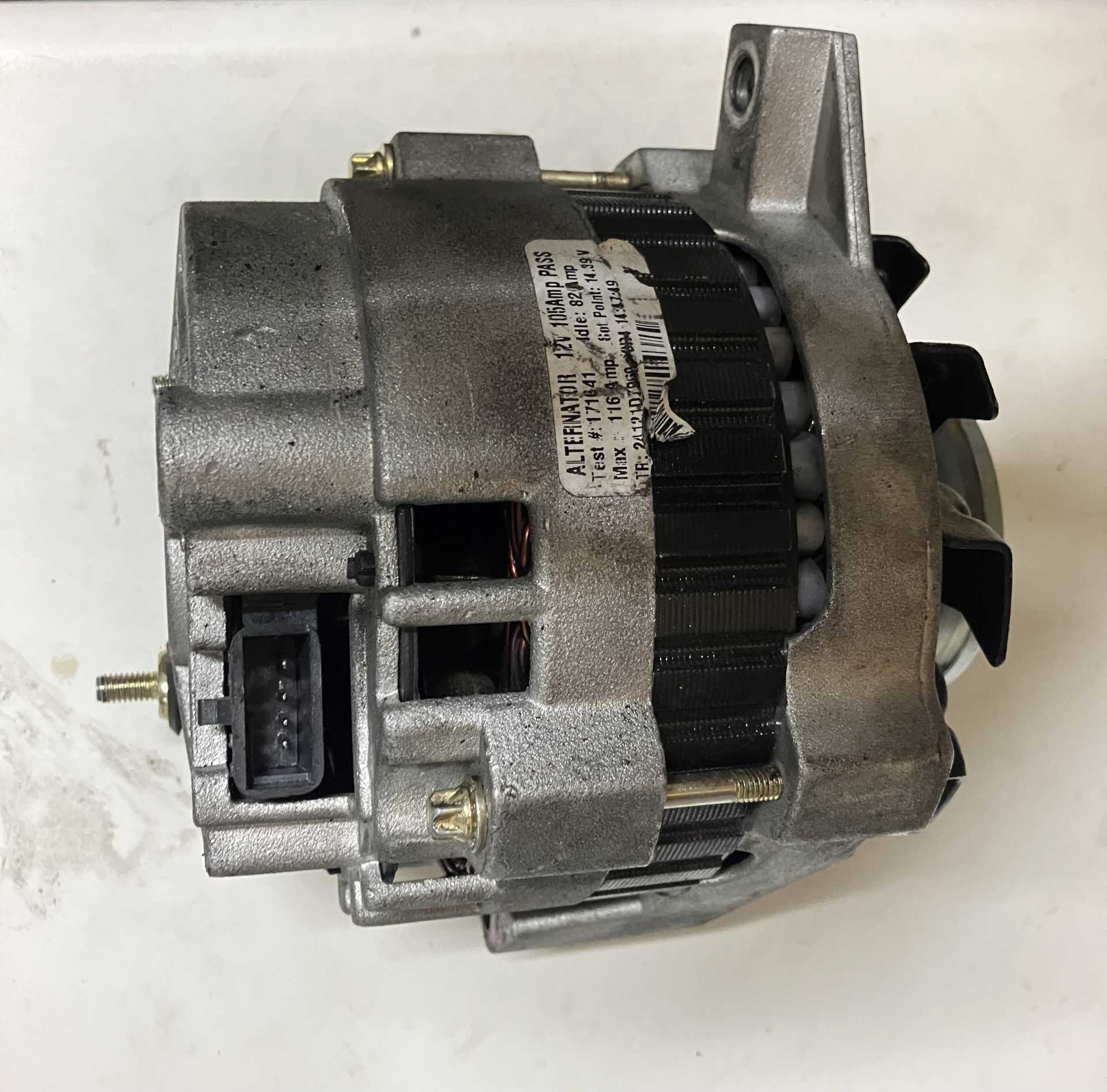

UPDATE : hello folks, I ran a test with a voltmeter and sure enough. It’s the alternator that was bad and this is the reading that was shown:
The battery was under charged at 11.2V so it’s now fully charged at 12.3 V. The good news is that my alternator was under warranty and it will be exchanged. Also additional good news the place where I bought the alternator they’re offering to exchange it for one that’s much more compatible for the Fiero. Anyone have any alternator suggestionsfor at 87SE with an iron Duke manual? Thank you all for your assistance.

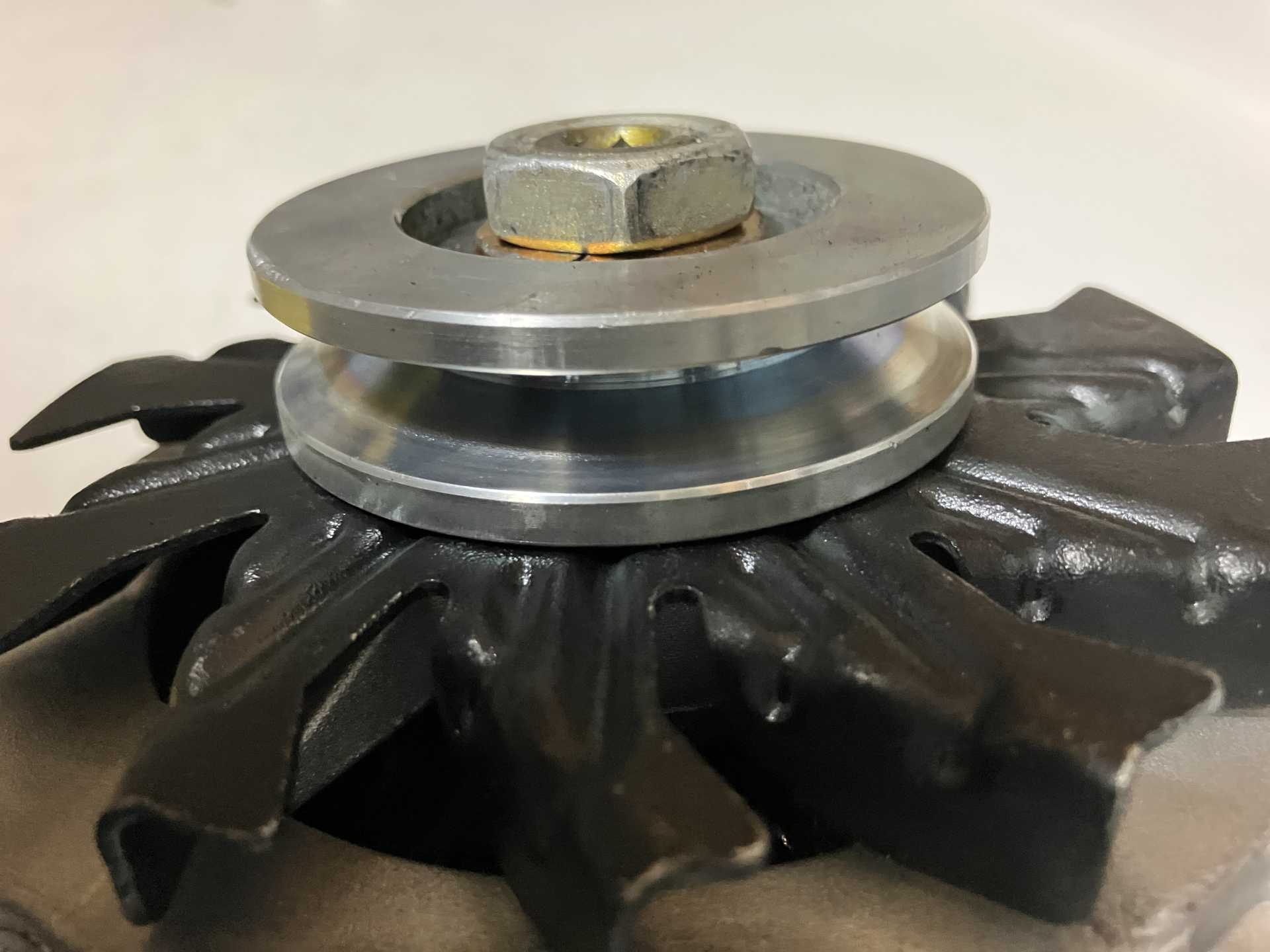

Originally posted by MERATIME:
This Fiero has had modifications on it before I owned. There is a regular Belt pulley that’s required not the serpentine. There’s a 12 o’clock and 6 o’clock positioned bolt for the mounting & adjusting...
I'll say it's been modified! This is what you're supposed to have...
How about taking a photo of this "modification" and posting it here. I'm curious how the belting has been arranged, as well as how the totally different clocking for the mounting ears has been utilized.
[This message has been edited by Patrick (edited 03-29-2025).]

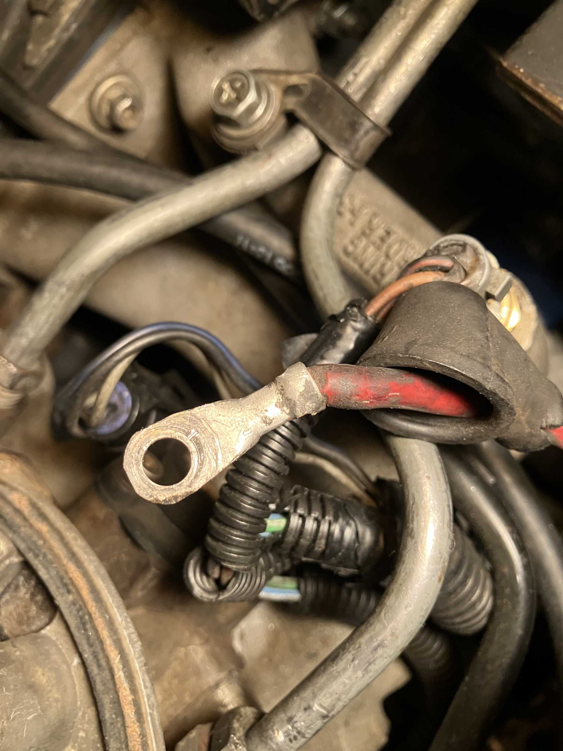

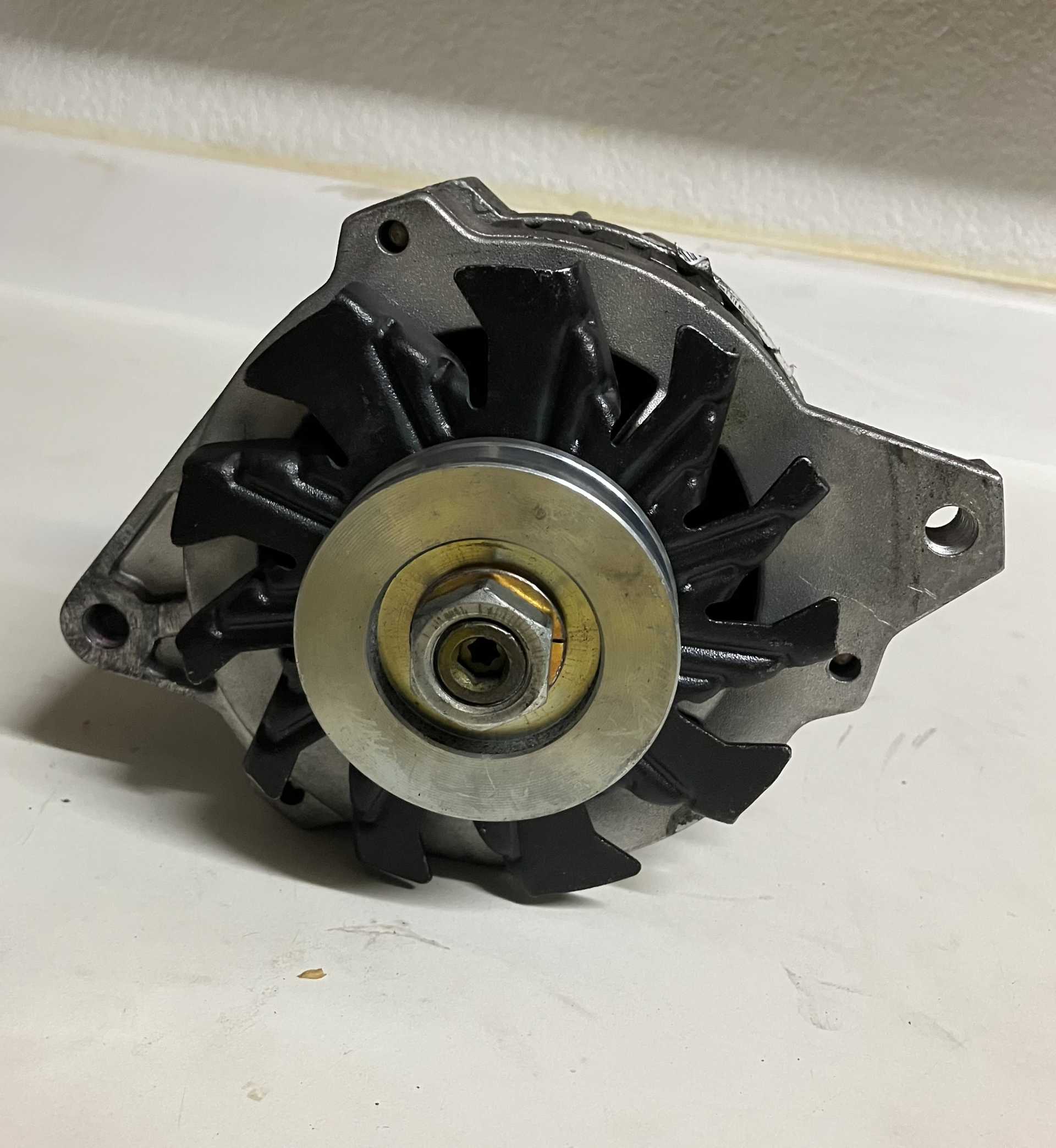

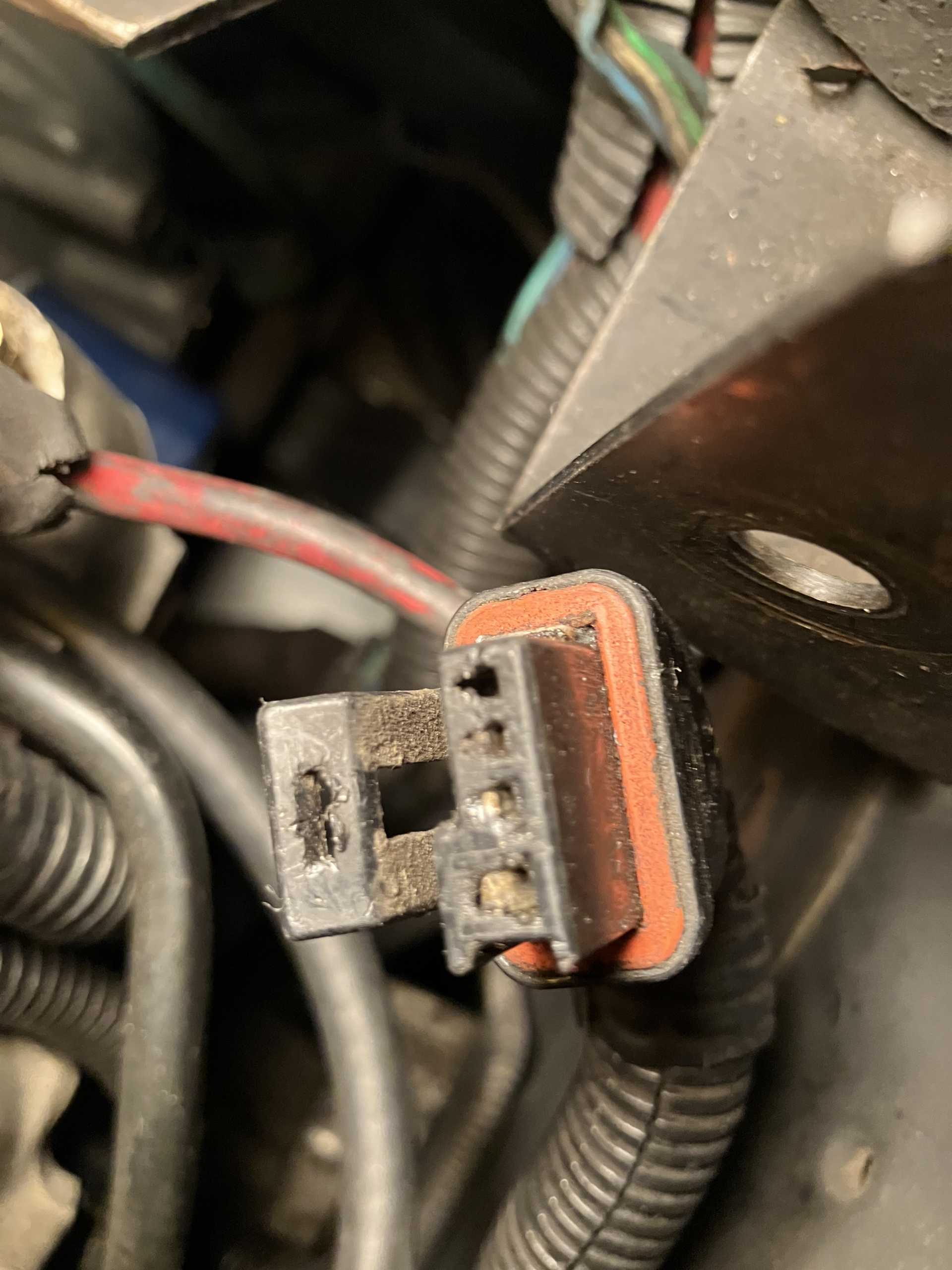

Report this Post03-29-2025 11:04 PM Click Here to See the Profile for MERATIMESend a Private Message to MERATIMEEdit/Delete MessageReply w/QuoteDirect Link to This Post
Hello Patrick, here are photos of the alternator & belt set up that I currently have on this 87 SE. It’s nighttime here now so I took these just so you have something to see the following day. Photos of the water pump set up, the lower crank pulley and of the defective alternator.
There is no compressor installed. In the next photo,You will see the bundle of wires on the bottom rightwhich go to the compressor.
Photos of the current set up below:

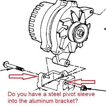

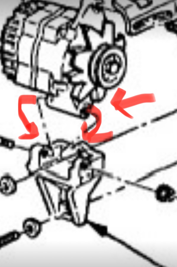

Posts: 39461
Total ratings: 464
Report this Post03-30-2025 12:52 AM Click Here to See the Profile for PatrickSend a Private Message to PatrickEdit/Delete MessageReply w/QuoteDirect Link to This Post
...here are photos of the alternator & belt set up that I currently have on this 87 SE.
That's bizarre! If I'm seeing things correctly, the image above is of where the '87 duke's factory serpentine belt tensioner pulley is supposed to be. It's missing, and apparently someone has sort of retrofitted the '84-'86 duke's inferior V-belt system to this '87. The only reason I can see someone doing that is if they were having a problem finding/replacing the 87's belt tensioner after it failed... but damn!
This is what your '87 duke belt system (with A/C) is supposed to look like.
...the place where I bought the alternator they’re offering to exchange it for one that’s much more compatible for the Fiero.
Since you have a non-factory setup, you better just get a direct replacement for your current alternator... but make sure it is the alternator that's fubared and not the wiring. Who knows what else has been messed with on that Fiero!
I also noticed the condition of the pigtail connector. Could this be a the reason or part of the problem with the charging light on the dash?
CLICK FOR FULL SIZE
With the connector so out of focus, it's difficult to see the actual condition of it. Maybe just blast it with WD40 to rinse any dirt off, and then liberally apply dielectric grease to it before plugging it into the new alternator.

Report this Post04-04-2025 04:57 AM Click Here to See the Profile for MERATIMESend a Private Message to MERATIMEEdit/Delete MessageReply w/QuoteDirect Link to This Post
Patrick, Here is another photo of that connector. I will try WD40 to clean the inner portions. Your advice is greatly appreciated.
Posts: 20112
Total ratings: 201
Report this Post04-04-2025 05:42 AM Click Here to See the Profile for olejoedadSend a Private Message to olejoedadEdit/Delete MessageReply w/QuoteDirect Link to This Post
Electrical contact cleaner, and a small pick to dig out the crud.
Posts: 39461
Total ratings: 464
Report this Post04-04-2025 01:02 PM Click Here to See the Profile for PatrickSend a Private Message to PatrickEdit/Delete MessageReply w/QuoteDirect Link to This Post
The part we want to see isn't much more in focus.
Electrical contact cleaner...
That would probably be optimal, but I just suggested something good enough that most people would already have on hand. Myself, I'd probably just stick that connector in a small dish of varsol and swish it around.
[This message has been edited by Patrick (edited 04-04-2025).]

Thanks many for the responses and suggestions. I ended up finding a Duralast Alternator. However, the base of the alternator that connects to the supporting triangular base part is about a penny width bigger on the alternator! I suppose I will grind it down for it to fit. Have any of you encountered that when buying or replacing alternators ? I was thinking it was intentionally done by the manufacturer for their proof of usage.

Report this Post04-05-2025 08:02 AM Click Here to See the Profile for Vintage-NutSend a Private Message to Vintage-NutEdit/Delete MessageReply w/QuoteDirect Link to This Post
I have a '88 V6 and the Generator/Alternator mounting pivot has a steel sleeve...
For an easier install for the new Generator/Alternator; this pivot sleeve must move a β€˜tad’ to allow some 'wiggle' room.
I applied penetrating oil at the steel pivot sleeve and the aluminum bracket area.
At the outer side: put a 13mm socket on top of the steel pivot sleeve sitting on the aluminum bracket and then put a clamp between the socket and the inner side of steel pivot sleeve.
I moved the sleeve around 1/16-inch...
Do you have a pivot sleeve too?
[This message has been edited by Vintage-Nut (edited 04-05-2025).]
