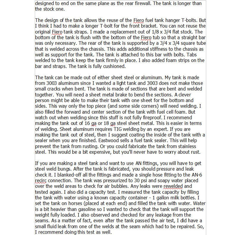

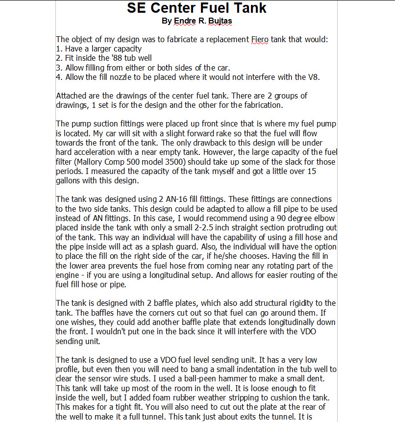

Here is a tank design for this persons V8 conversion where he customized the fittings but you can always use his measurements to create a stock tank based on your existing tank that you pull from your vehicle. At least you'll have the general measurements.
His ZIP file is in the first post.
https://www.westcoastfieros...-tank_topic1870.html
Here's his objective

I think I have came across this on the forum before, I'll try to clean my tank and restore it but if it comes to it I could always use this help me fabricate a new one
