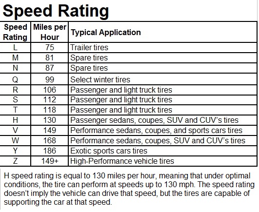

I just talked to a guy at the TireRack, and he stated that the reason that General AltiMax RT45 tires do not show up on a Fiero Tire search is because the REAR size is not >>"H"<< rated...Now, I want to point out that while some of us Autocross and race Fieros, those people will usually have moved on to larger wheels and somewhat exotic tire sizes.
For those who are driving normal on regular roads, there really is no need for that "H" rating, so if you wish to buy these >>Very good<< tires in the correct size for your Fiero, try calling the TireRack, then dialing extension 4743 and talk to Cooper.
Tire sizes available in AltiMax RT45 tire; 205, 215, 225/60-15.
I don't know if the ratings have been modified since their inception, but I have found that the 15" tires with an 'H' rating had significantly stiffer sidewalls and enhanced handling and turn-in, as compared to the 'S' and 'T' rated tires.
This seems to be accurate - I could only find 215/60-15 with a "T" rating. BUT-
The General AltiMax RT45 is available with an "H" rating in 225/60-15. I bought mine a couple of years ago, but Discount Tire still lists them. Not listed as a stock size for our cars, of course, but very close in diameter and just a bit wider.

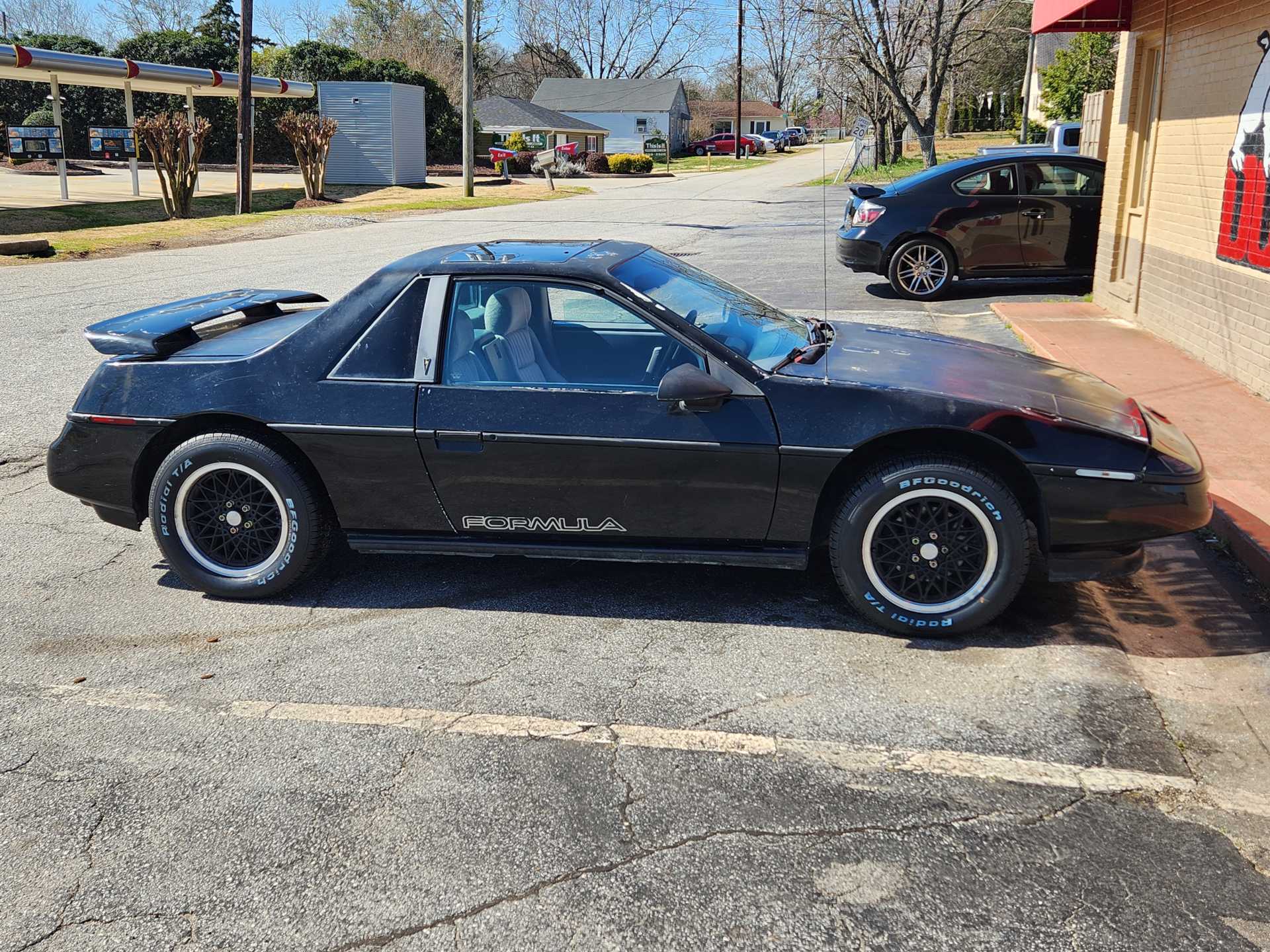

fierobear
Posts: 27116
From: Safe in the Carolinas
Total ratings: 382
Report this Post03-12-2025 05:38 PM Click Here to See the Profile for fierobearSend a Private Message to fierobearEdit/Delete MessageReply w/QuoteDirect Link to This Post
I think the tires look good on the car...
It drove real nice, and cornered well.

Report this Post03-12-2025 06:56 PM Click Here to See the Profile for 1985 Fiero GTSend a Private Message to 1985 Fiero GTEdit/Delete MessageReply w/QuoteDirect Link to This Post
Looks nice, use some dish soap and something to scrub the blue off the white letters, the bf Goodrich blue is thick and won't come off by itself, and after a few years of sun and wear look really bad, the white underneath is actual rubber in the tire, so don't be worried of scrubbing the white "off". I use Maguire's ultimate liquid wax on my tires, it is rubber safe, and keeps the tires clean (a simple hosing off cleans almost anything) and a nice deep black/clear white letters, not the dripping wet look from specific tire polishes, but it makes it look really nice.
I read about the blue thing, and asked the tire guy about it. I think he said "soap and water" but I'll give your idea a try, thanks.
Yeah, soap and water to get the blue off, Maguire's wax to make the tire look great and keep it clean as you drive.
