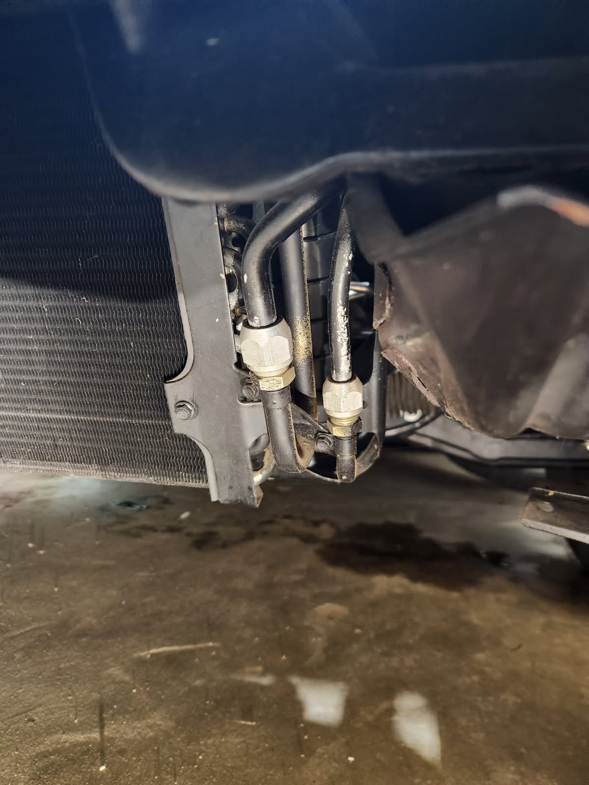

This is a bad thing, right? Haha...
On a serious note, my daughter just swapped this out, and replaced all the O-rings in that area. We've been going through every part of the HVAC system and replacing the O-Rings with the green ones, and we of course, replaced the old A/C compressor. Is there any concern on this dirt being all over the inside of the AC lines? I checked at multiple points and it was totally clean everywhere except for here...

Looks like that is what is referred to as black death.
Yes in my experience its bad, as far as correcting it's likely going to be costly because that junk is passing through the whole system.

Catastrophic compressor failure. Would definitely flush the lines.

Thanks guys, I appreciate it. I've used compressed air to clean out the lines, but thus far, I've seen nothing in the lines anywhere. I'm concerned though the evaporator coil (or whatever it's called that sits in front of the radiator) probably has gunk in it.

The condenser is in front of the vehicle, evaporator is in the hvac duct. They're two long lines under the car but also some that run the sides towards the condenser. The hard part on these cars are all the low points that unless you have a compressor with enough cfm/flush machine it's hard to get clean on the car.

Thanks, I appreciate it. The A/C compressor has apparently been bad for over a decade. It's on my daughter's car, and she's only had it for 2 years. The previous owner (who had the car for almost 20 years) said the A/C never worked... haha... so it's all really old. It was still pressurized though when I removed the lines.
I know debris wouldn't be great for the new compressor, but is it reasonable to think that the next filter would catch most of the stuff in there, and I could just change it out again? (if cleaning the lines doesn't work)?

You might think of why it is called "black death". Also, flushing you A/C line with compressed air can introduce moisture into your A/C system, even if it has been discharged. Which is a contributor to black death.
I have worked with A/C experts.
Black death originates inside the A/C compressor. When recharging an A/C system, the compressor needs new oil.
I am above my pay grade.
The lack of oil causes the Teflon seals to wear, which in turn causes wear on the cylinder, scroll, and vane The wear creates fine metallic particles that accumulate throughout the system, clogging the filter in the orifice tube or the port in an expansion valve.
When the system fails, you have to replace the compressor, the expansion devices, and the condenser, along with a complete flush of the hoses and the evaporator. It’s critical to remove all the debris that spread throughout the system.

If it were mine, this is what I would do. Replace broken bits. Clean as best I could. Vacuum and recharge system. Drive the car around for a little while. Then discharge the system and replace the orifice tube again because I am willing to bet more crap will be stuck to it. I have had this happen to me. Yes, it costs money but trying to buy a condensor is ridiculous for our vehicles. Unless we use a complete custom unit, which now that I am thinking about it this may be something I do later down the road.

The hardest part in my opinion with flushing the system is getting the gunk out. Low points in the system are hardest to deal with.
I had my complete system out of the car a couple years ago. This afforded me the opportunity to flush each component separately. I too used compressed air in conjunction with a lot of solvent. The hardest part is all the u-bends and sandwiched plates.
Now I was super fortunate to get my hands on an nos condenser and that saved me a lot of headaches I'm sure.
If I was faced with your situation yeah, I'd likely try to do it with components in the car but I'd isolate where feasible.
I don't know how well a professional flush machine works but I'd think you'd want to agitate the solvent as it's moving through the components.
After all that you've got to get the proper amount of oil in the various components. I only did this after putting a vacuum on and doing a leak check.

On my car, I took every component off and flushed them with FJC solvent, and a flush gun hooked up to a compressor. Flushed everything except the new compressor, new accumulator, and a used condenser I got off another car. Flushed all the lines, hoses, and evaporator.
If you're lucky, any minor debris left over after flushing everything will get caught in the orifice tube screen. If you're unlucky, it'll punch through the screen material and into the new compressor, grenading it, too. If you're really worried about debris, you can get the new system working for a week, recover the refrigerant, and inspect the new orifice tube.

https://autoacsolutions.com...p?search_query=fiero
I flushed the evaporator and under car lines. I captured the flush, filtered it and flushed the evaporator and lines several times until it came out clean and did a final flush with new AC flush. I used Nylog Blue on all the O rings, no leaks so far.

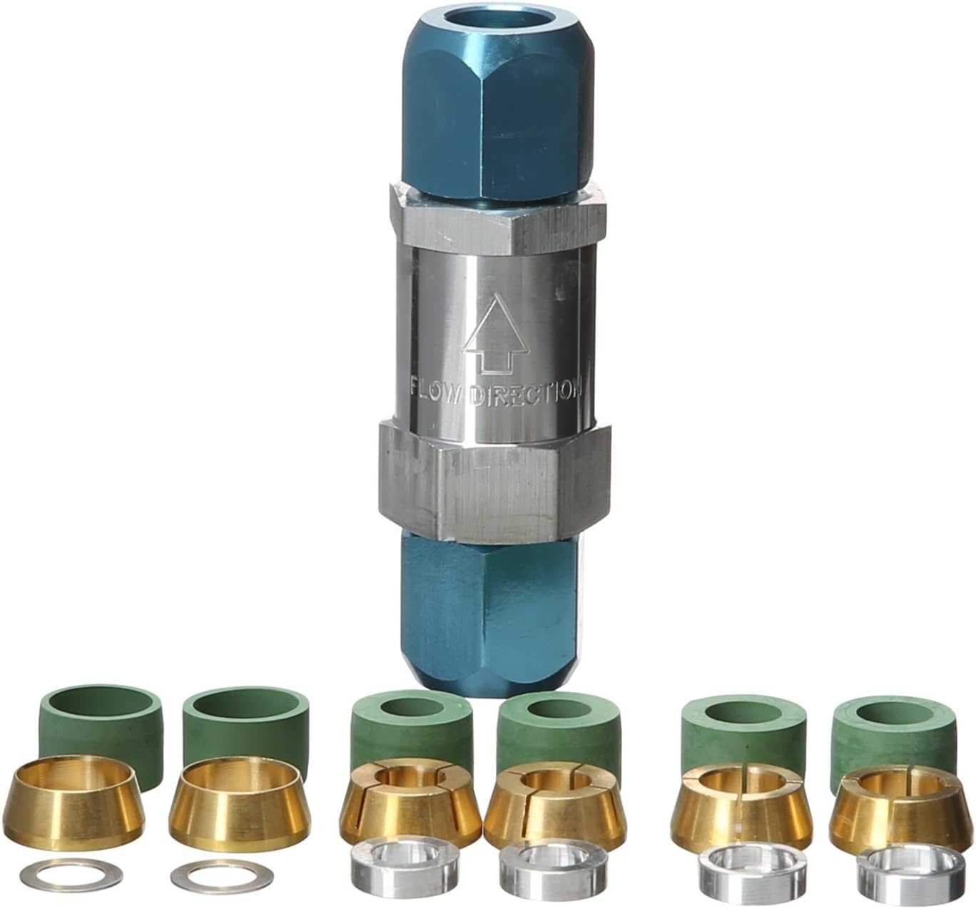

Years ago I did an ac repair on a ford (known for black death). Owner had replaced the compressor multiple times and had properly flushed everthing he could multiple times. Nothing seemed to help until I installed a 'universal inline ac debris filter'. He would get a season out of it before it would would need a change but he no longer had to replace compressors. Link included for your review.
Amazon..
TSI Supercool 13128 Universal High Side In-Line Filter
Amazon..
I TRIED installing these on a cracked line, they leaked the moment the car moved. 0/10 do not recommend.
The one I posted was not the one I used and It's been a while so I can't remember the brand but they all work the same. I had good luck with the two or three I installed. Oh, lines were not cracked.
