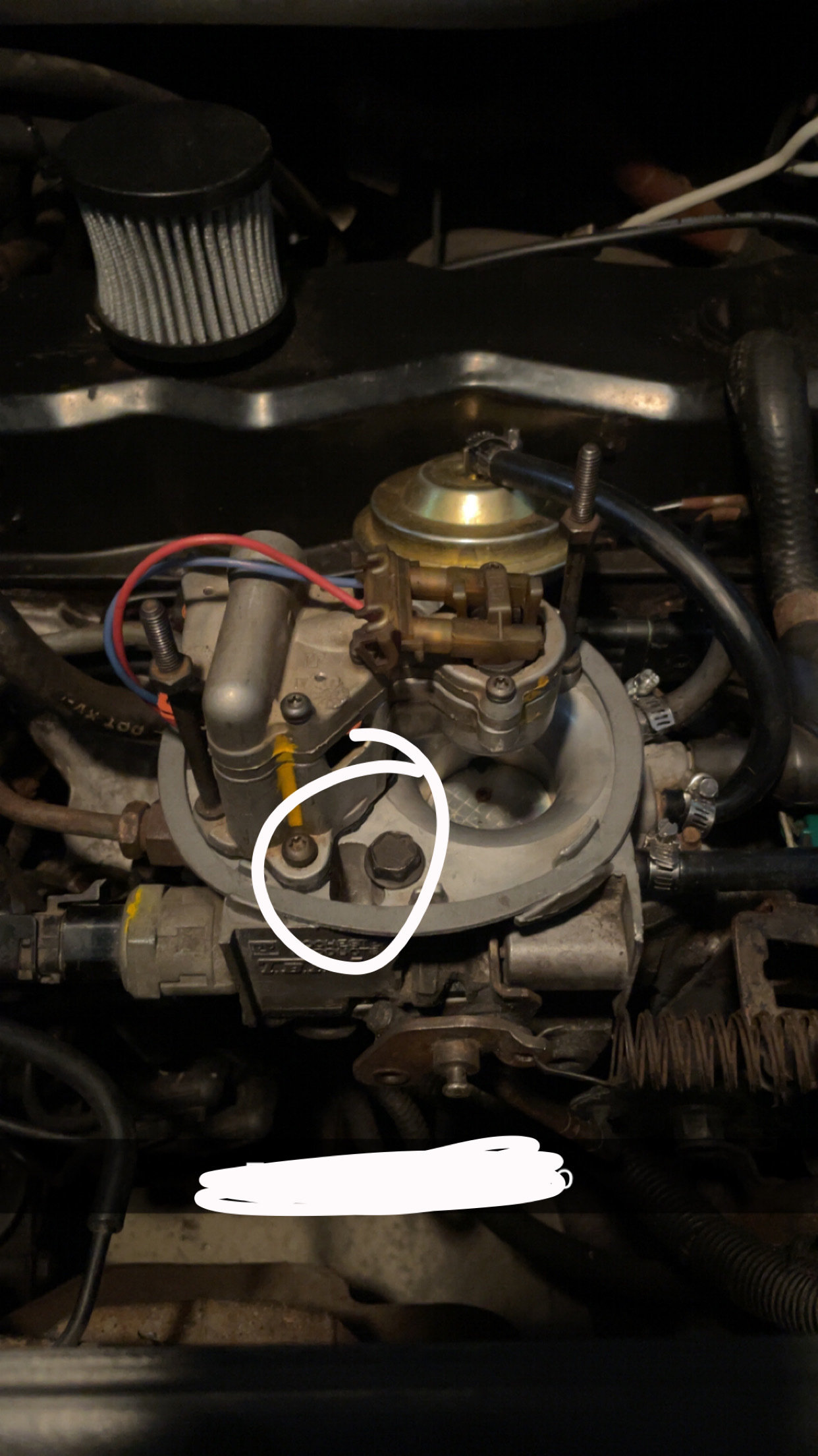

I don't really know what you mean but the "top IAC hole," but it sounds like you have a vacuum leak.
This below video is what you can expect for a normal "cold start" on an Iron Duke:
This is a nearly-stock 1985 Fiero 2m4 with Iron Duke and manual transmission. The engine was rebuilt (it still only has like 40 miles on it), and all the emissions stuff is working. It may help you figure out what the issue is.
~2,000 rpms is normal for the initial start-up. GM intentionally programmed the ECM to do this so that it warms the car up as quickly as possible... specifically for emissions. There's several ports on the throttle body that are engaged at various points, though if any of them were open, it would be causing a vacuum leak and a higher idle. The one I think you may be having an issue with is the ThermAC, but not sure. This is controlled by the ThermAC thermostat valve in the air cleaner. One goes from the TBI to the valve, and another from the valve to the ThermAC flap at the mouth of the air cleaner.
But definitely check all your vacuum lines on the TBI unit (passenger side). The other place you may want to look is also the "tree" that sits on top of the intake on the left side (closer to the drivers side). There's like three ports on it. When I end up in situations like this, I usually just plug all of the ports and start slowly connecting them back to see where there's a vacuum leak.

Thank you. I will post a picture of the hole I am talking about on the TBI.
I deleted my thermac system and plugged the vacuum port as well.
I will try messing with the “tree” that you mentioned as well.
Picture of IAC top hole I mentioned:
