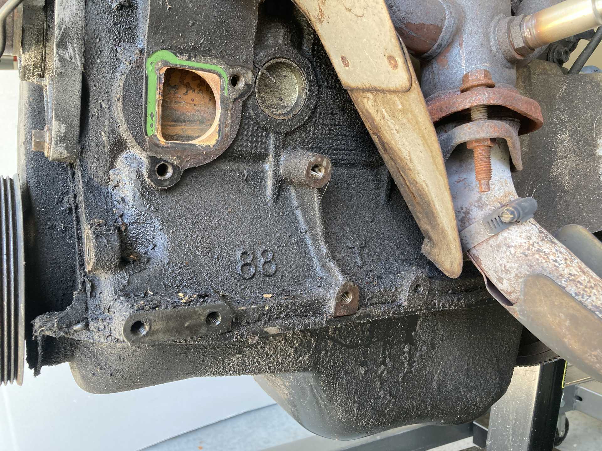

As far as I can tell, these two bolts go directly into the coolant passages:
EDIT: Sorry, I should have marked up the image... I mean the two bolts by the coolant inlet down there in the lower right on the side of the motor (diagonally opposed).

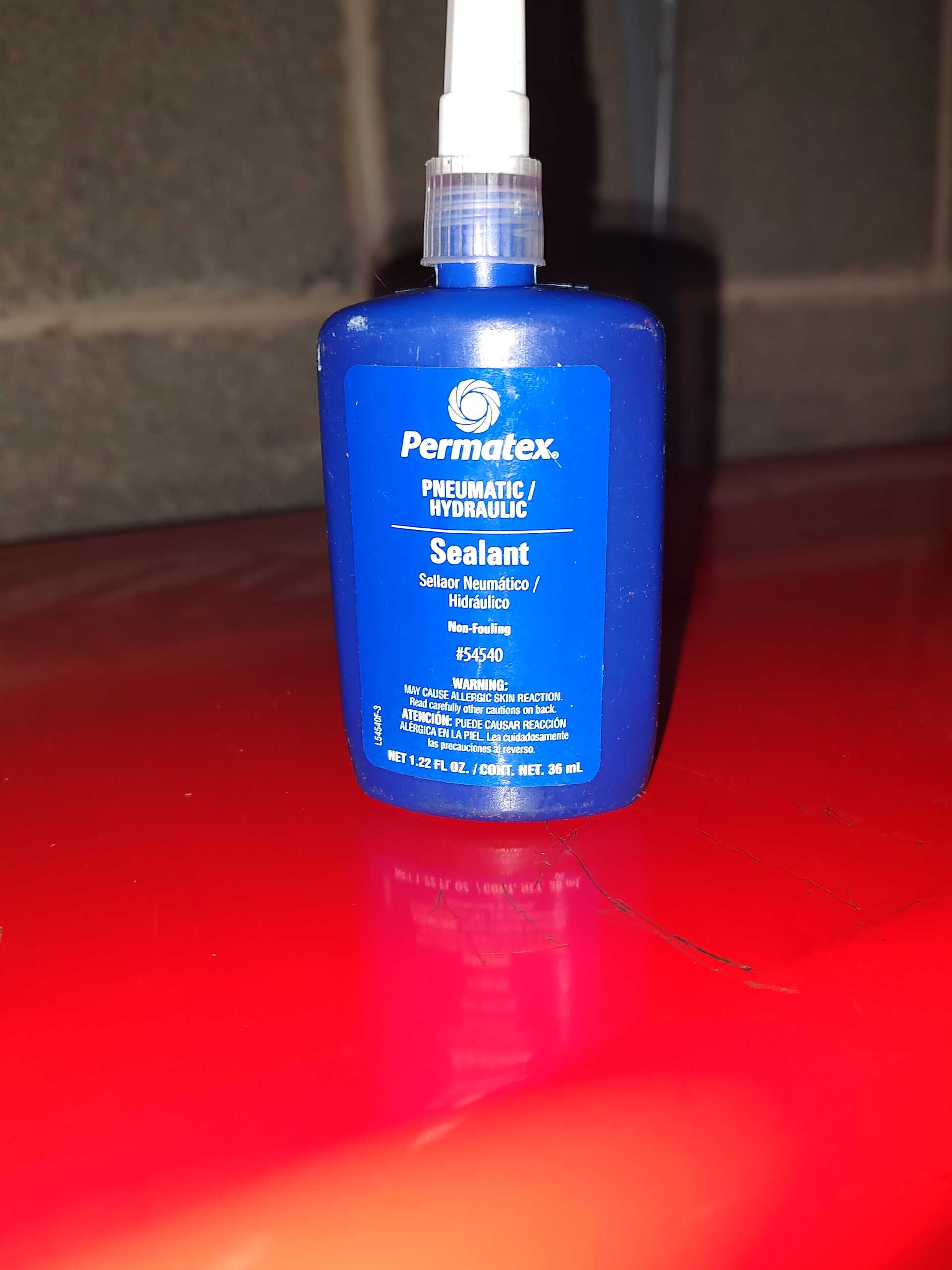

Wild guess, but I'm assuming this is an acceptable product?
https://www.amazon.com/Perm...ealant/dp/B000FW7VHI
That is liquid / gelled Teflon.
Permatex Thread Sealant (51813) or Teflon Tape? Interesting thread (no pun intended as you are wondering about bolt threads).

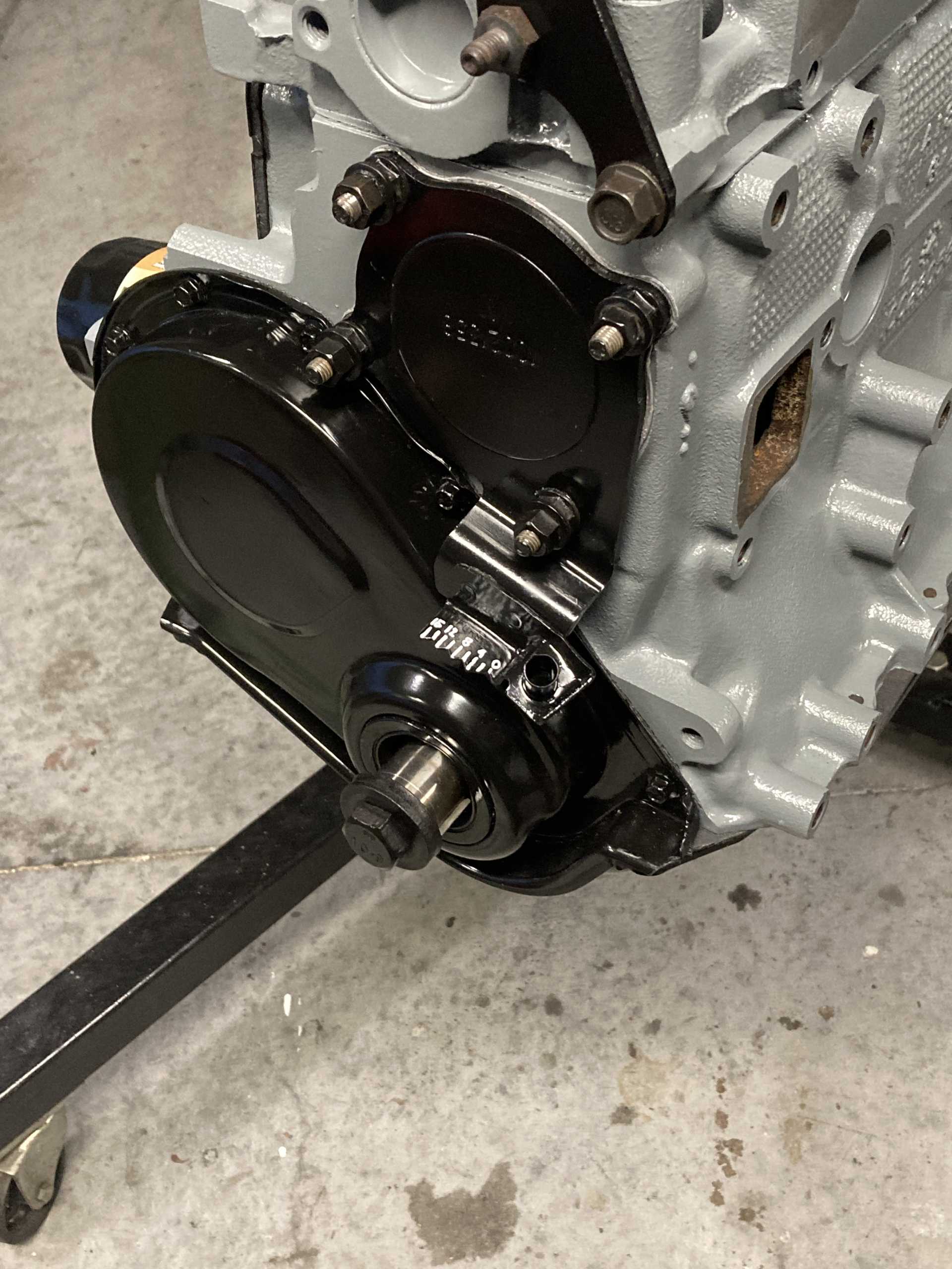

So, on that port... it's... "complicated."
The original Iron Duke when it was longitudinally mounted, the water pump was mounted directly in the front (where you see that plate that has four bolts on it). That gaping hole on the side of the engine (with the two bolts), is actually where the "water pump housing" connects to, and then the water pump connects to that.
It looks like this when all assembled:
I remember the gasket I used was literally just a flat piece of plastic, so it had to be torqued down really well. I don't know if that's my problem, but I bought a better gasket this time:
I can't seem to find any pictures of my daughter's engine (I know I have them, just can't find them) with a close-up of the water port... but here's one from the 1988 engine I had (which I was using for parts):
Note, the "better" gasket was also used on this one too. But, you can see clearly that the upper right bolt (from the port) clearly protrudes into the coolant passage.

"But, you can see clearly that the upper right bolt (from the port) clearly protrudes into the coolant passage.
No, I can't. It looks like it might. How long was the bolt ? Screw the correct bolt into the block and feel inside, for the bolt.

This sealant was engineered to hold high pressure. Here is what we use and it has held connections, with air to 125psi and oil pressures to several thousand lbs on out shop hydraulic lift. Should easily seal and contain the pressure in an engine cooling system.

Sorry Todd. My bad . It is a Permatex product called Motoseal case sealant. I know we had a 3M product we used but our currant inventory is permatex. This product does work very well as it will stretch and give as two surfaces heat and shrink. sleek

Just wanted to let you guys know... I used that Permatex stuff (thanks Sleek), along with the new (and better) body to engine block gasket... and we had absolutely no leaks today. Put about 40 miles on the car... ran amazing, no leaks at all. Thanks!!!
