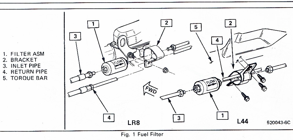

BTW - The easiest way to pinch the fuel return line is under the car.....
