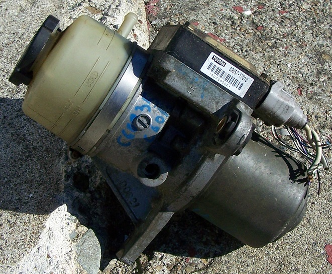

I actually have one of those 3rd-gen MR2 pumps- and am not going to use it....If you want it, let me know...

I'd be VERY interested in that. Wiring it would be an experience to say the least. Is there a benefit to that over finding a way to make 72 foot lines for an engine mounted flavor of pump?

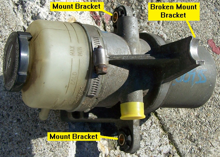

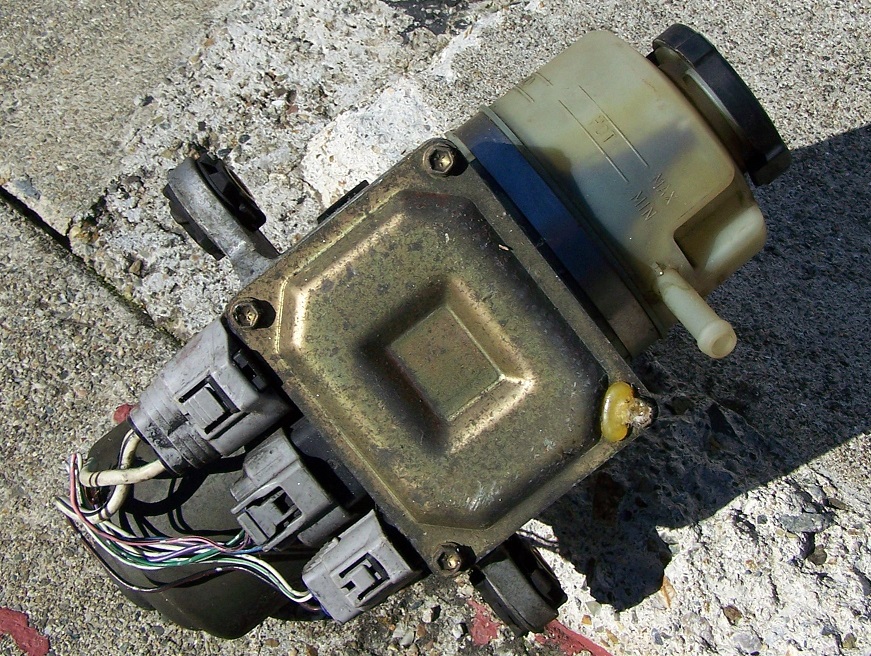

cvxjet
Posts: 3933
From: ca, usa
Registered: May 2010
Report this Post01-10-2025 02:39 PM Click Here to See the Profile for cvxjetSend a Private Message to cvxjetEdit/Delete MessageReply w/QuoteDirect Link to This Post
Here are the pics I took today- I was planning on adding PS to the car back around 2018, but with Lupus (Contracted in 2019) destroying my body, there isn't much reason to do the mod- and it would be difficult for me to do now....
