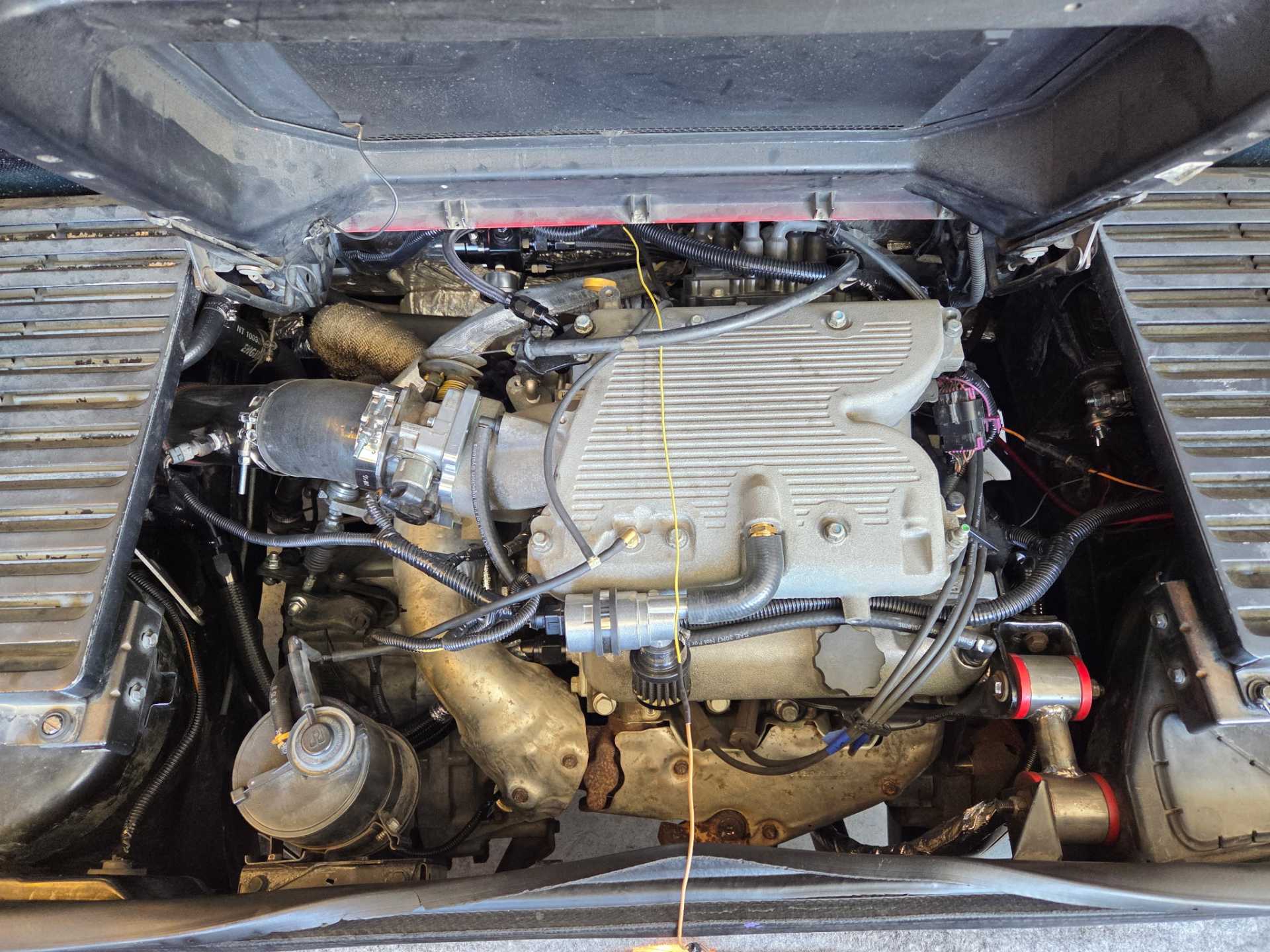

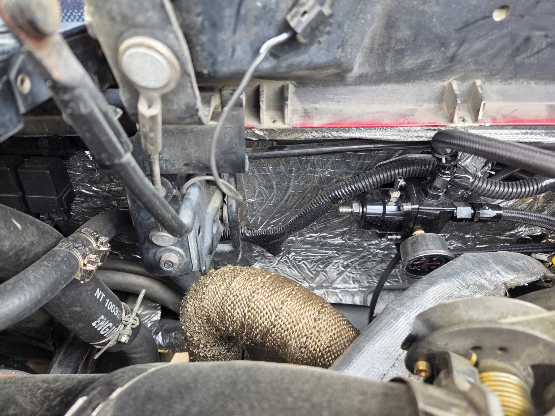

megasquirt mount
megasquirt mounted
throttle cable bracket
throttle cable bracketed
fuel pressure regulator
lines at the bottom
relocated evap canister
intake
IAC mounted

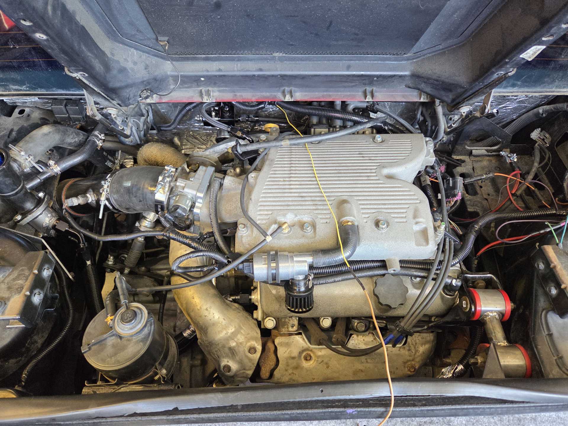

Sorry I haven't updated in so long
Here is the vid of like the second time I started it. Its after I got all the wiring done but before the coolant stuff was finished.
https://youtu.be/kCaAPfNgQw4?si=DjSECrn5tvcmXTEJ
Speaking of wiring. This is how it looks right now. The wire running over the top of the engine is the oil pressure sender wire I have a bad sender at the moment so its not plugged in until I get the new one installed. Pretty much all of the wiring was using the 8ft leads from the Mega Squirt harness and crimping them onto the original plugs from the Uplander harness and going into the c500 and c203 connectors for the Fiero body harness. I reused the little sub harness for the injectors that runs underneath the manifold.
The few things that had to be done after the wiring before actually driving the car, was the dogbone, intake routing, and coolant. Got the intake routed in front of the fender liner in about the same spot as factory, just not ducted to the inlet on the side of the car anymore.
After the intake was routed I was able to route the coolant pipes. I was actually able to reuse the original stuff all around besides the an fittings to adapt to the heads.
Made the dogbone and mount for it, reused most of the original Fiero bracket but extended it in some spots so it would reach the right spot on the front side head. slotted the hole where the two pieces fit so that it would bolt together given the mounting spots on the LZ9 heads. made a new dogbone out of tube to fit the new bracket location, reusing the bushings I had in my old dogbone.
This is the state its in now
Made a base tune and everything myself so its running not great as of now but it was enough that I was confident to run it in autox this last weekend! It starts up, and almost dies, then idles around 1000 rpm just fine. I think since i have the evap always purging it is probably making it a lot harder on myself for tuning and all. But on the factory radiator with a Volvo fan the car didn't overheat and was staying in the 200-210F range I wanted it to be at. The thing is waaaay faster now definitely a huge improvement even with my mediocre tuning most likely holding it back.
[This message has been edited by TheMoist1 (edited 05-05-2025).]

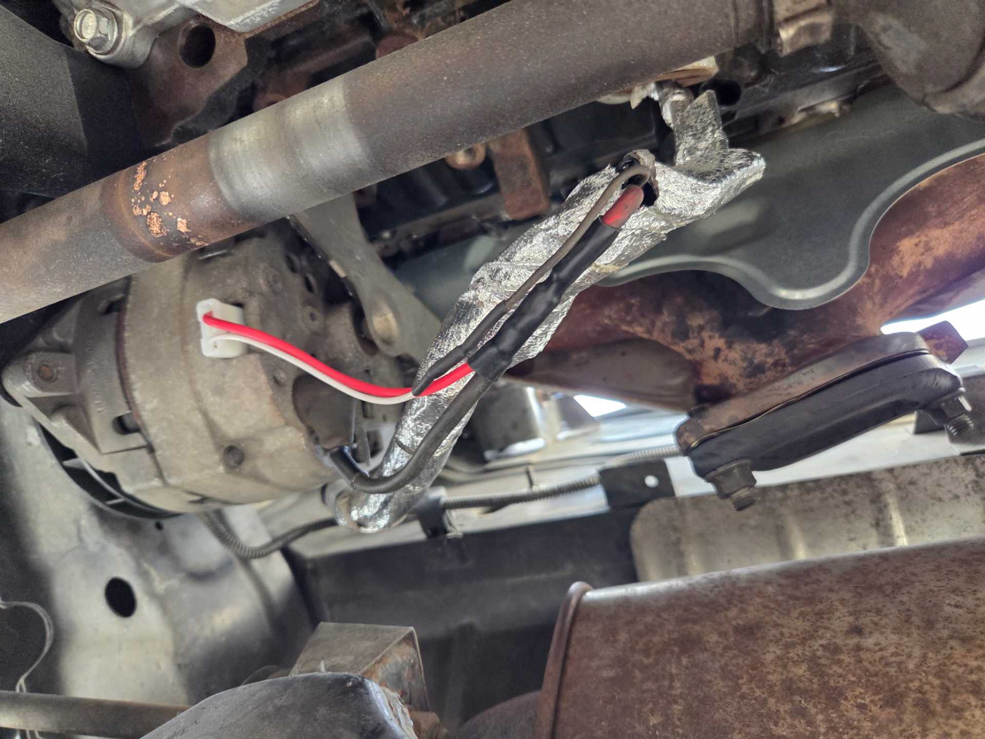

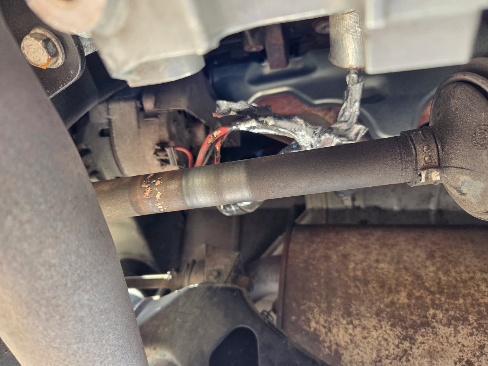

Little bit of a PSA: don't use the cheapest loom available on amazon It is definitely not made for the heat in the engine bay. It got all droopy in a few spots, and the loom going down to the trans got melted on the exhaust crossover pipe. I wrapped it in aluminum tape and that seemed to fix it for now. I will eventually re-loom the harness at some point to fix the problem entirely. The good news is I just took it on a road trip from Salt Lake, UT to Farmington, NM. about 860 miles round trip, and I had absolutely zero issues with it. The corvette I road tripped with was the one that had an issue The Fiero is leaking a very slight about of coolant from one of the coolant hoses on the driver side not new after the trip, but I have new rubber hoses to fix that. One little issue that was fixed just before the trip, was the alternator wire was rubbing on my axle shaft... I was having weird times when my radio would cut out but turn back on shortly after and i didn't realize what it meant. I guess it was just shorting out through the shaft but got it fixed and secured now so that shouldn't happen again.
Droopy at firewall
Melted on crossover
Mangled alternator wire
Fixed

Yeah, heat management of an engine bay is a pain sometimes.
I've had all sorts of things melt and/or catch on fire over the years.
It's the radiant heat transfer that gets you!
Thin galvanised sheet steel can be used to make all kinds of heat shields to protect vital items; sensors, wiring too close to the exhaust, alternators and starters, engine mounts, etc...
Just make sure that the heat shield stands off by a cm or two (air gap) and the fixations don't conduct too much heat to the thing you are trying to protect.
