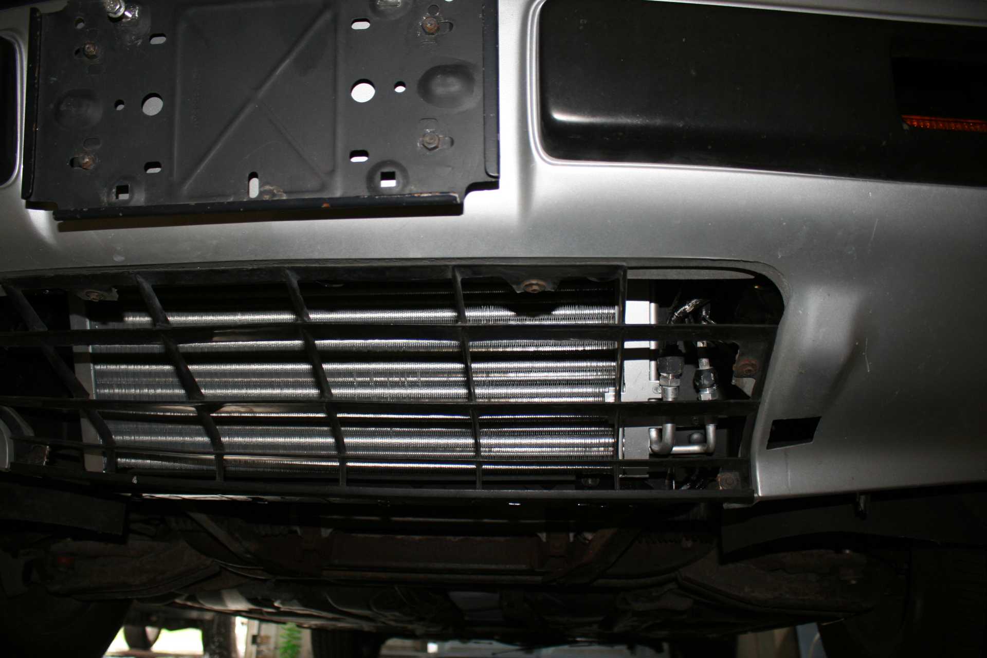

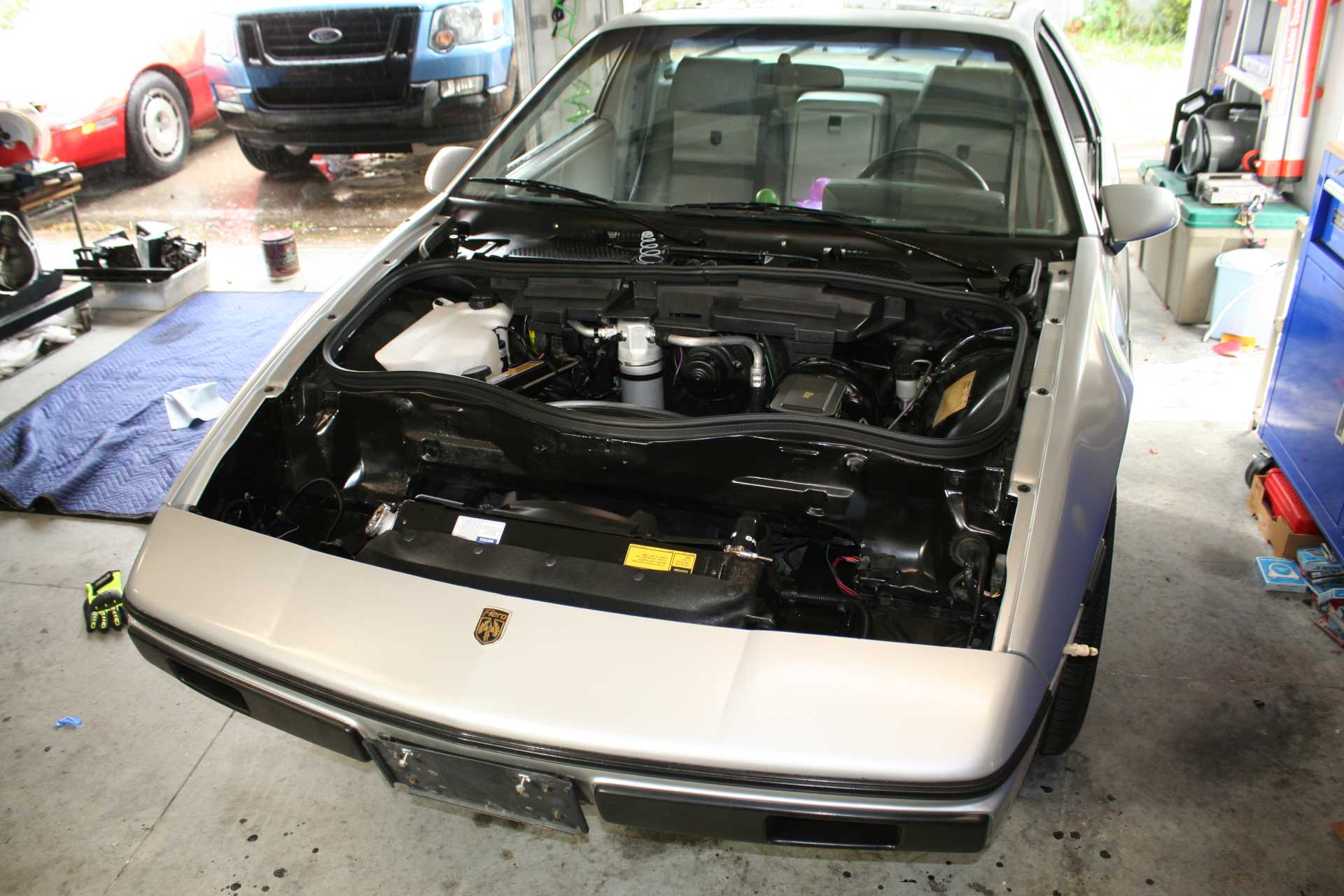

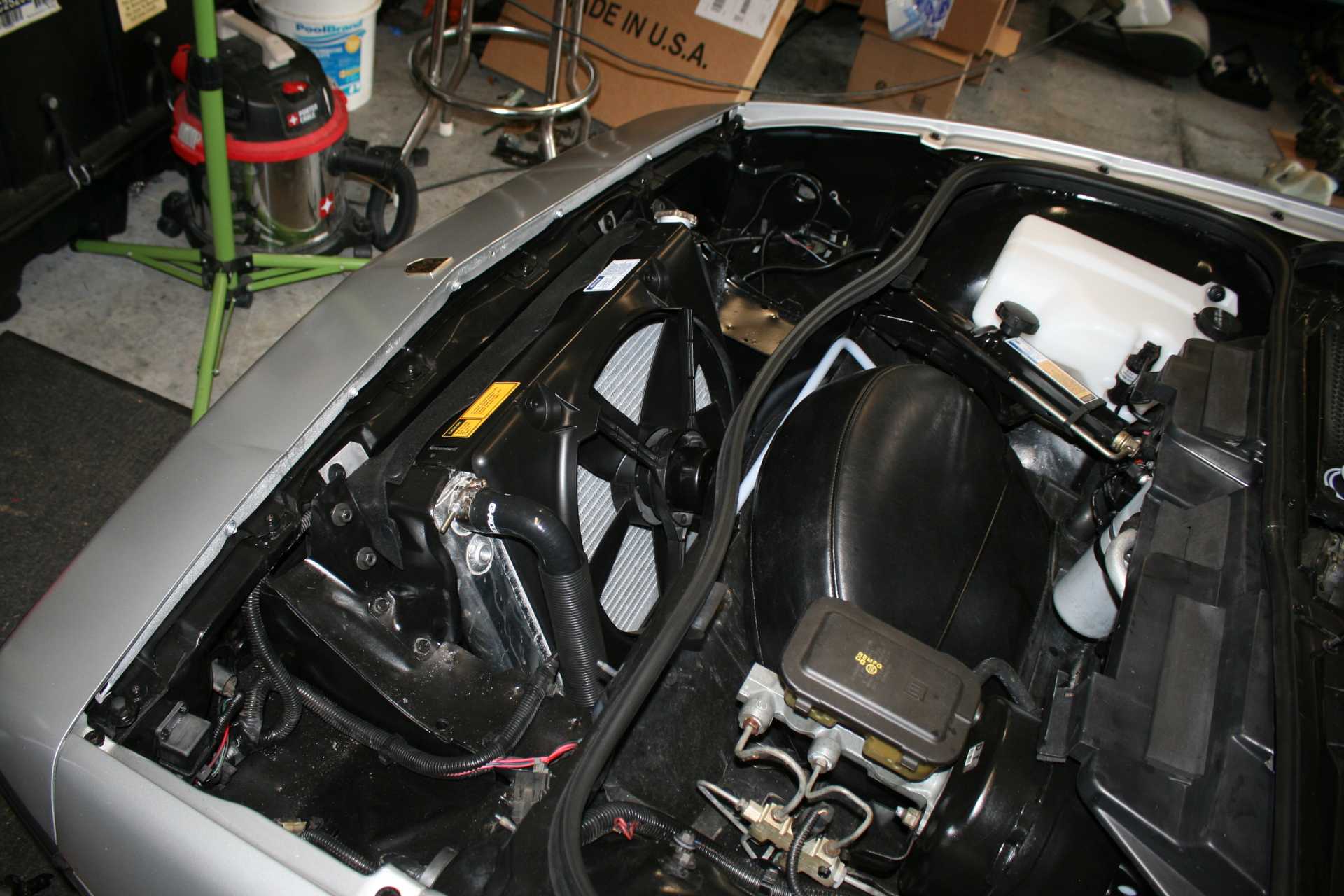

We've redone the front of the car (which we're still finishing up), just got everything back together and installed a 4 or 5-core radiator. I can't remember which... it was totally overkill for the Iron Duke, but at the time I was trying to do anything i could to mitigate what I thought was an overheating issue. The radiator barely fits under the factory brackets. We had to basically modify them using pliers, an anvil and a mallet to re-shape it.
We also installed a new condenser in front...
She sanded and repainted everything up front... this is after she re-installed the front bumper...
Anyway, it'll be a couple of weeks (we're going on a trip), but once we fill it back up with coolant, I'll report back if the sensor fixed the problem (for the sake of thread closure). I am not sure if I mentioned it above, but I took the opportunity to completely remove the waterpump, replaced the gasket, and checked everything... no blockages or anything like that.

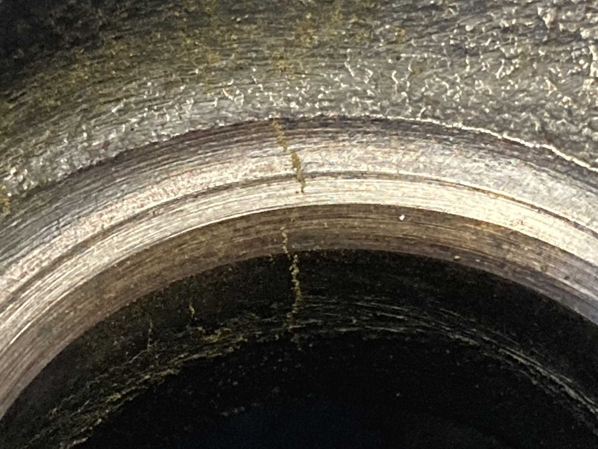

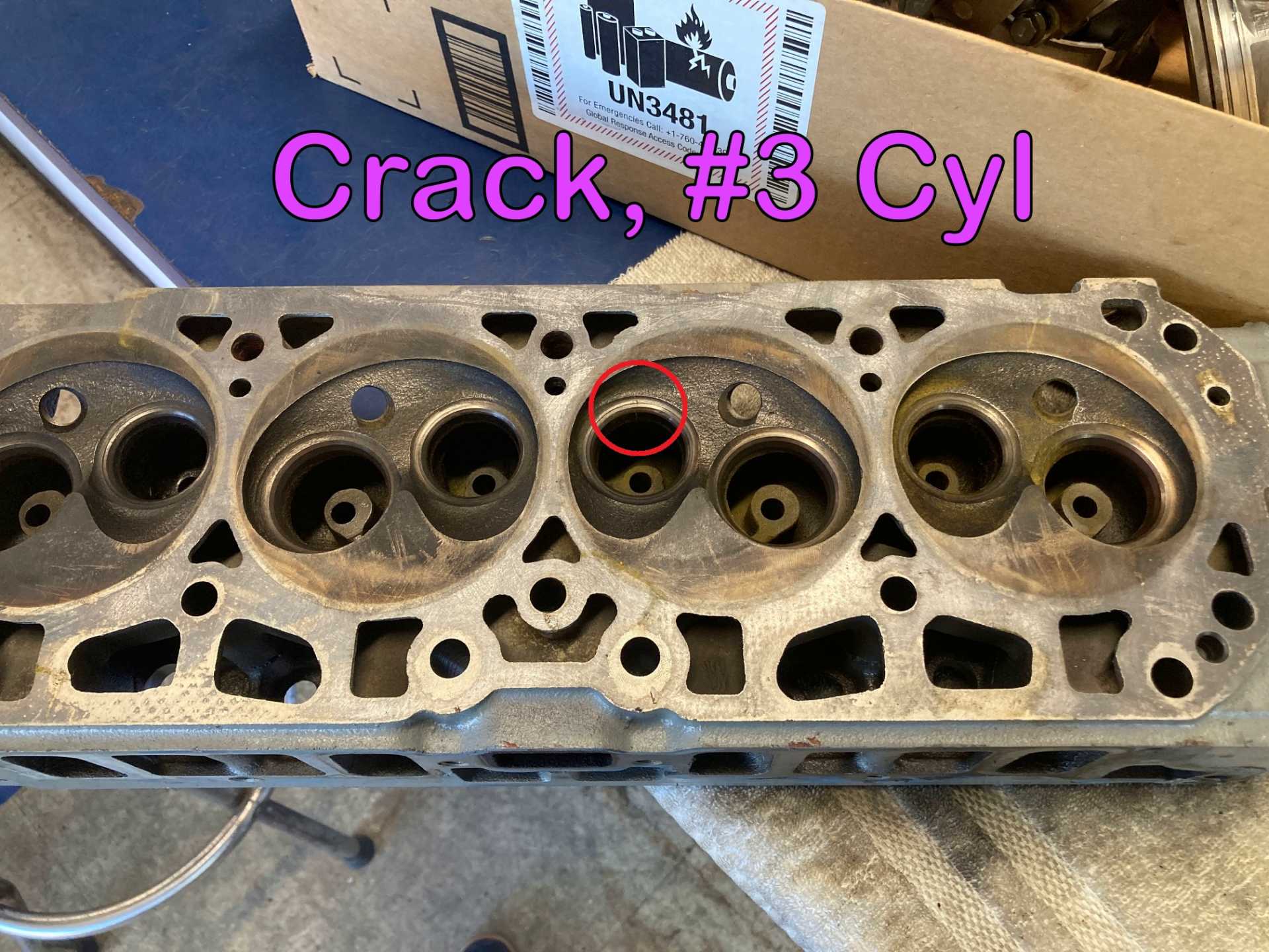

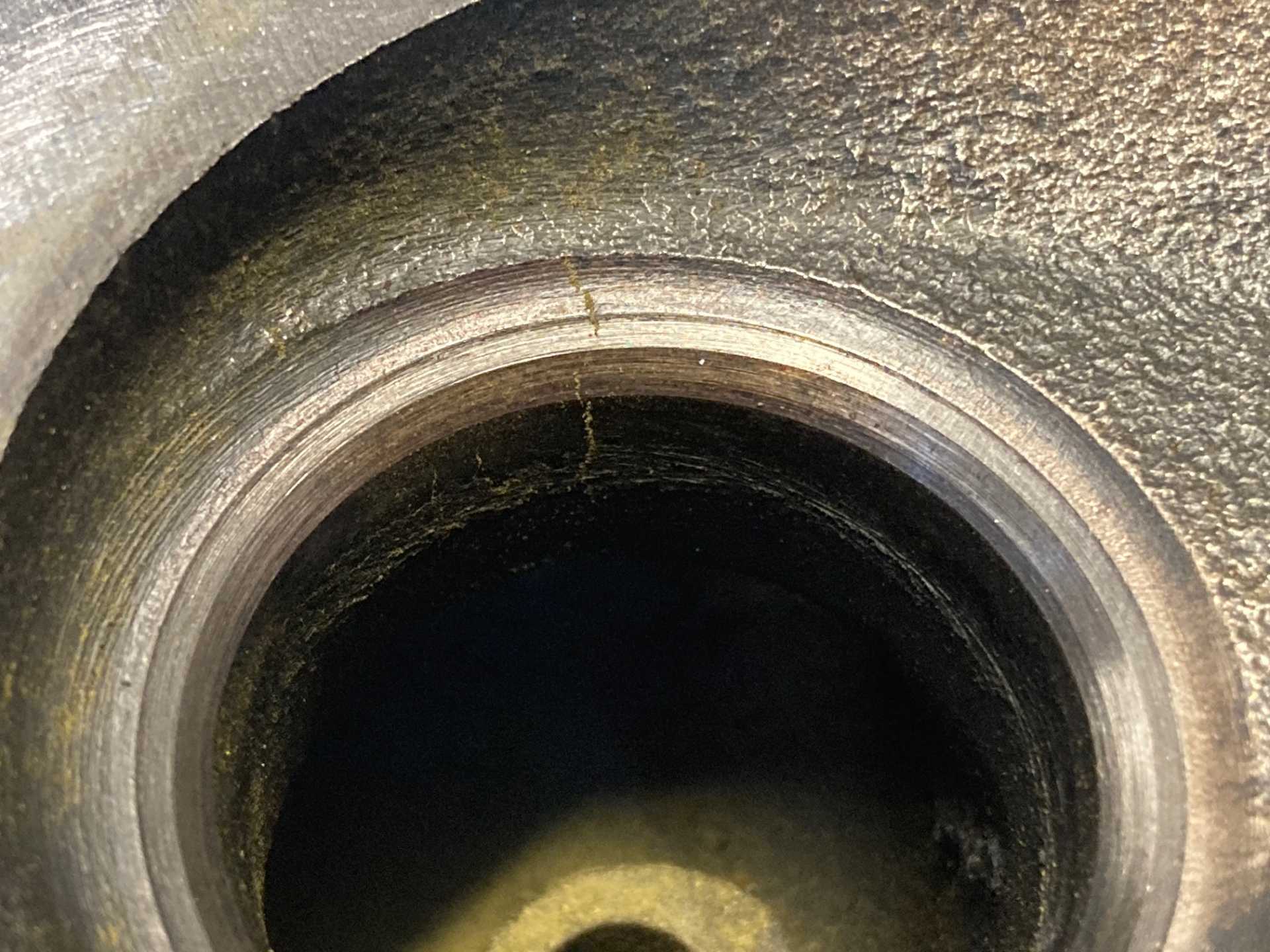

Just wanted to post a final update on this, in case anyone searches up these symptoms and has a similar problem. I mentioned in the last post (above) that the machine shop thought that (what I was telling them) the cyl head sounded like it had a crack in it.
I just went to pick up some exhaust manifolds for the Corvette, and check on the intake manifold, and they had the update for the cyl head ready for me... they verified that it was in fact cracked. Here are some pictures:
So, just to confirm what I'm showing here, it's a crack on the exhaust port of the #3 cyl, which is directly next to a water port in the cyl head.
What he said to me, without even me saying anything is that this is a crack that would only show up when you're driving around, or putting it under load. He said that under idle, it would show absolutely no signs of being cracked, that it wouldn't even burn coolant at idle, but as you start driving it around, it'll switch between sucking in coolant and forcing exhaust gasses into the coolant chambers.
So... this was most likely my problem!
I still need my intake manifold back. I had them bore it out, but he had written 56mm on it, but I needed it bored out too 46 mm. He didn't want to do it because he felt 56 was too much. He had already bored it out to 45mm but waited because he didn't want to ruin the intake. I talked to him again and asked him to bore it out to 50mm, becuase I have a Holley TBI unit that's 50mm, and maybe AJ can test the modified TBI we have (45.5mm), and the Holley one (50mm). So, I have options. He said he would be ready by next Friday.
