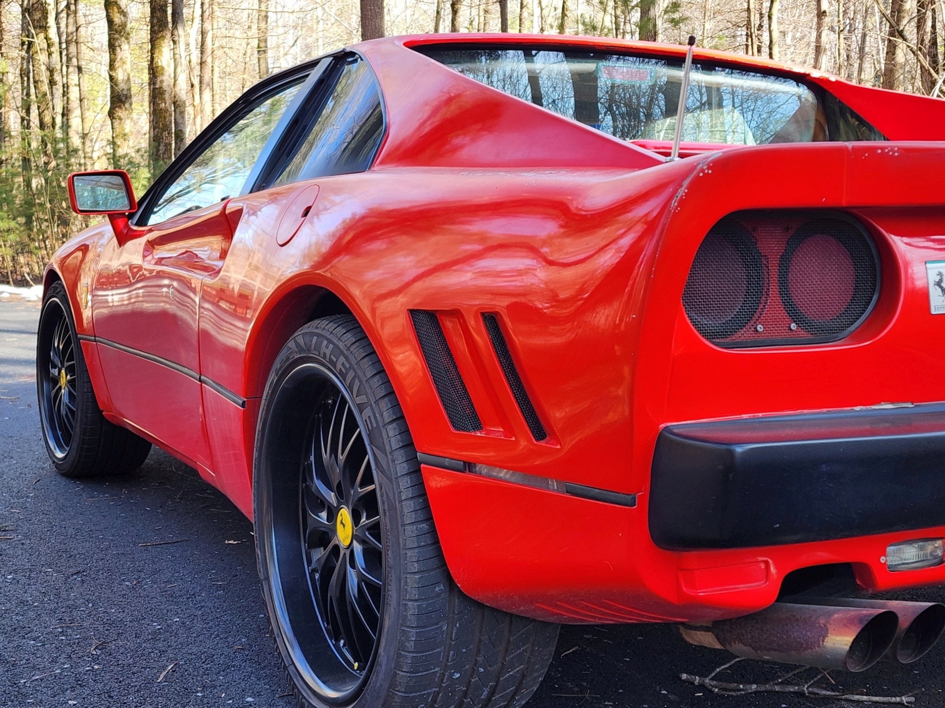

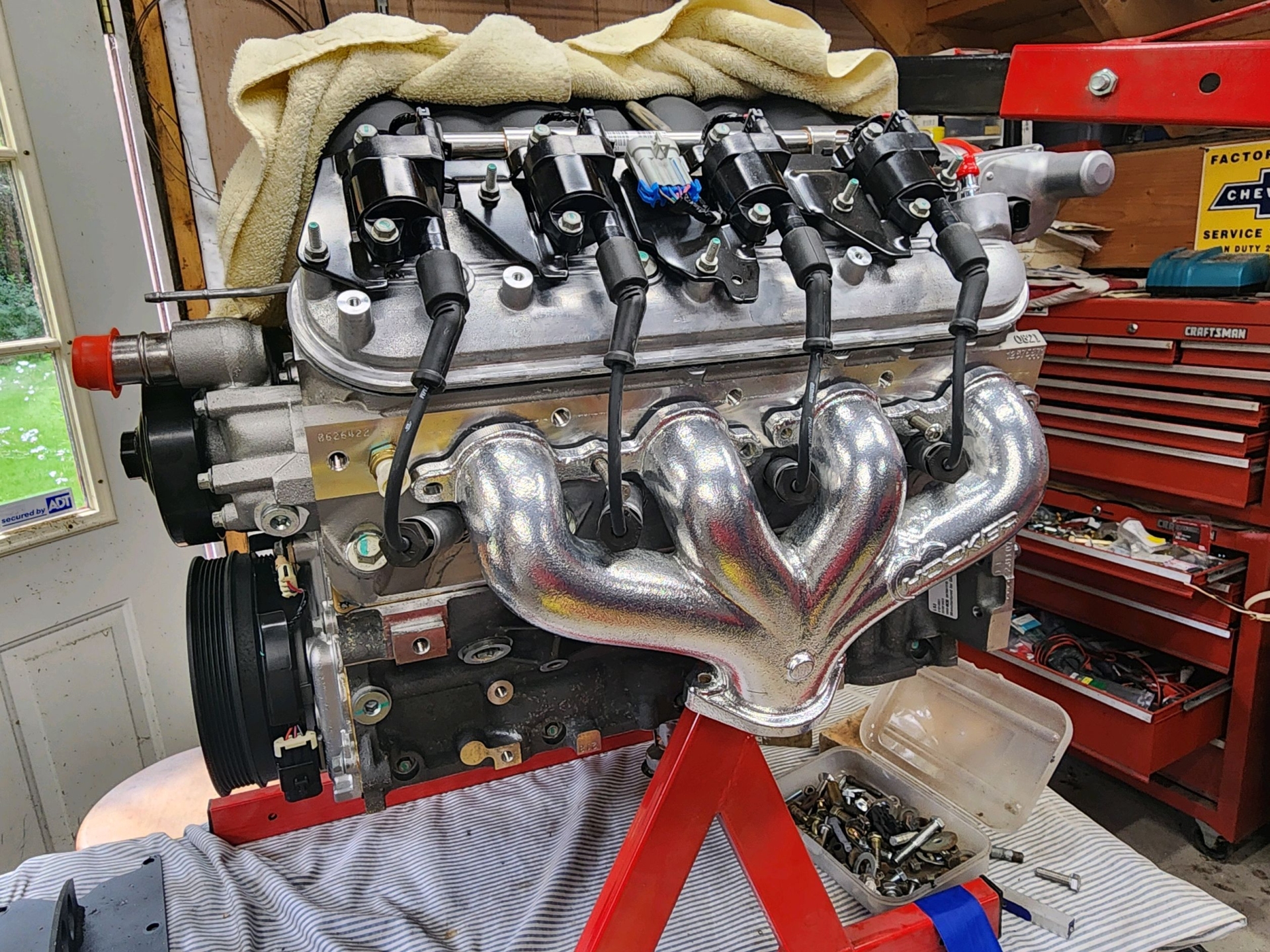

I've recently acquired an Alden Thomas GTO and am adding an LS3 and F40 via V8Archie kits. Any input related to this rare car would be greatly appreciated, especially the origin, contact information of original creator, etc. It's my hope to restore it back to original. Chassis is 88 Formula.
We've been told this is one of as many as 12 produced and likely one of the last ones. It appears the earlier ones had three vents behind the rear wheels and mine has two.
88GT 355 CI, AED HO 750 Double Pumper, AFR milled 180, Dyno'd at 427 HP, 360 WHP, F40 6-Spd

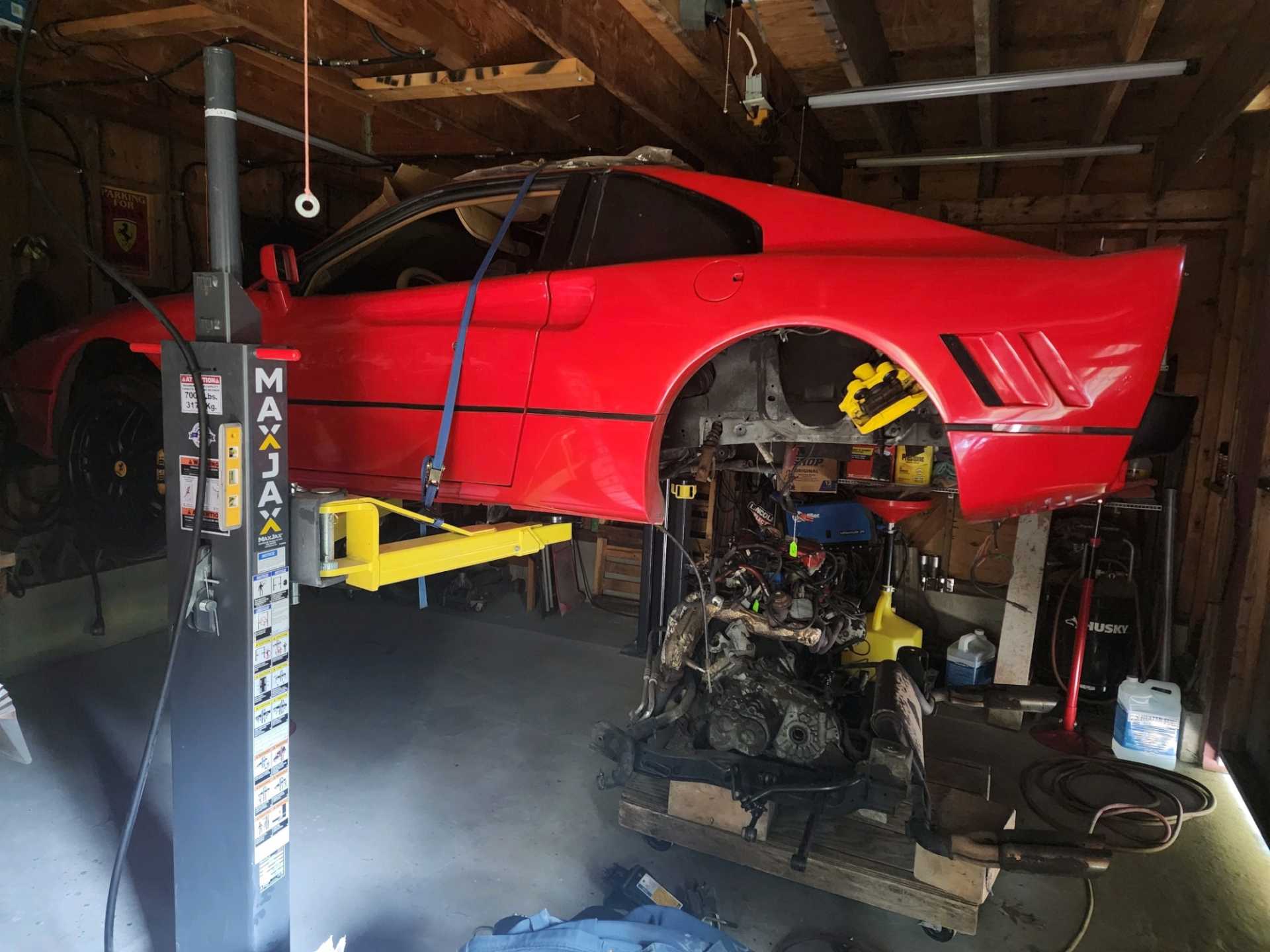

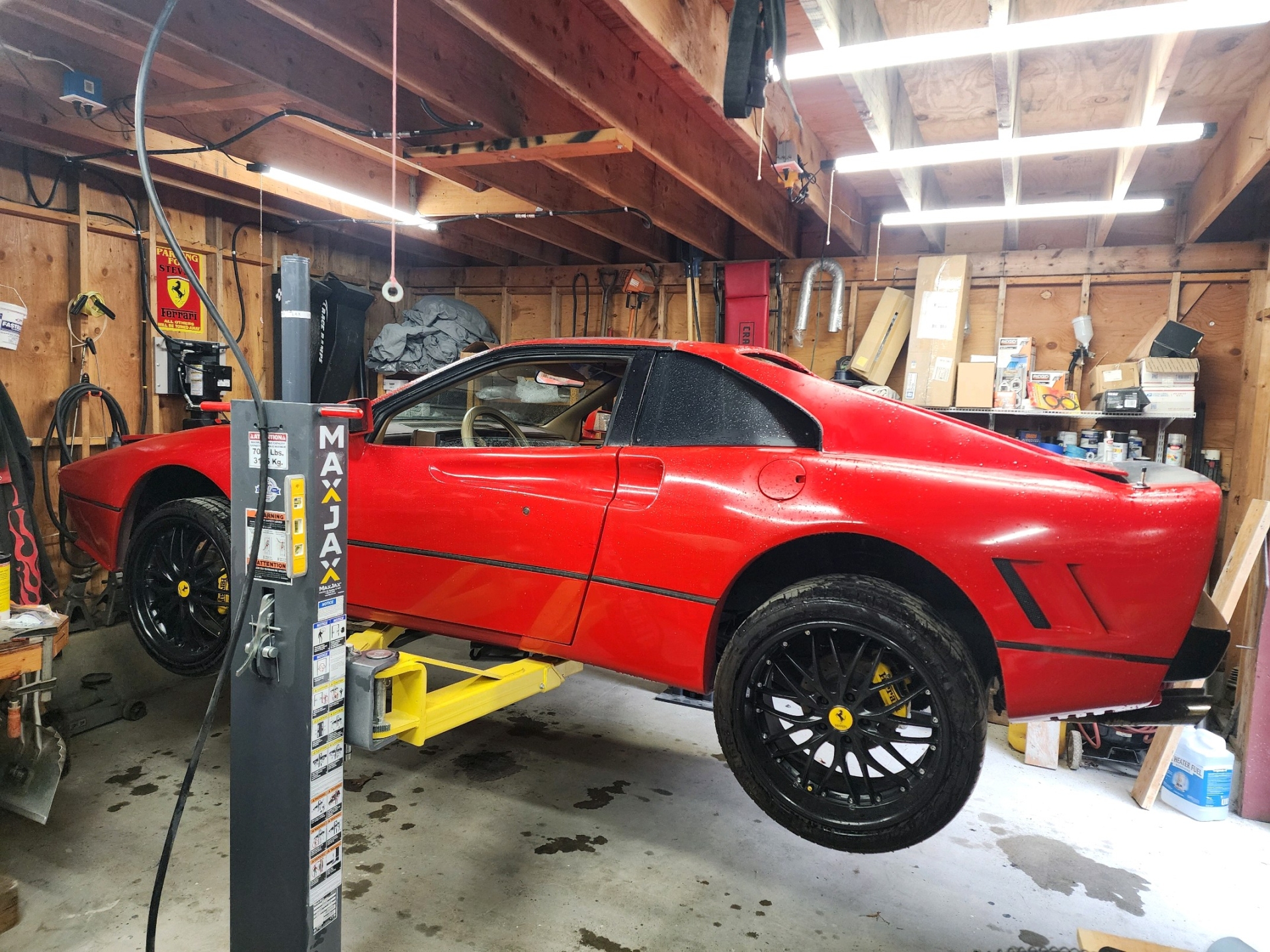

Found good tip on PFF to drain fuel tank. Attached hose to fuel line Schraeder valve and then added jumper across oil pressure sensor connection. It's an easy and safe way to drain the tank. Disconnected battery and will drain all oils and coolant next. Wheels coming off today.
New MAXJAX two post lift makes life a lot easier. My first V8 swap was in 1999 and I spent years using a creeper.

I have the same lift. It is definitely a game changer not having to use a cherry picker to lift a fiero up.

Maybe I'm over thinking it by imagining the car is still high in the air so I can get at the forward horizontal cradle bolts without using a creeper. Then I'd need a dolly with upper surface at least 2-3' off the ground!
Meanwhile, remove wheels, brakes, rear struts, cables, axles, etc.
Anyway, will keep posting progress.

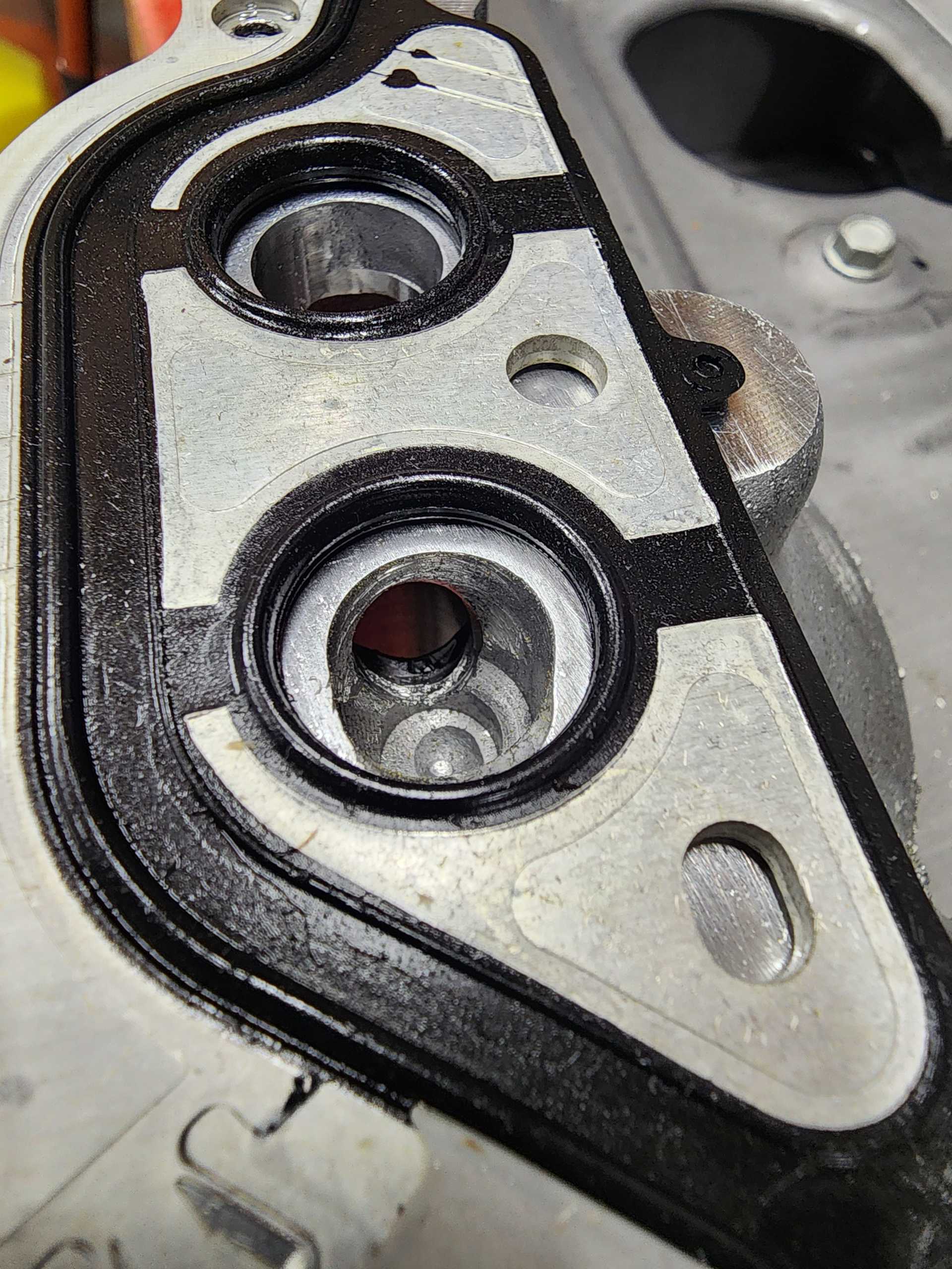

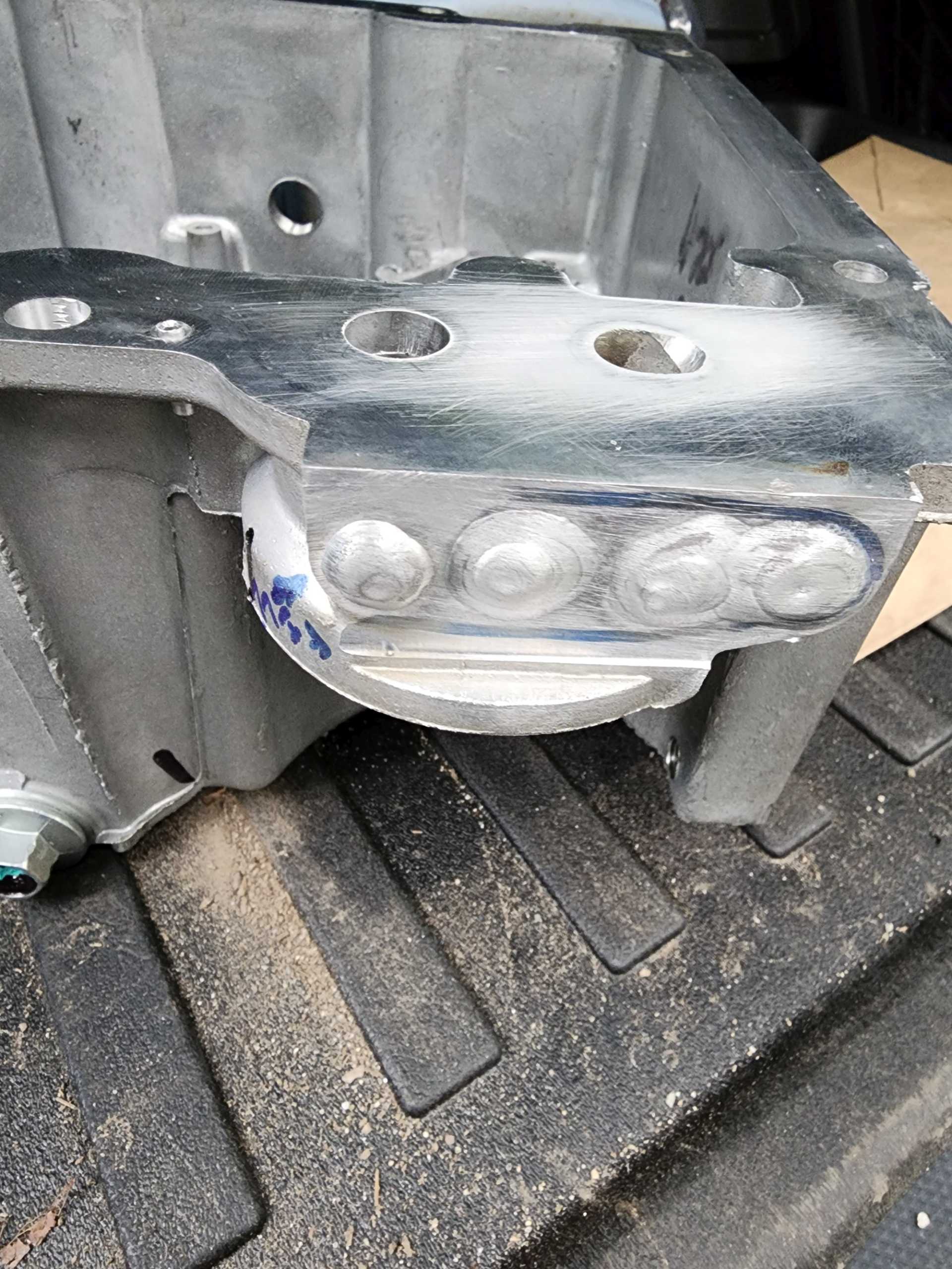

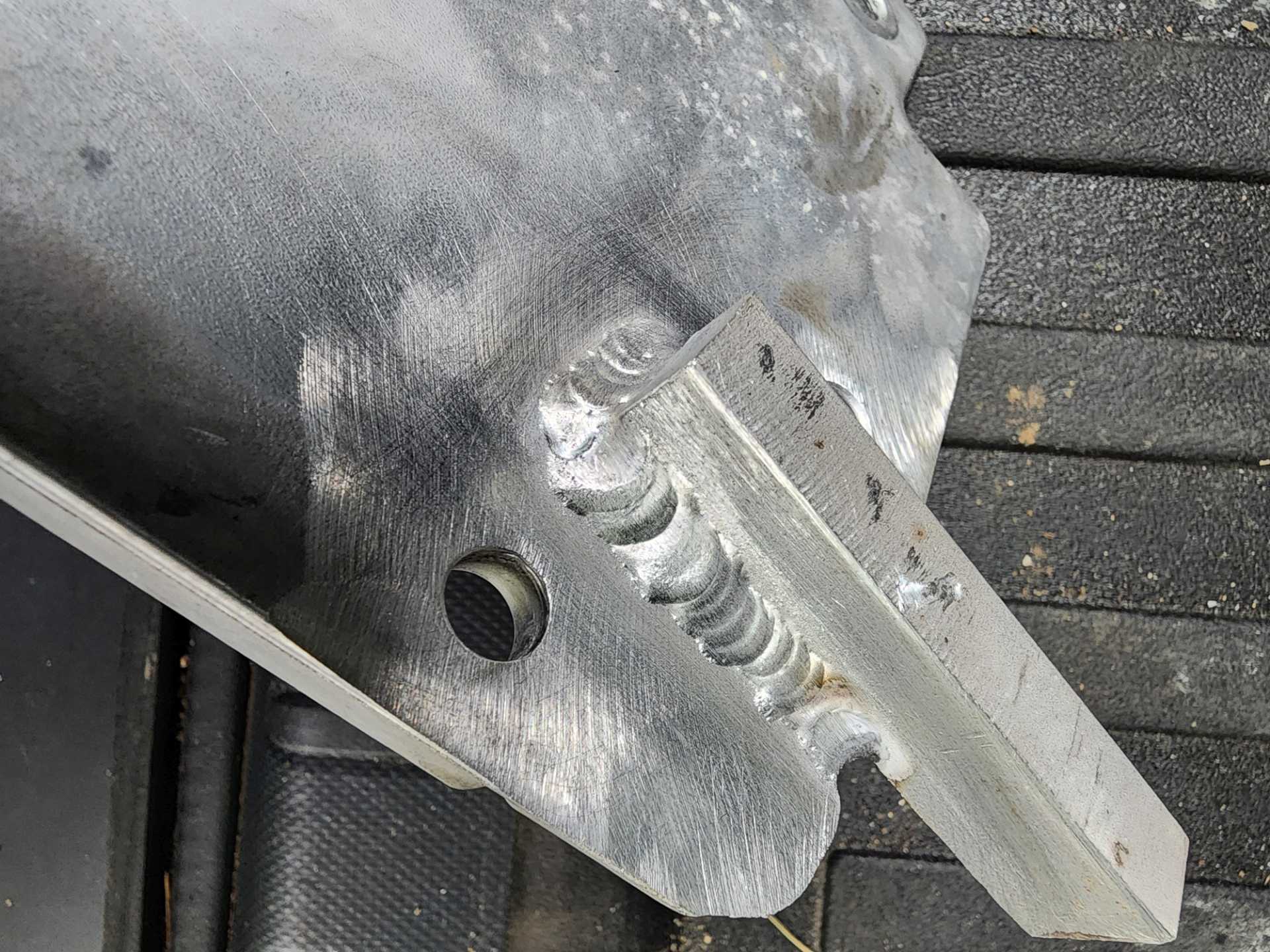

LS3 oil pan has been successfully modified to allow starter mounting. This involves rerouting the external oil bypass. Trial fit is next followed by welding shut the ports above the oil filter.

I'm ready to drop the engine and have one remaining question. The forward two cradle bolts turn easily inside their bores and the nuts are off.
In the past, before I had a lift, I would use a scissor jack, my cherry picker, etc. to lift or lower slightly enough to unload those two bolts and slide them out.
Does the Max Jax have that sensitivity? I'm thnking of using a scissor jack under the lift arm, one side at a time, to unload those two forward bolts.
Your thoughts?

I typically get the car situated on the MaxJax lift. Then I will lower it down to my engine dolly so it just touches. I then remove and lower rear cradle so it is sitting on the engine dolly. Because the dolly is a little low I still need to use a little jack to get the front cradle bolts out then just lower it down completely on the dolly. Once the cradle/motor is on the dolly just use the lift to get the car out of the way. If you built a dolly a little higher, I would think the use of an additional jack wouldn't be needed cause you can take the pressure of the bolts using the lift.
It all depends on what you are putting the cradle/motor on. The lift can do what you want only if you can get under the vehicle to remove the bolts. Thats why I need to use another jack because I need to raise the car more with the lift and use the jack to take the pressure off.

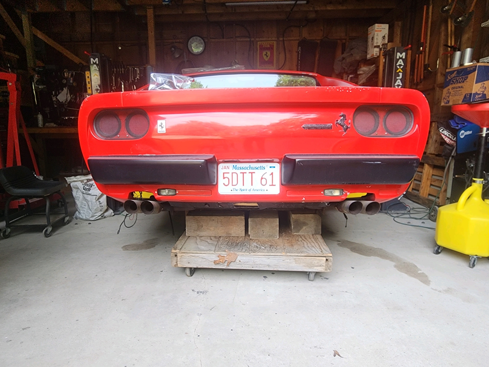

Meanwhile I tried out a small scissor jack while having an 18 mm box wrench on the bolt. It's the same as with the cherry picker where there is sweat spot for the bolt to turn easily and come out.
I plan to run a cargo strap across the roof and connect to the lift arms before removing the cradle......just to be safe.
Once the cradle is removed, I'll use two hoist jackstands I bought and shortened from Summit.
PS: The industrial dolly was free loaner from recycle center!

The LS3 mods are progressing.
Below are the oil pan mods to fit the starter and the valley cover mods to reverse the intake.

Report this Post08-30-2024 11:11 AM Click Here to See the Profile for V8SteveClick Here to visit V8Steve's HomePageSend a Private Message to V8SteveEdit/Delete MessageReply w/QuoteDirect Link to This Post
Progress!

Very nice. Out of curiosity, how far apart are the maxjax lifts from each other.
[This message has been edited by Spadesluck (edited 08-30-2024).]
V8Steve
Posts: 320
From: MA
Report this Post08-30-2024 11:40 AM Click Here to See the Profile for V8SteveClick Here to visit V8Steve's HomePageSend a Private Message to V8SteveEdit/Delete MessageReply w/QuoteDirect Link to This Post
Mine is 112" between faces of posts. Another PFF member used 9' 8" (116") and a FaceBook contact used less than my 112".
I can't find my notes but I recall roughly splitting the difference. I put them as close as possible because it's the only vehicle. I wanted enough room to open the door for my interior work but also wanted to have the greatest reach/span of the lift arms.

The cradle, new LS3, and new F40 have completed the final test fit. Remote water pump installation is done and we are almost ready to paint the engine bay while other parts go out for powder coat. A West Coast smooth firewall is also going out for powder coat.
Exciting news is that we've contracted with Amida for an entire new interior of black leather with red stitching to compliment Mr. Mike's seat covers.
When complete, this car will likely be sold. It's one of no more than 12 that were ever made, making it quite rare.
Other than two V8 Archie kits, new custom Amida dash, the entire rebody is untouched. It's on an 88 Formula chassis, clean CarFax, and came from Southern California.
