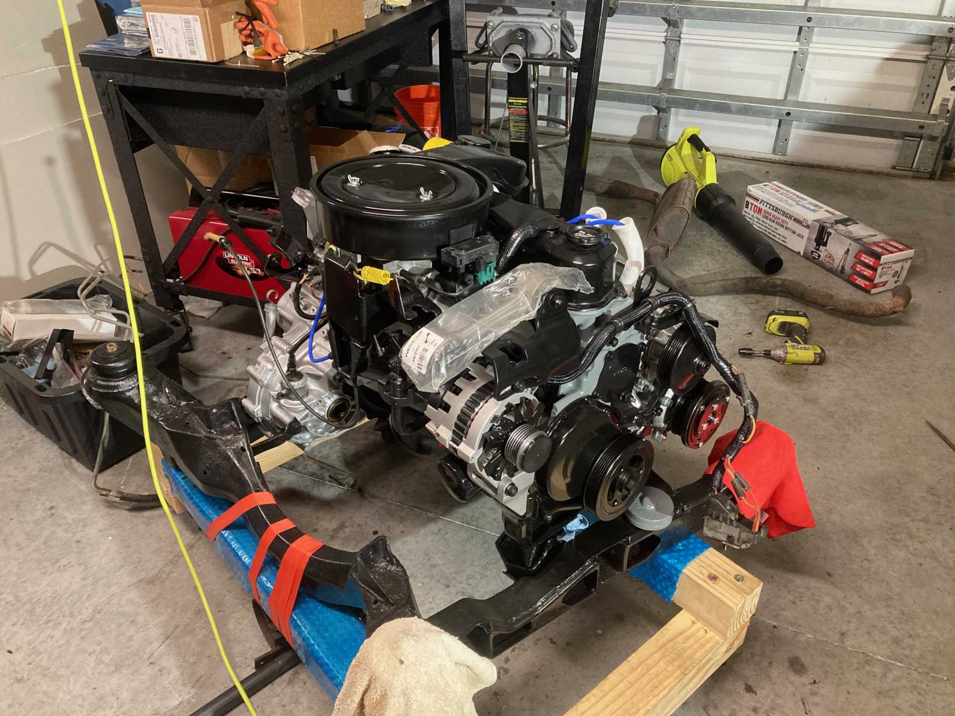

The 1984-1986 model year Fiero 2m4 used a V-belt pulley... which was the absolute worst design I think anyone has ever seen. It was dramatically improved in 1987 with the implementation of a serpentine belt system, which used a belt tensioner. Unfortunately, the engine block itself was modified to accept the belt tensioner in 1987, so you can't simply upgrade to this. My daughter and I are in the process of upgrading to a serpentine system (minus the tensioner), which should be no worse (slightly better with more contact patch) to the 84-86 V-belt system.
As you can see though, the biggest issue is a lack of contact patch on the crank pulley... but again... it's no worse than what was stock on the 84-86 Fiero.
It's common for them to squeal / slip... even the slightest bit of pulley misalignment can cause the belt to slip, and as someone above me said... you get coolant on those belts (and the pulleys, and it essentially puts an oily glaze on it.
My advice is to replace the belt entirely... but before you install the new belt... take some brake cleaner and spray down all of the pulleys... and THEN install the belt. There's a little slot in the bracket that the top of the alternator attaches to. This is meant for you to be able to put in a crow bar so that you can get leverage to tighten the belt enough before you tighten it.
If you do this... you shouldn't have any other issues.
