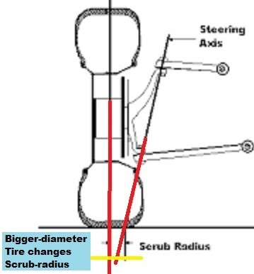

Especially with an 86, witch is seriously compromised already, screwing with the scrub radius will absolutely alter your suspension "geometry". Tire diameter and wheel offset determine scrub radius. The Chevette had pretty tiny tires. The reason that stock size tires and wheels look too small on an earlier Fiero, is because the geometry of the Chevette called call for a fairly small tire. The designers didn't want to make it worse than it already was.
The correct front tire diameter to keep scrub radius within design is about 24 1/12". Giant tires on a car designed for small ones just doesn't work. What wheels are you using with those monsters? What is the offset? What is the aspect ratio of the tires?
Bigger diameter front tires reduce scrub radius, which to me seems like a good modification for the 84-87 Fiero.
How do you know that? Do we know what it is with stock size tires and wheels? I haven't seen an actual published number.
Bigger diameter than what? For an 88 Fiero front end, the stock tire size is 24.7" diameter with a wheel offset of 37mm.
Scrub radius is wicked hard to measure accurately in real life. Really easy with a 2D drawing of the suspension geometry.
One thought I had was to sprinkle some chalk chips a smooth surface and roll a front tire onto it. Turn the steering wheel. Zero scrub radius would create circles with a distinct dot in the center of the contact patch. A 3D Cad Model would be really nice. Does anyone out there have a scanner and CAD capabilities?

Here is a diagram to show how a bigger-diameter tire will change the scrub-radius...I have wheels that are 38 mm offset (8 mm inset from stock) + 1" larger diameter front tires- almost no kick-back thru the steering wheel.
[This message has been edited by cvxjet (edited 07-05-2024).]

Thank you. Where did you find that drawing !?
I have the one of the rear but have never seen the front.
Clearly increased tire diameter over stock, will reduce scrub radius.
I understand also. thank you for sharing.
