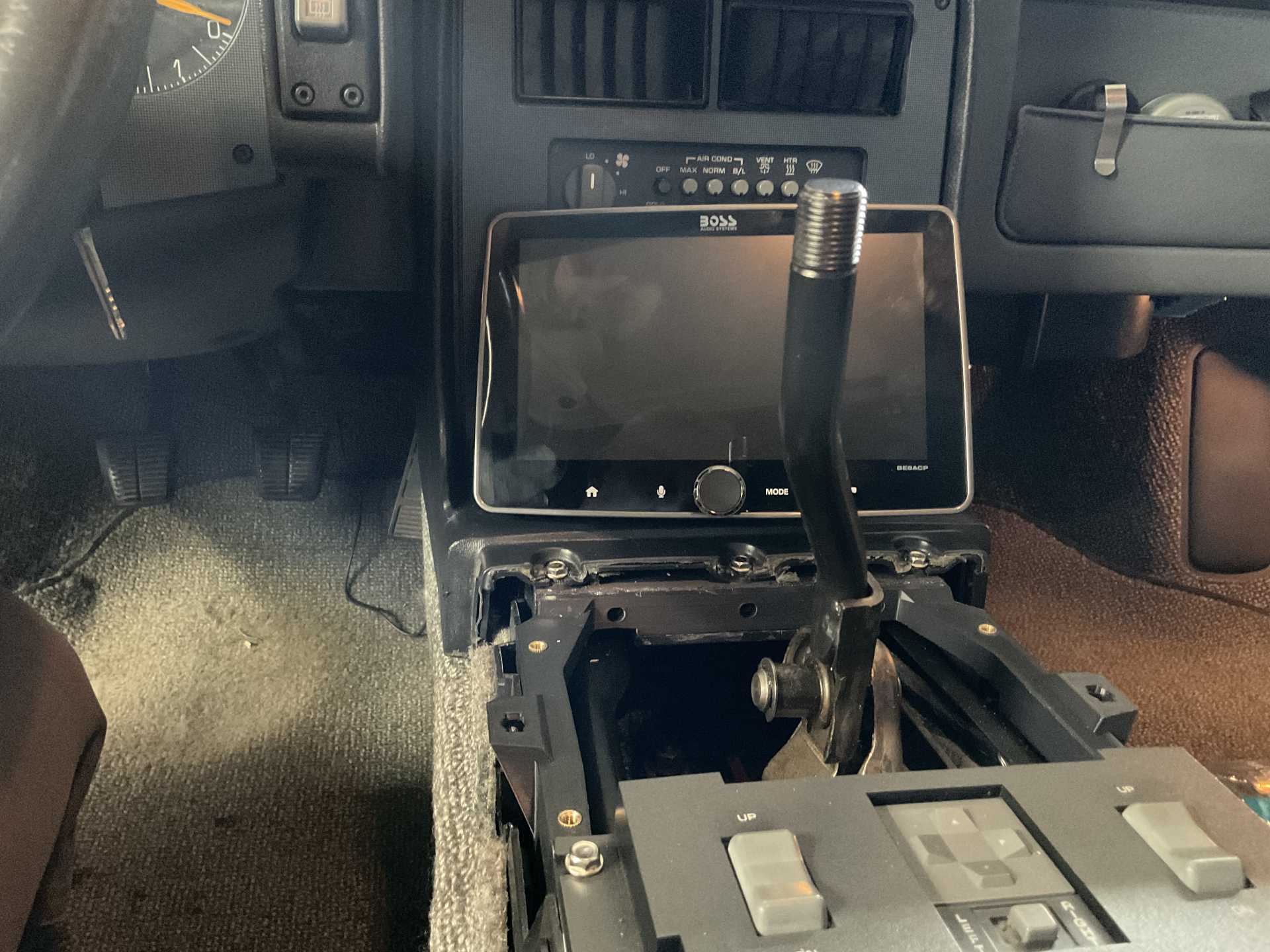

As for the shorter shifter, I realized it was going to make shifting harder, which made me think about the lack of float between the gears. With shorter shifter that might be really hard to manage. The reason for the shorter shifter is to lower its profile because I’m installing a touch screen stereo and wanted easier access/visibility.

As for still driving like an old car - well, that’s the fun!
Is that center console skeleton one of the printed aftermarket ones I've seen on eBay? I bought one of those (have the whole thing in a box somewhere). I haven't used it. How is it working for you? Has it been pretty rigid?

Got mine from the Fiero store, so don’t know how it will compare with yours. Seems pretty solid, but I just put it in. Had to get it in before the stereo because the console skeleton was beyond repair. The nice thing about it is that it’s in sections so I can remove just the armrest section to install shifter cable.
