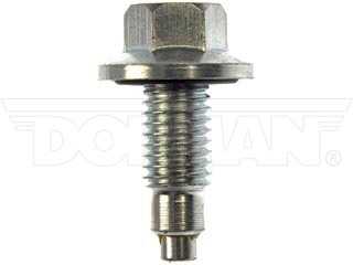

I looked up the part you listed, but the Dorman site said it doesn't fit the Fiero. Here's what Dorman's website came up with for the Fiero V6:
Dorman p/n 090-034CD
Oil Drain Plug Pilot Point M12-1.75, Head Size 15Mm

097-118CD is just 5 pc of the gasket in 090-034CD plug "kit."
if you go by model years it shows rubber over metal seal like https://www.dormanproducts.com/p-26830-65274.aspx (also in 10 or 25 packs)
that likely will work But not on many damage pans. I've tried that & other metal types & all leaked.
Even that should be replace every oil change because rubber seal often tears.
Also list rubber seals that must be replace every time.
Nylon seals iffy drains many times but strong enough not to fail between changes or fail when you install the plug.
Often Ignore what it fits as Dorman often doesn't know what parts fit.
To the point part site often say fit X model of whatever Year are wrong too.

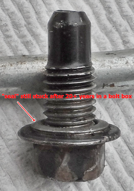

Found my OE Oil plug in a box w/ other old bolts... I kept it because many idiots to similar damage to oil drains...
But first people need to understand how the drain hole are made in most stamped pans...
The hole thru the pan you see is just that a simple hole.
Inside they spot welded a thicker metal stamped "nut" that will allow oil to go between the parts.
then outside you have some type of seal & the plug. (Not all use a "pilot" plug that make it easier to start the plug in after draining.)
When tight only the seal keeps oil in the pan.
If the seal is wrong or damage, often will leak & damage the pan too because morons think just need more Torque...
Seals Like this...
I think maybe was metal inner holding rubber outer but rubber torn off 30 years ago & never replace & morons smash the middle AND Pan metal to Cone Out a new shape & still leaked. Nearly rounded off the head to get that out.
They even tried RTV to seal @ some point as I cleaned it today to get a good pic & had a Booger stuck next to thread.
So 65274 metal/rubber gasket has the rubber in the damaged area & leaked. Other metal seals had similar problems.
I've tried Fiber "washers" too. Works but not as well as any Nylon.
This type of is also why Dorman & others make/made oversize plugs because fools way over torque the plug & strip the stamp nut. Once upon time I seen 2x even 3x oversize self-tapper plugs available to "fix" this & other types of oil pans. They still make various rubber plugs like dorman 090-932CD to replace plugs w/ strip holes but some don't last long.
Is only "luck" that the pan didn't strip out... look @ second pic where one section of thread look worse that all other... & don't mean just galling on three threads.

The 090-034CD seemed to fit correctly, and so far no leaks. Will test the car in run next. Otherwise, I'll stock up on the rubber washers, and change them with every oil change.
