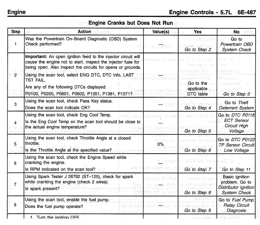

cyrus88
Posts: 411
Report this Post05-14-2024 01:59 PM Click Here to See the Profile for cyrus88Send a Private Message to cyrus88Edit/Delete MessageReply w/QuoteDirect Link to This Post
Originally posted by str8maxn:
but the engine does not turnover . . .
Need clarification here. Does the engine not turn at all? Or it turns over but does not start?
I assume you don't have a service manual for an LT-1 Camaro/Firebird. Do a google search and download a service manual for the year of the engine. Then follow the troubleshooting chart available in the manual.
Edited to add: See example from 96 Service manual:
[This message has been edited by cyrus88 (edited 05-14-2024).]
Cranks but doesn't turn over. Ran fine a month ago. I don't have a service manual.
Does have an ODB1 port but I don't have a tool to scan.
[This message has been edited by str8maxn (edited 05-14-2024).]
cyrus88
Posts: 411
Report this Post05-14-2024 02:34 PM Click Here to See the Profile for cyrus88Send a Private Message to cyrus88Edit/Delete MessageReply w/QuoteDirect Link to This Post
Get the service manual. It's invaluable.
Since it does not start, there are trouble codes present. The manual may tell you how to read the trouble codes without a scantool. Get a cheap code reader for OBD-I and save yourself the trouble of troubleshooting in the dark.

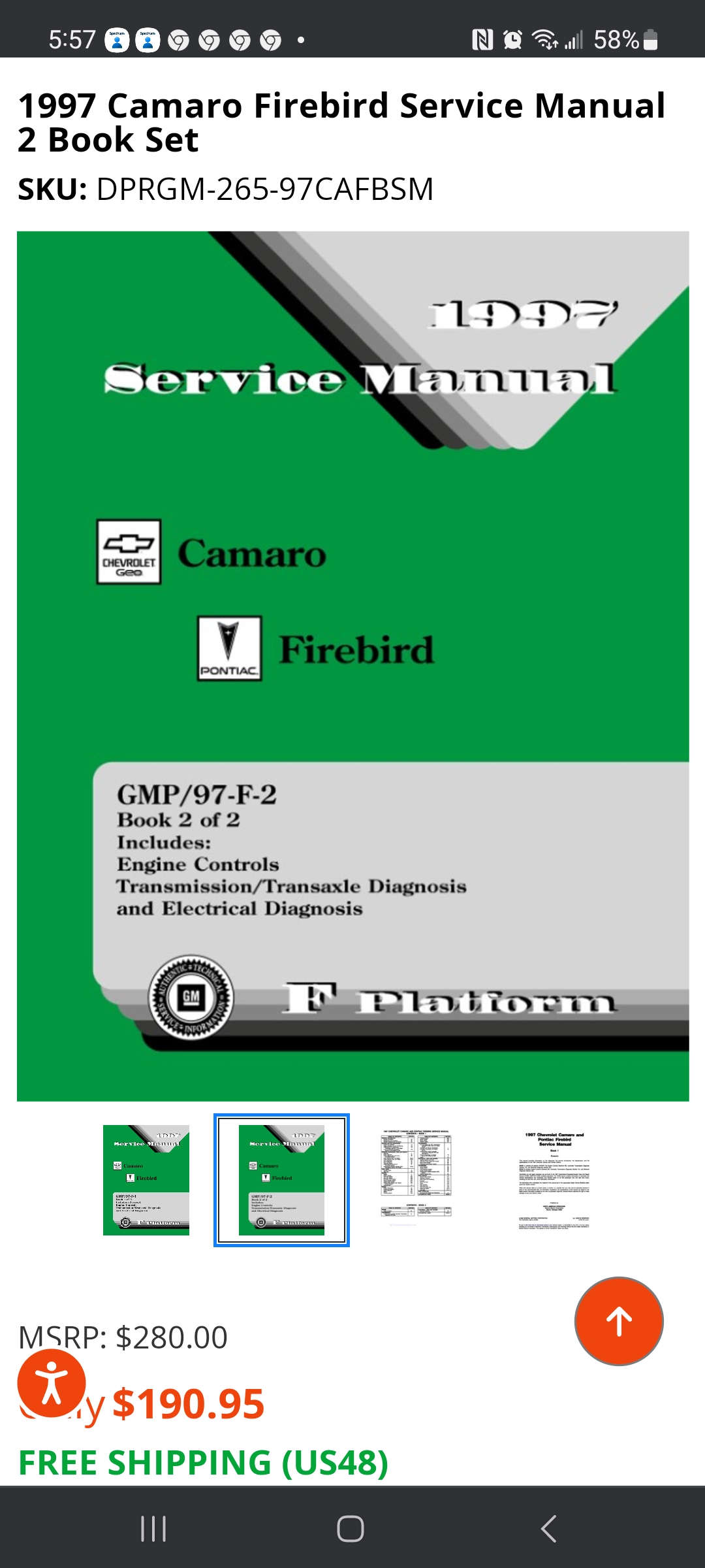

Jason88Notchie
Posts: 1821
From: Elyria, Ohio, USA
Registered: Oct 2009
Report this Post06-05-2024 06:22 PM Click Here to See the Profile for Jason88NotchieSend a Private Message to Jason88NotchieEdit/Delete MessageReply w/QuoteDirect Link to This Post
**** !! Typed an entire post and it got deleted before I could send. Anyway....
Get the FACTORY SERVICE MANUAL. There is an PDF version for 50 bucks. 200 bucks fir printed...YIKES! You'll have to search your year On the Motor Bookstore site. I just used 1997 as an example. In my experience Haynes and others are total crap for more advanced troubleshooting.
And yes. You will need a scanner. Unless you are an engine whisperer.

cyrus88
Posts: 411
Report this Post06-05-2024 07:13 PM Click Here to See the Profile for cyrus88Send a Private Message to cyrus88Edit/Delete MessageReply w/QuoteDirect Link to This Post
The 1997 factory service manual will be of no help to you because it's for OBD-II.
Search for the factory manual for the year of your engine.
Jason88Notchie
Posts: 1821
Report this Post06-05-2024 08:08 PM Click Here to See the Profile for Jason88NotchieSend a Private Message to Jason88NotchieEdit/Delete MessageReply w/QuoteDirect Link to This Post
Yes. In my post I said this is an example to get him a source for a manual. He'll have to search for his year. No idea what year of engine through this thread.

Without a scantool it is hard to know what is going on with the engine.
But let's try the easy stuff first.
First shot in the dark: perhaps you have a few leaky injectors and the engine is getting fuel flooded. So, hold the throttle wide open and crank it to see if it starts.
Second shot: You replaced some spark plug wires and got the firing order wrong and forgot that you had done it. Check the firing order.
Slightly more complicated stuff.
First shot: The rotor on the opti rotated and now it's firing in the wrong order. Time to remove and inspect it.
Second shot: Problem with one or more sensors (MAF sensor or Air intake and, or ECT temp sensors, cam position, etc).
If you don't want to go round and round chasing guesses, my suggestion would be to take it to a mechanic, or invest in the tools needed to work on it yourself.
Edit to add: this is assuming there is nothing mechanically wrong with engine (broken camshaft, etc.).

Thank you cyrus88,
I will test as time is available.
