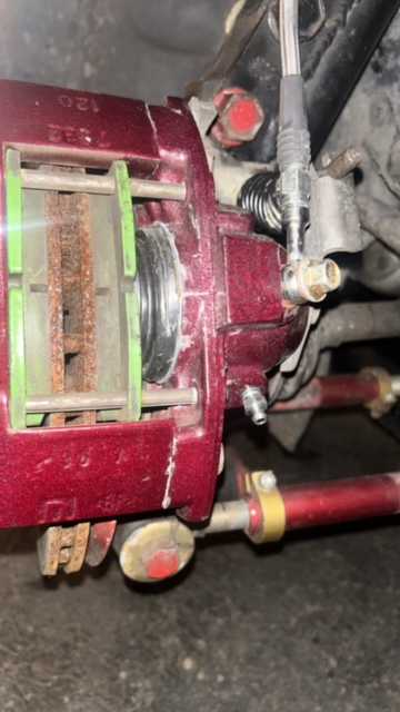

Report this Post12-29-2023 11:59 PM Click Here to See the Profile for fliphoneSend a Private Message to fliphoneEdit/Delete MessageReply w/QuoteDirect Link to This Post

Well I found the problem

Report this Post12-30-2023 01:21 PM Click Here to See the Profile for fieroguruSend a Private Message to fieroguruEdit/Delete MessageReply w/QuoteDirect Link to This Post
Yeah, calipers full of air won't give you any brakes either...
It's difficult to make out in that low-res image what's going on... but is the brake hose banjo bolt loose? If so, why isn't there brake fluid all over the place?

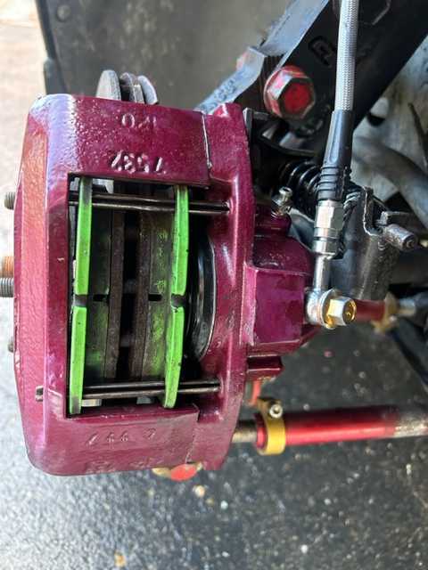

Report this Post12-30-2023 05:52 PM Click Here to See the Profile for fliphoneSend a Private Message to fliphoneEdit/Delete MessageReply w/QuoteDirect Link to This Post
The bleeder is on the bottom of the caliper, essentially draining whatever fluid is ending up in the caliper. So i could try and bleed the rear of the car but it would always just be full of air. That being said I just re-rebuilt the calipers the right way and am waiting on a buddy to get here for bleeding.
Before:
After:

Report this Post12-30-2023 07:19 PM Click Here to See the Profile for PatrickSend a Private Message to PatrickEdit/Delete MessageReply w/QuoteDirect Link to This Post
The bleeder is on the bottom of the caliper...
Ah... I was paying no attention to the apparent location of the bleeder, as images are often orientated every which way when posted.

Report this Post12-31-2023 08:07 AM Click Here to See the Profile for Vintage-NutSend a Private Message to Vintage-NutEdit/Delete MessageReply w/QuoteDirect Link to This Post
fliphone:
If I understood correctly; Passenger Rear Caliper on the Driver Rear Rotor or 'backwards/opposite calipers'?

Report this Post12-31-2023 07:05 PM Click Here to See the Profile for fliphoneSend a Private Message to fliphoneEdit/Delete MessageReply w/QuoteDirect Link to This Post
I built the Passenger side housing with the driver side internals and parking brakes pieces and vise versa, so the only thing that didn't work was bleeding the brakes as the bleed port was on the bottem of the caliper

Report this Post12-31-2023 08:45 PM Click Here to See the Profile for pmbrunelleSend a Private Message to pmbrunelleEdit/Delete MessageReply w/QuoteDirect Link to This Post
Thanks for letting us know that this is possible.
In some brake swaps using 88 calipers on 84-87 cars, the calipers are swapped left-right to get the parking brake to pull in the correct direction.
By assembling the calipers as you did, those 84-87 cars can have their brake bleeders on top.

Report this Post12-31-2023 09:01 PM Click Here to See the Profile for PatrickSend a Private Message to PatrickEdit/Delete MessageReply w/QuoteDirect Link to This Post
So this blunder turned out to have some potential positive ramifications. Excellent!
