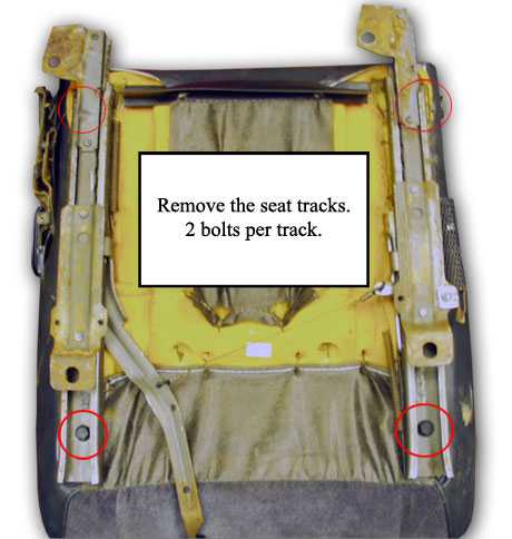

The seat Rails are attach to the floor.
The Rails are also attach to the seats w/ Bolts. This is where the spacers w/ long bolts will live.
As Ogre mentioned, the simple spacers and longer bolts go between the rails and the seats.
These can be used between the chassis and the rails, but doing it this way places the sheet metal bases of the rails 1" higher than the carpet and increases the changes of bumping into them.

I found an image of a Fiero seat and seat rails just for reference purposes.
In older threads covering this topic (hint, hint), it's mentioned to use a length of steel channel as a spacer on each side... which I think would be much more rigid and stable (than a small individual spacer at each bolt)... especially in event of a collision.
