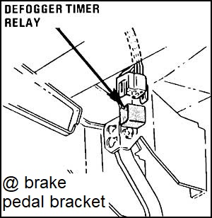

Maybe the switch is broke but Defog "relay" is likely bad.

If the Ignition is OFF and the Rear Defogger Indicator/Element are ON; I concur with Ogre that the solid-state timer relay contacts are welded together or 'sticking'.
BTW: Most people don't use the rear window defogger so you can simply remove the timer relay and be done OR replace it which is GM 10026005 for '84-'87.
The diagram below doesn't show the brake switches which are situated on top of the relay.
That is a true story.
I don't think anyone has ever needed it.
remove the relay and call it a day.
