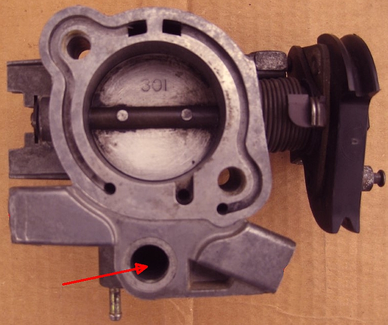

86 2.8, had a real high idle ~1500 RPM, figured it was the intake gaskets, replaced those since they're going on 38 years old.... and the idle is still high. Same spot. The throttle body gasket was replaced when the coolant lines were deleted about 3 years ago so that should still be fine. EGR and all it's related items have been deleted so there's a plate on the intake with a new gasket. The only vacuum lines left are to the MAP, regulator, and PCV; tested MAP and regulator lines by plugging them, no change. Haven't checked the PCV line yet, figure the only way to plug that would be taking the intake off again. Put in a new IAC and adjusted it by jumpering the pins on the ALDL. 1500 rpm idle and a hesitation on sudden throttle opening.
I blocked the hole in the TB and got the idle down to a solid 500-800rpm, then got my highly advanced vacuum leak locater apparatus (an old piece of large vac line) and poked around listening for suction noises and found it to be the loudest at the IAC. When feeling around on the back of the TB where the tube goes in, I can feel it sucking in my finger, so I have to assume that whatever seals that tube in has gone bad in some way. Would a leak from that tube cause such a high idle and if so, how do I repair that? Spraying carb cleaner around it doesn't seem to change the idle at all but it's the only place I hear or feel suction.

I believe there's a rubber O-ring in the TB that seals against the metal tube.
Can I replace that with a specific part or do I just have to try and find an O-ring that'll fit in? Or put a bunch of RTV on the tube and shove it in there LOL

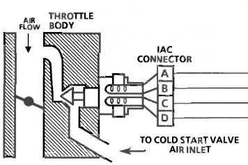

I'm not sure why you're going on about "plugs". The OP is talking about #5 in the diagram and the hole for it in the back of the TB.
Unless someone can advise otherwise, I'd take the tube to the hardware store and find an O-ring that fits the tube snugly... and hopefully you can insert it in the groove inside that TB hole. Make sure of course to remove whatever is in there now, if there's anything still there.

The labeling for #5 in the diagram I posted is incorrect. Air that the IAC valve allows to pass reaches the intake through that tube.

So basically IAC flow bypass the Throttle & upper intake completely? Very Interesting while thinking Arte Johnson's Wolfgang. (Laugh-in is on ShoutTV) FSM etc diagram(s) for the TB doesn't show same for IAC plumbing.

Finally found V6 IAC setup in Code 35 section in Fiero FSM. I now get the name w/ "cold start valve" etc but makes no sense to many because used all the time when the engine runs.
IAC air flow is intake, valve, out. The Motor is on out side & ECM barely or never see a leak thru the plug.
