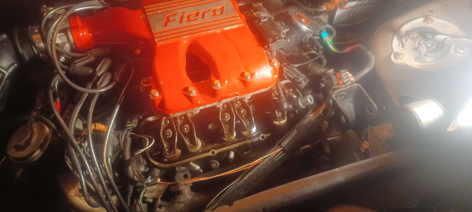

I've tried and tried and tried and I can't get this thing to run right anymore, a new icm makes it run so much better but the icm burns out or somehow fails within a few hours of it being installed and when it warms up it keeps idling up more and more til its sitting at 2500 rpm and the only reason its not higher is i turned the minimun air screw all the way out since it was at 4000 rpm and now for whatever reason the rad fans are stuck on. I just helped my friend fix it and there's like 1500 into a car that cost 5k, any help is appreciated

First and foremost, you're missing at least one valve cover. That's not good, you need the valve covers.
ICM - Any quality ICM should come with a packet of thermal grease, which needs to be applied to the metal surface on the bottom side of the ICM. You can always use a silver containing thermal paste for a computer processor for improved heat transfer. If you do not apply the thermal paste, the ICM will fail in short order.
Idle speeding up - If the idle goes up rapidly after starting, like if you were to push on the accelerator pedal; that would indicate a vacuum leak on the intake. Those intakes have several vacuum hoses and multiple gaskets where a leak could be present. Now if the idle increases slowly over a few minutes, that would point to a throttle position sensor that is questionable, and likely changing it's signal to the ECM as it warms up.
was doing valve lash since i did a headjob and that's the last picture I have of the car since I left it parked in a garage ignoring it for the sake of my mental health, I purchased the acdelco icm and the cheapo duralast one and so far the one the car came with (delphi) is the only one that works but the car runs like garbage and has no power.
and I figured it's probably the sensor but it doesn't matter if it's unplugged or not and is the only one the car will work with for whatever reason? I've tried 3 or 4 now and they just don't do anything at all, at least when I advance the arm on this one at idle the engine idles up a bit then falls on its face due to lack of fuel and air
