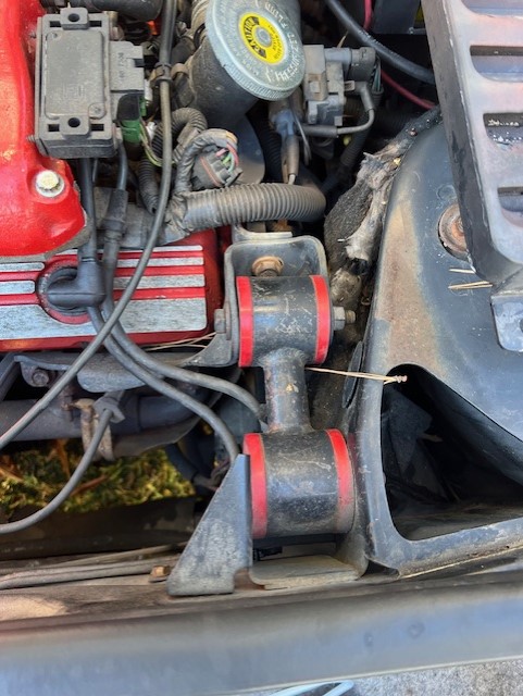

There are two things that are likely the culprit... the first is the engine "dog bone," which cam-a-lot mentioned. This is the best picture I could find, but the RUBBER bushings have been replaced with polyeurothane:
You can either replace this "dog bone" / engine strut with either an original rubber-bushing motor mount, or you can buy a replacement one from the Fiero Store with polyeurothane already pressed in: https://www.fierostore.com/.../Detail.aspx?s=52799

I think it already has the aftermarket Dog Bone, just not sure by whom it was made. They look like poly bushings in it..
I know whe has a new clutch, but I cannot speak to the age of the mounts. I am guessing they are like original, or maybe a replacement set.

Yeah, that's the aftermarket polyurethane one from the Fiero Store... and it looks like it's in good condition... so it's definitely not that.
